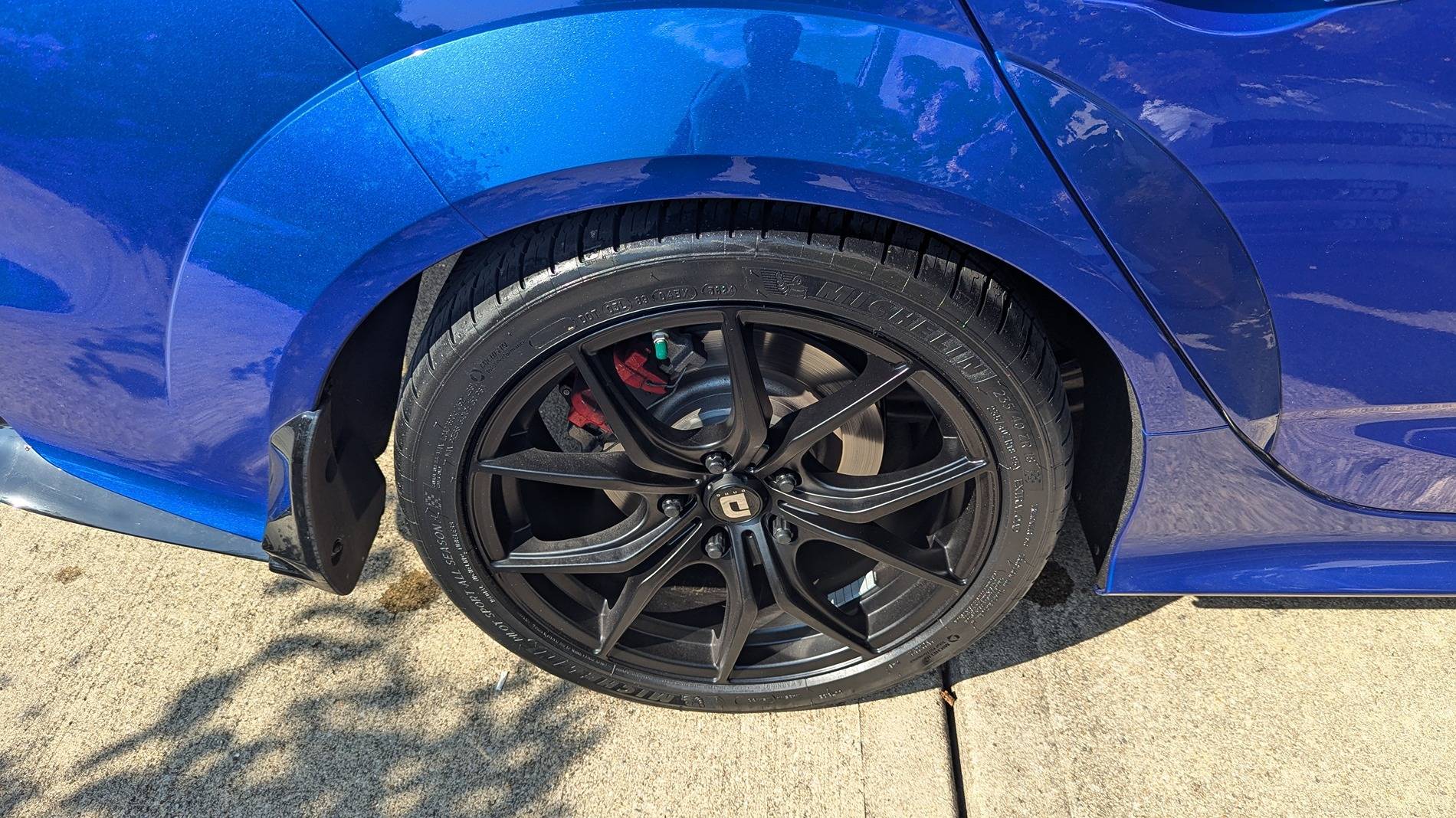

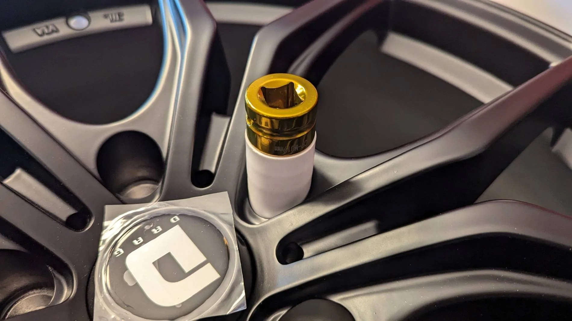

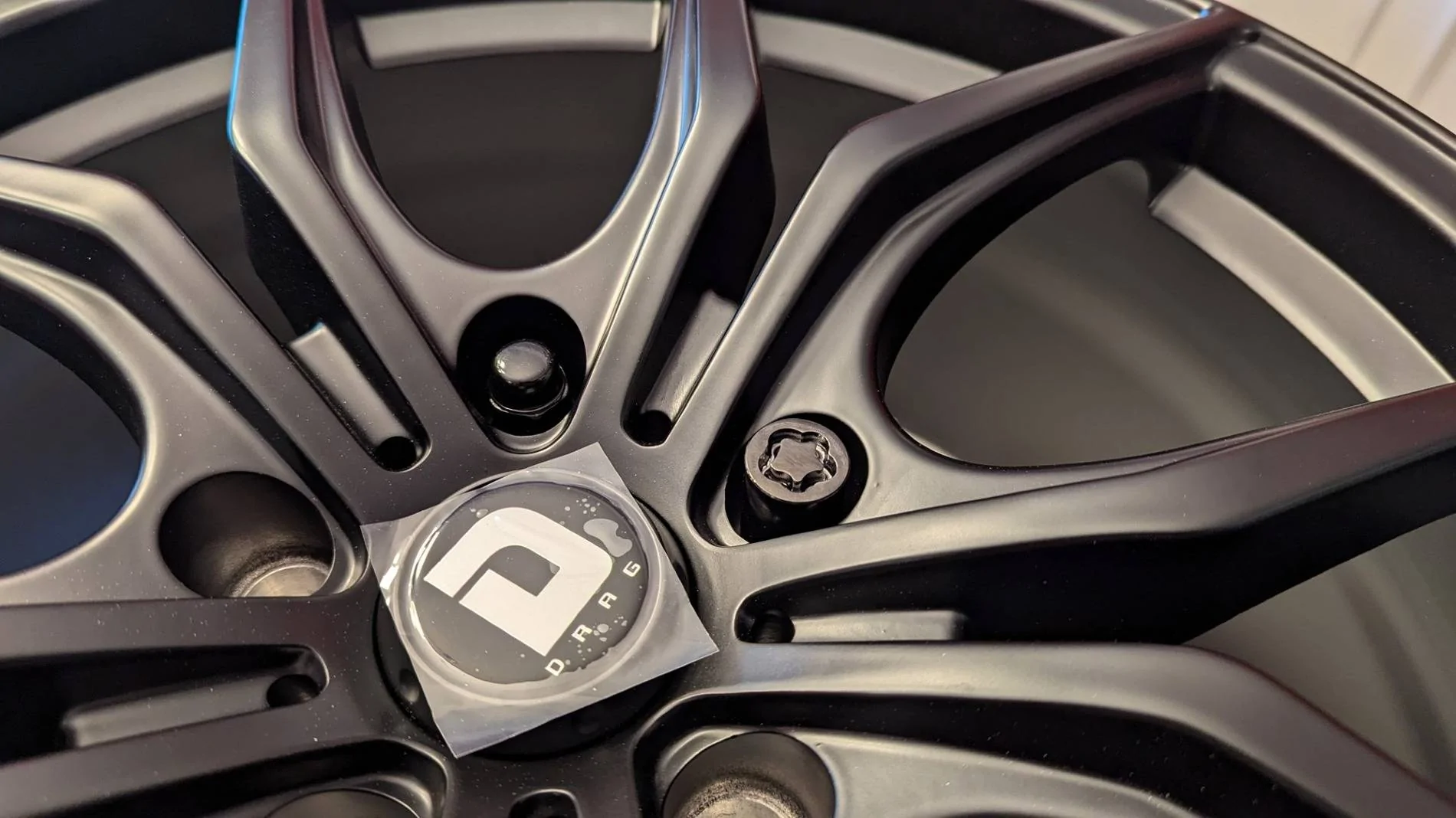

Update on lug nuts now that my wheels arrived...
The Drag DR-67 nug nut hole recesses are bored to about 25mm (will caliper the holes when I take the wheels to the tire shop). The 21 and 22 mm non-marring sockets will not fit, meaning I have to go with a 19mm or 3/4" hex nut as that is the largest non-marring socket I have that will fit in the recesses.
The APEX open end lug nuts will work, they are 19mm hex.
The Monolith lug nuts will definitely work for my wheels, they have a diameter of 23.5mm.
For the mean time I got a set of Gorilla K5TS-14150BGR, they are spline (not hex) lug nuts and have a thin profile with their special socket. The socket is 0.9", or just under 23mm in diameter. The other advantage is the lug nut key is driven with a 22mm or 7.8" hex socket, same as the factory 22mm lug nuts (one less socket in my trunk and life, though I now need to carry this socket key).
Here are photos of the new wheel with the McGard wheel lock nut, white lighting lug nut, and the other photo shows the 19mm non marring socket just fitting into the recess. As you can see the White Lightning are a touch bit too small, the McGard sets perfectly. I would like to see just a hair of the lug nut rounded end stick out from the recess, or they better look super awesome like the Monolith lug nuts.
Long term I will either get McGard lug nuts in black or the Monolith in Neo Chrome or black.

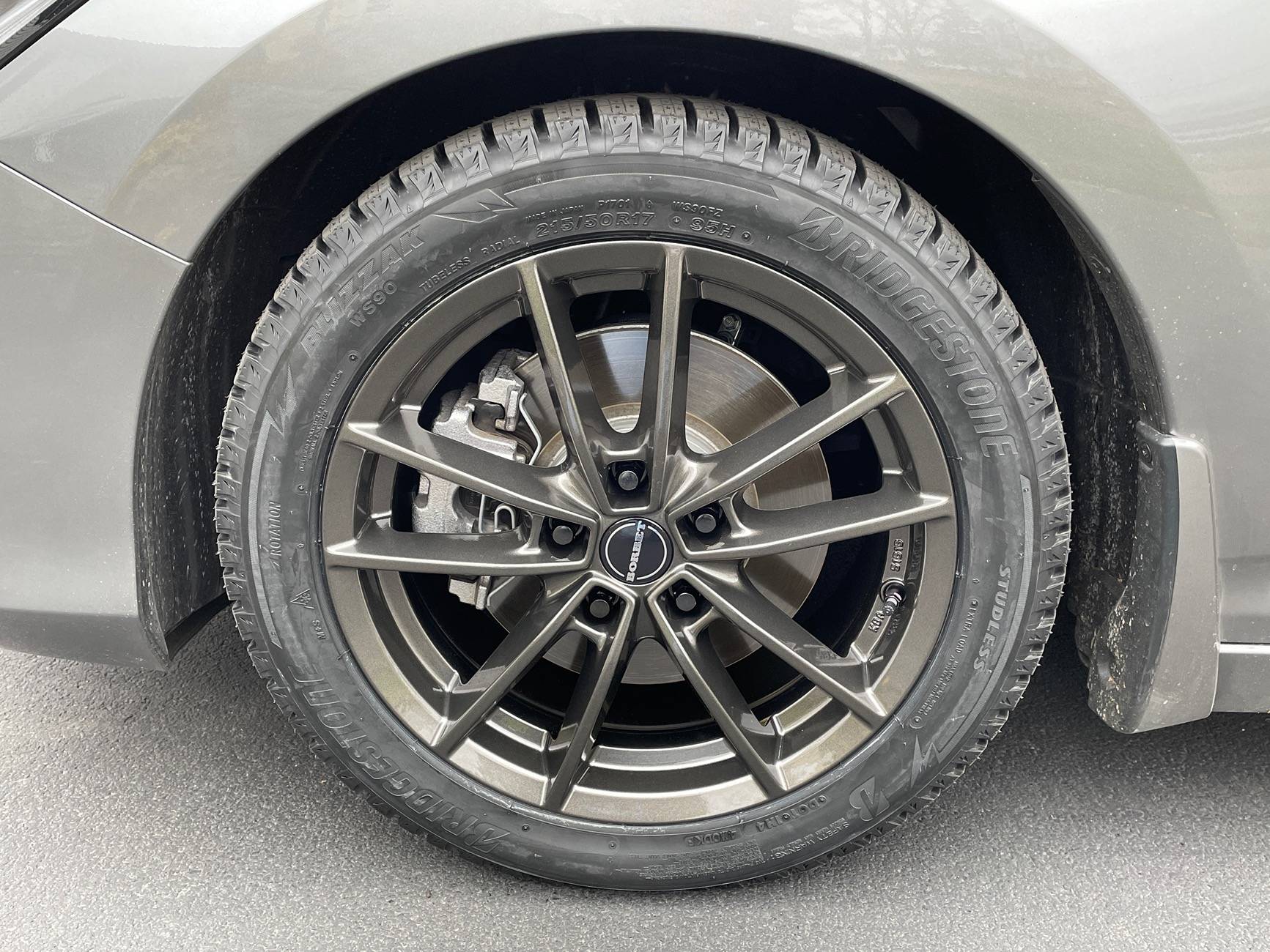

Well, not yet. They‘re for my winter set, so it’ll be a few months.
I definitely do not want chrome lug nuts, will look way out of place. I am going to get some black open end lug nuts for now and then swap them to closed end McGard or Gorilla lug nuts if I do not find something in a shorter length.
Finally got the winter wheels on with the McGard lug nuts. They’re 3/4” like the OEM lug nuts and the good news is that the Acura supplied lug wrench fits in the holes so I don’t have to remember to carry an adapter.
Acura Integra What Lug Nuts for aftermarket wheels (conical seat) +  Aftermarket TPMS sensors IMG_2504
