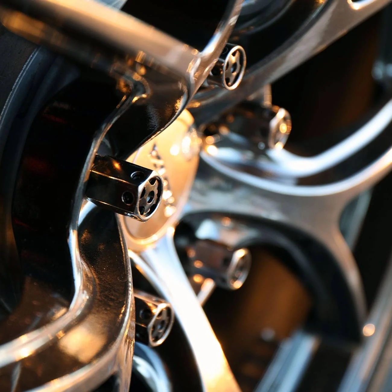

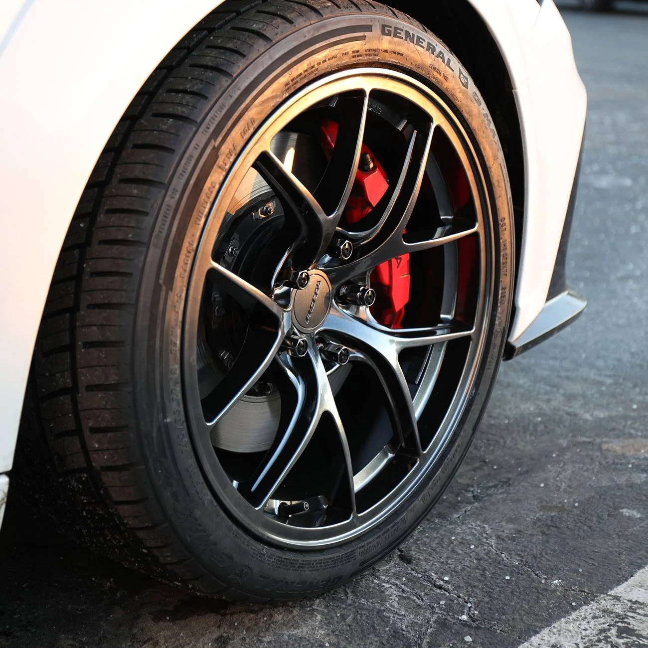

I used Kics R40 iConix Classical.
Acura Integra What Lug Nuts for aftermarket wheels (conical seat) +  Aftermarket TPMS sensors Kics R40 iConix M14 on Rota KB-R closeu
They're pretty expensive, but they fit and I didn't like most of the acorn-style options.
