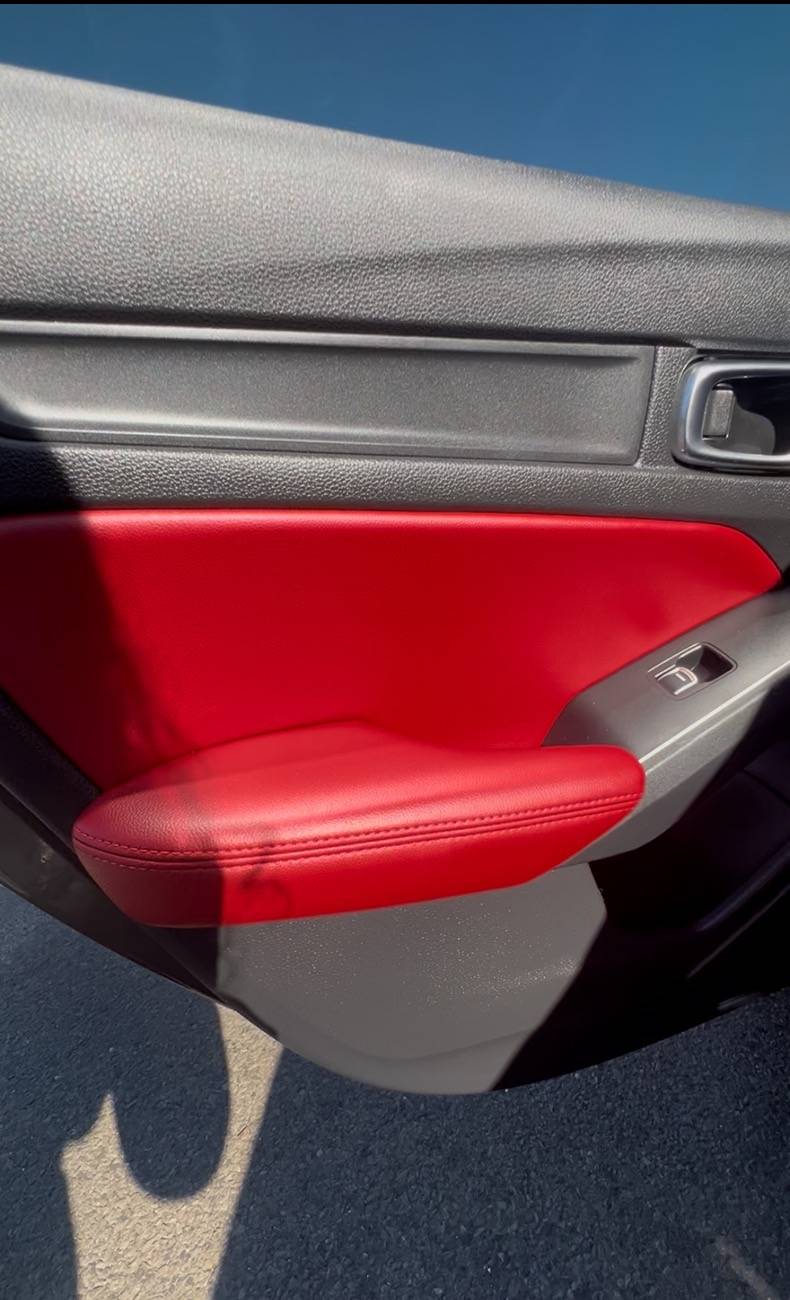

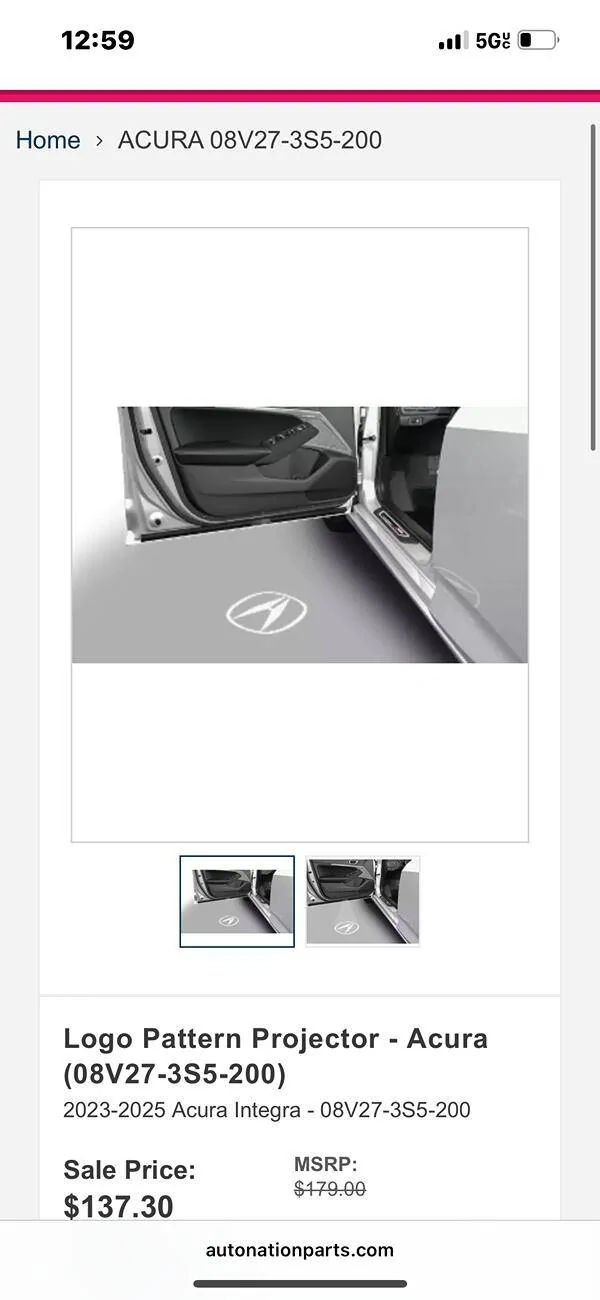

I just got a Integra 2023 a spec yesterday and I want to put projector door lights with the Acura logo, but I don’t see any lights on the doors to actually install a light. Did anyone manage to put install the projector lights?

I haven't done it but it looks pretty straightforward. Here's the official instructions for it. It'll require taking off the inner door trim and drilling a hole for the lights. I've taken the door trim off before and remember seeing an unused connector for the projectors.
Here's the link: https://www.integraforums.com/forum/attachments/bii19600-25-pdf.223728/

I've installed them. This car didn't come with any factory puddle light, so installing a projector is basically drilling into it like the instructions from above say. Thankfully it's also marked inside the plastic on the door, so you can't miss it.
The factory projectors are not super bright and crisp. The outside of the logo is a bit warm and bleeds. Otherwise they're okay. Nice to have a puddle light at all!

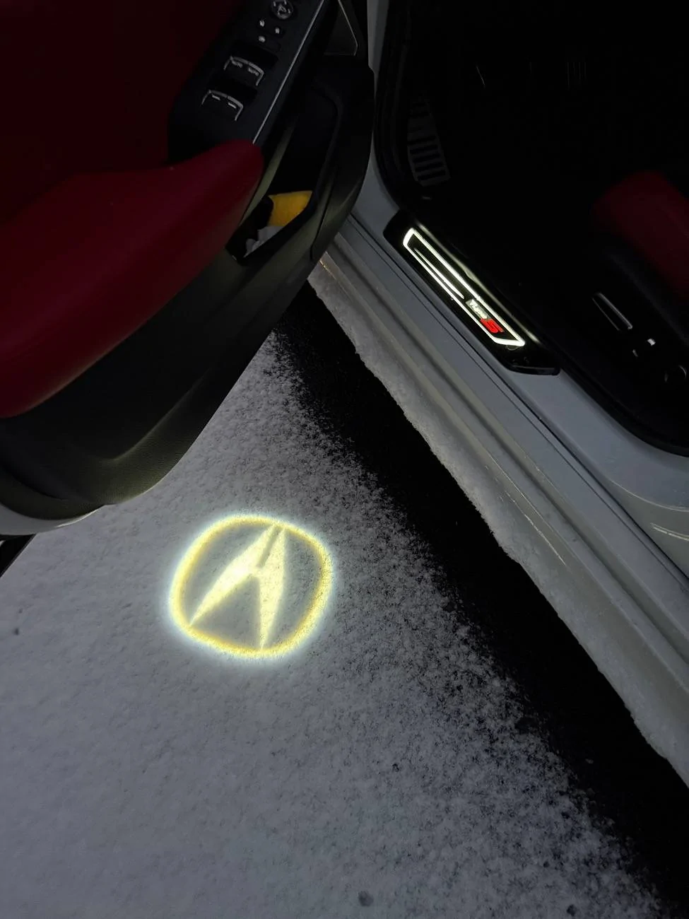

I did the install. Was pretty easy, just took my time.
