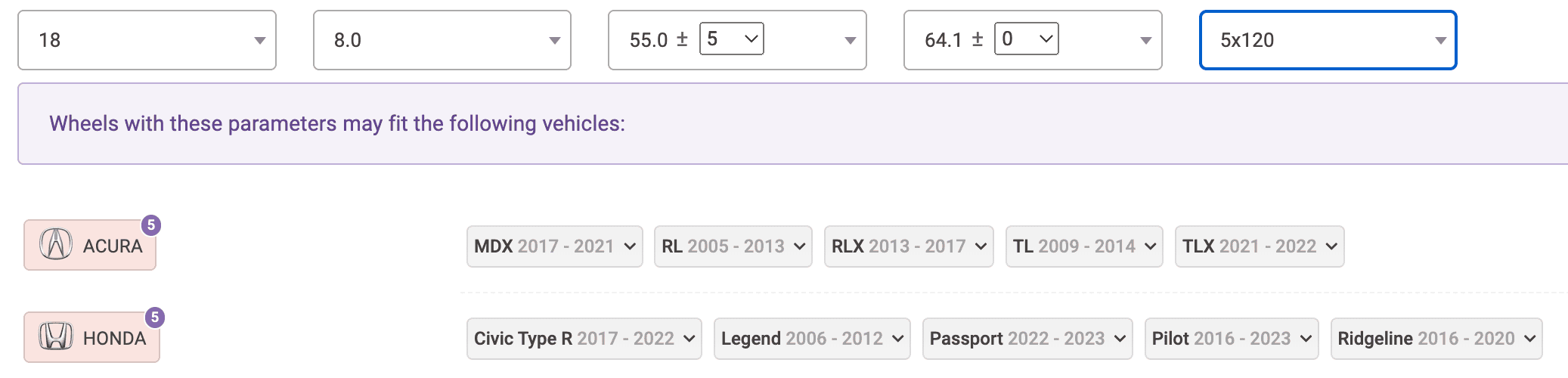

The older RL (2005 - 2015) HAD THE SAME CIRCLE AND BORE SIZE.....OFFSET UNKNOWN.

Looks like the 8x18s were ET55 and the 8.5x19s were ET50. Now the looks are a different story, but the offset almost spot on. Good find!
https://www.wheel-size.com/size/acura/rl/2013/
Looking further into this site, here are all available options in 18x8 with at least 50 offset:
