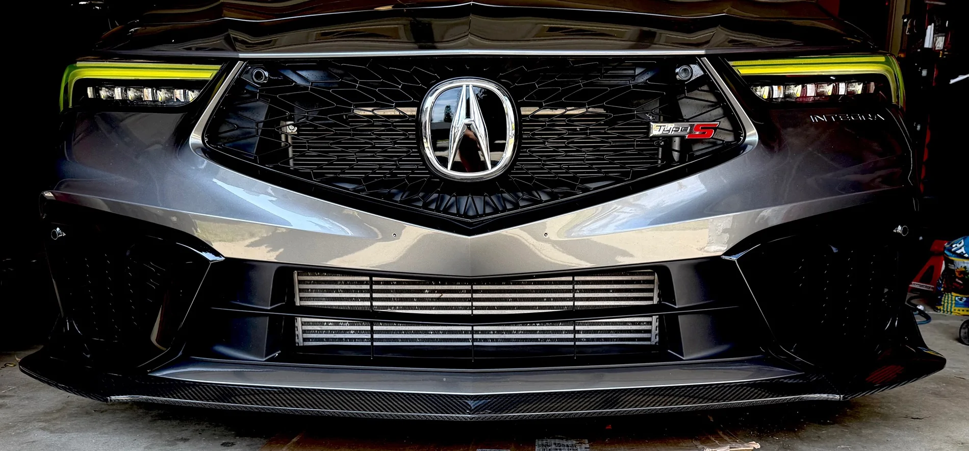

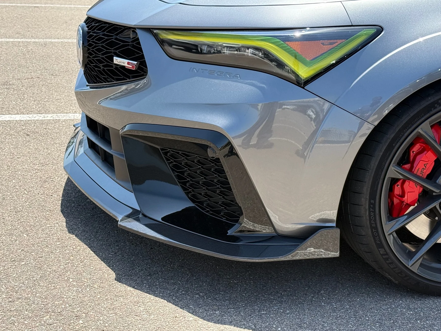

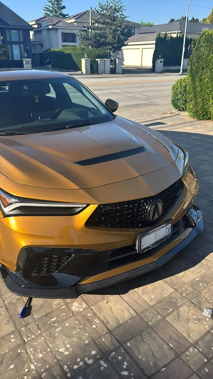

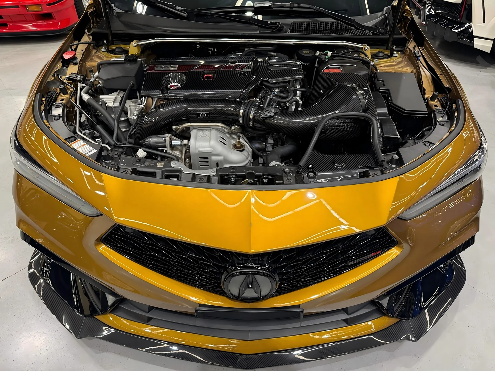

I’ve had my 25 type s over a year, time for some mods. I was really impressed my the Jogon front lip, the quality is a step above the EOS spoiler but happy with both.

Damn I have to give that Jogon lip another look… how was the install?

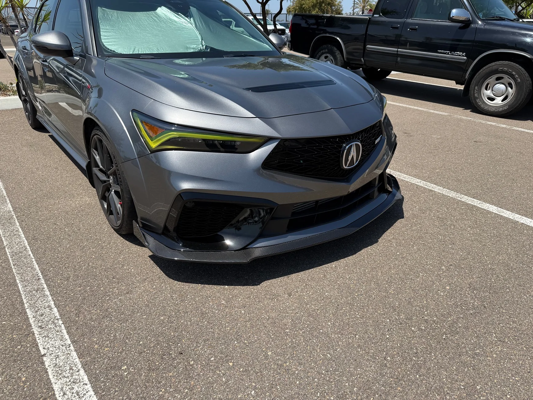

Super easy, removed all 12 of the clips underneath. I had to drill out the hole on the outer pieces because they were just to tight. Made sure all the mating surfaces were clean, use a heat gun to warm up the mounting tape. After I mounted it I used a car jack with a piece of 2x4 to put some pressure on the lip to make sure adhered correctly. I really liked you don’t have to drill anything into the bottom. The hardest part was peeling back the tape once I have to clips in, it would probably be easier with two people. Thinking of getting the side skirts from jogon too. I’ll post it if I do.

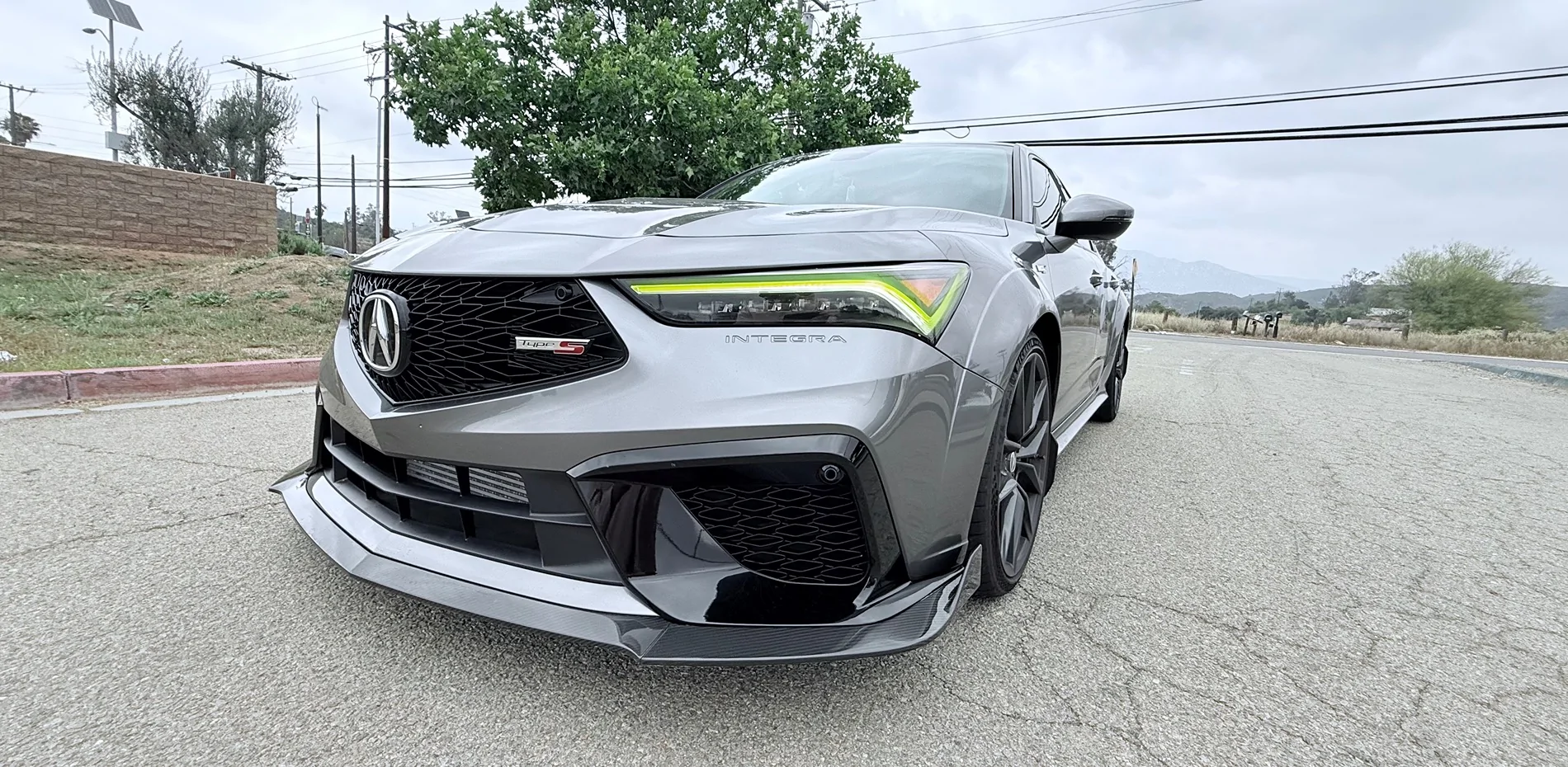

Which iteration of the lip is that? Can I ask for a pic from a bit further back?

looks really good. Their website has version 1 and version 2. Which is this? The website is a bit confusing for the lip.

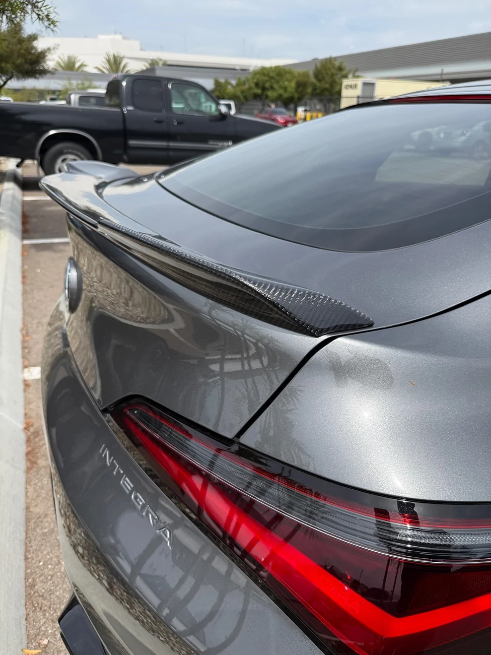

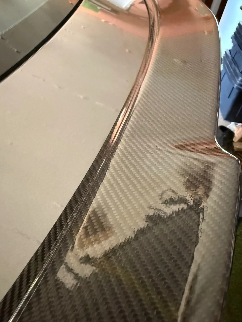

Update on the extreme online rear spoiler, it’s been a few months since the install. The finish wasn’t the greatest when I bought it, but it’s developed a texture from the weave. Compared to the Jogon front lip the finish is night and day, the Jogon part has a mirror finish. I’m gonna color sand it and spray a 2K clear over it, which I probably should’ve done from the get-go. Hopefully it it comes better than it looks now. Of course it is 90 days past the date purchase, so I can’t warranty it.
