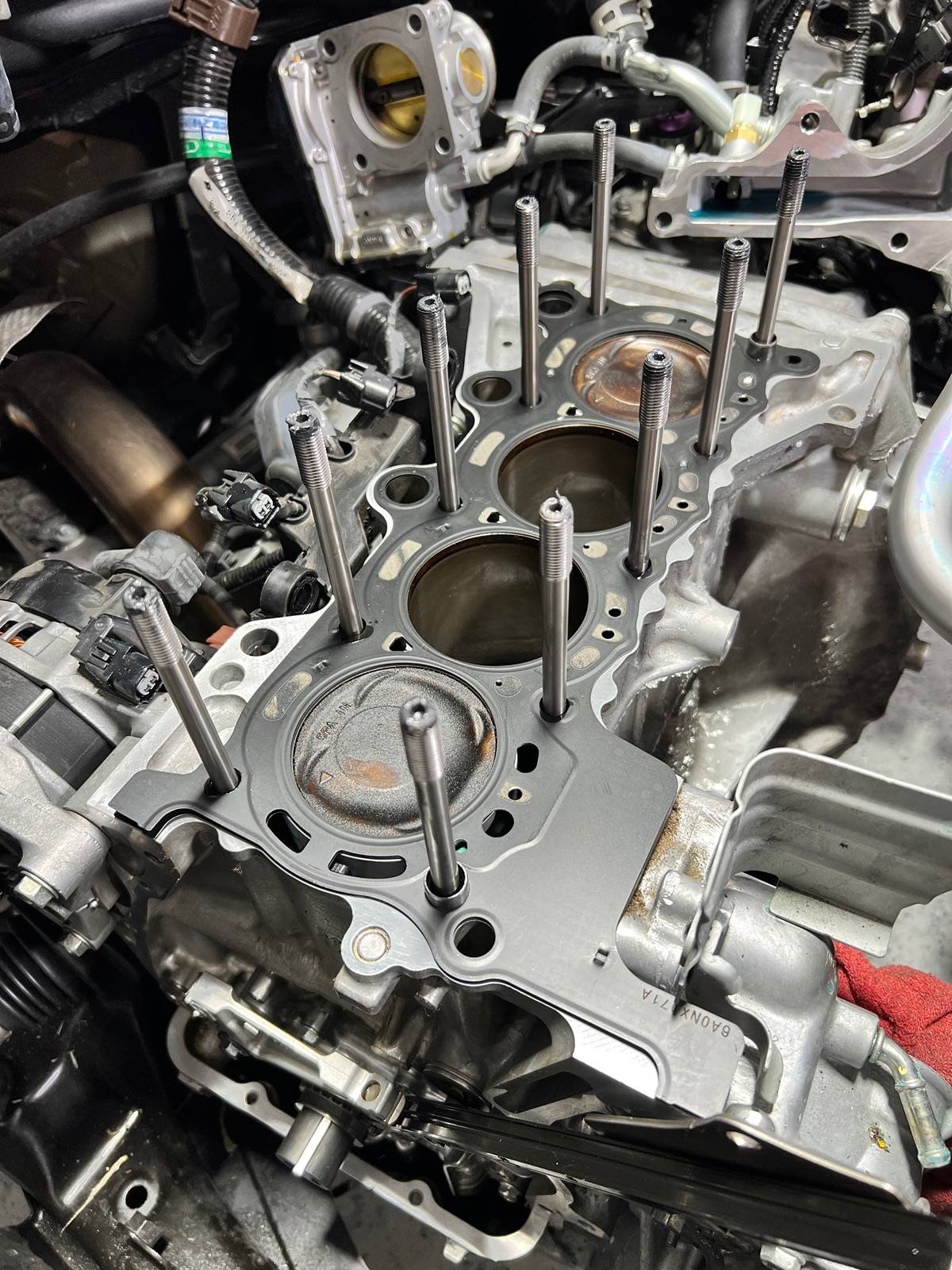

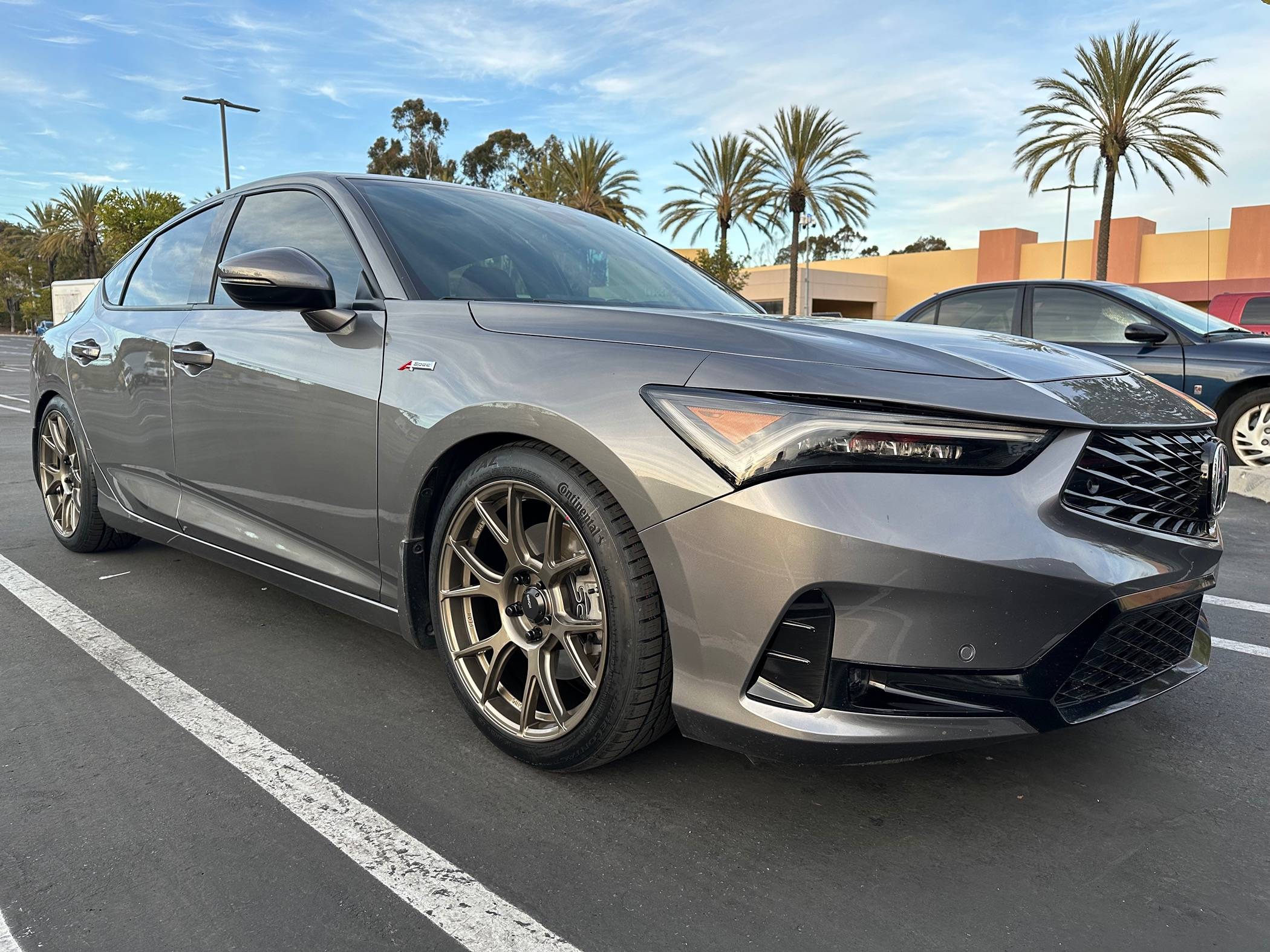

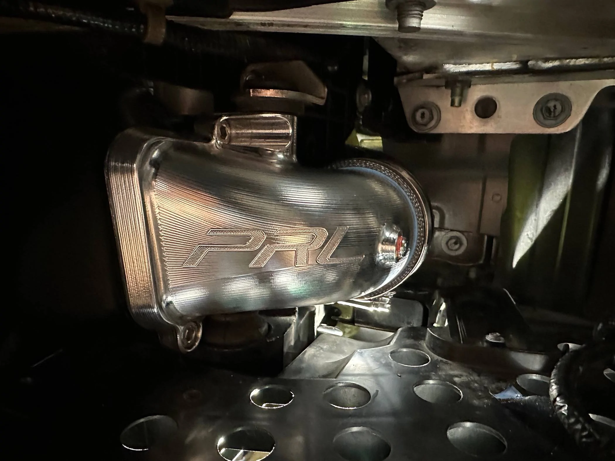

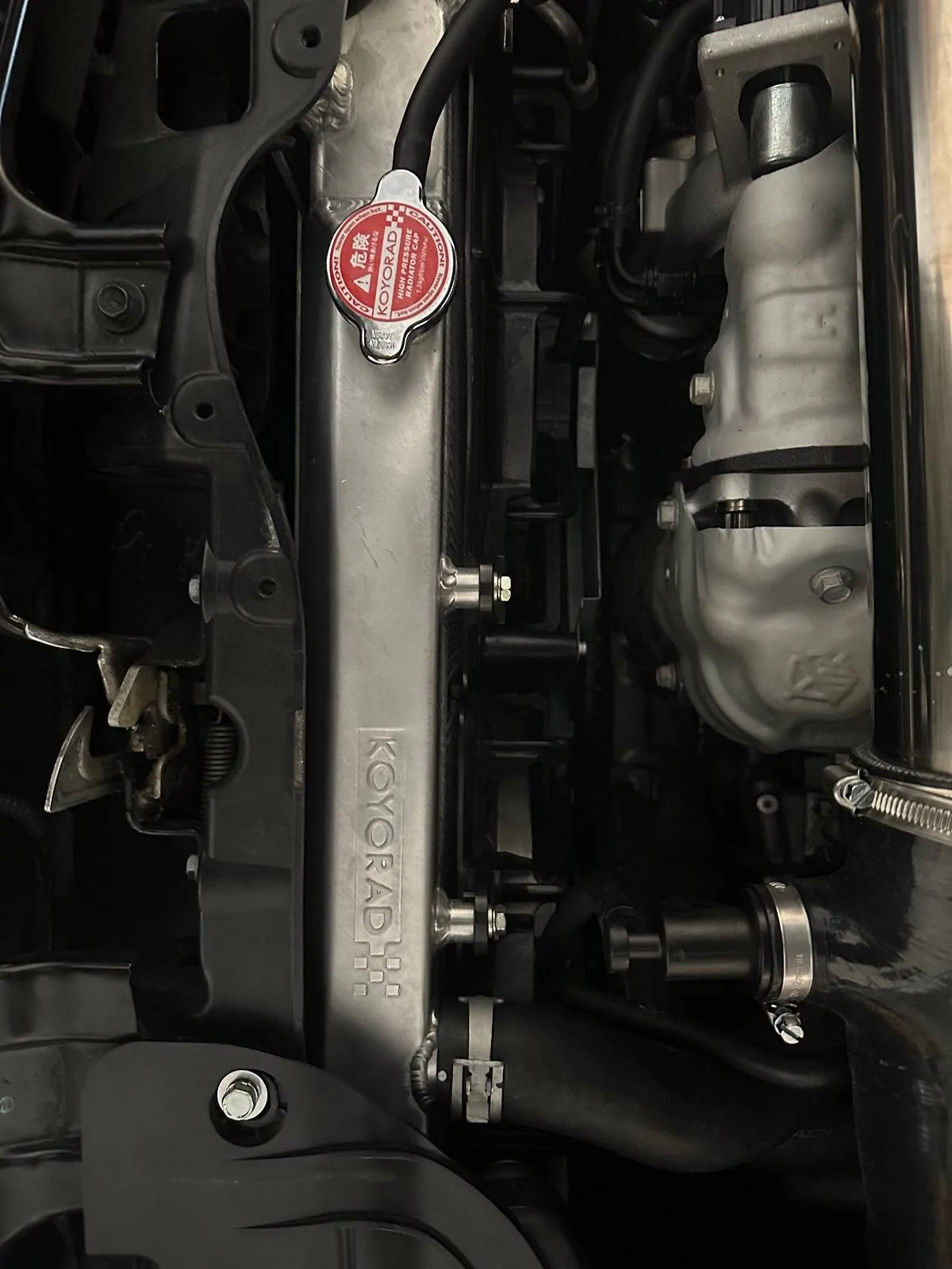

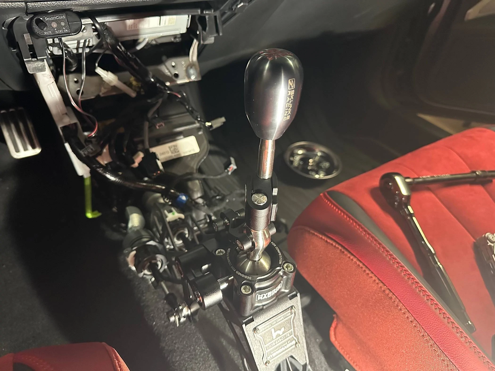

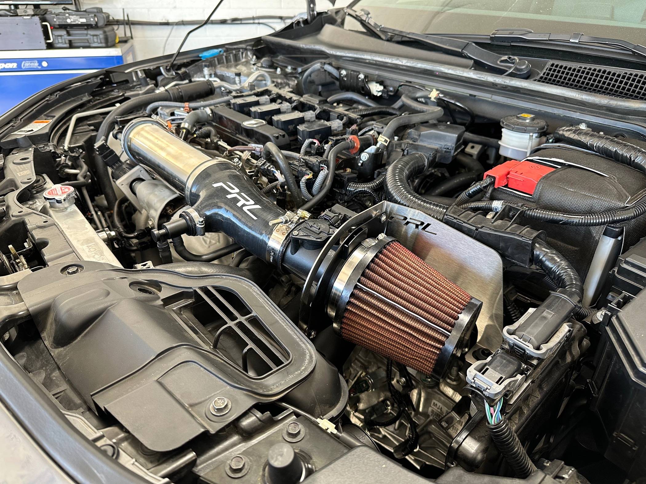

Vehicle: 2023 Integra A-Spec w/technology (manual).
Total tuned time: 7 months.
Tuned miles driven: 6,000.
Tuning device(s) used: Hondata Flash Pro.
Tunes used: Hondata race tune, Ososik custom tune.
Fuel used: 91 octane.
Additional related mods: PRL SRI, PRL Ti Inlet pipe, RV6 turbo, PRL charge pipes, PRL intercooler, Two-Step downpipe, PRL front pipe, Vibrant performance resonator, Magnaflow exhaust. Koyo radiator. RS-R lowering springs, RV6 rear sway bar, RV6 toe adjustment bars, SPC camber kit. Action Clutch Stage 2 Kevlar clutch with Chromoly flywheel, Hybrid racing short shifter assembly, Skunk2 weighted shift knob.
Problems/issues: Head gasket failure - New head gasket and Two-Step/ARP Ti head studs installed. Excessive oil flow to RV6 turbo - RV6 performance warrantied turbo and installed oil reducer.
Driving style: Commuter with periodic bursts.
Tuning experience notes: Based parts selection based on best bang for the buck. Had PRL HVI, but part no longer fit due to thicker radiator. For flash tune, discussed with Nick Ososik and modified Hondata tune for reliability (limited torque to 232 ft-lbs on Mustang Dyno, increased top end to 23 PSI max. Limitation to power with current build is fuel flow, 91 octane, and inlet air temperatures.
Shout out to Nick Ososik from Ososik Media, Rich Wong from RV6 Performance, and Two-Step Performance.
