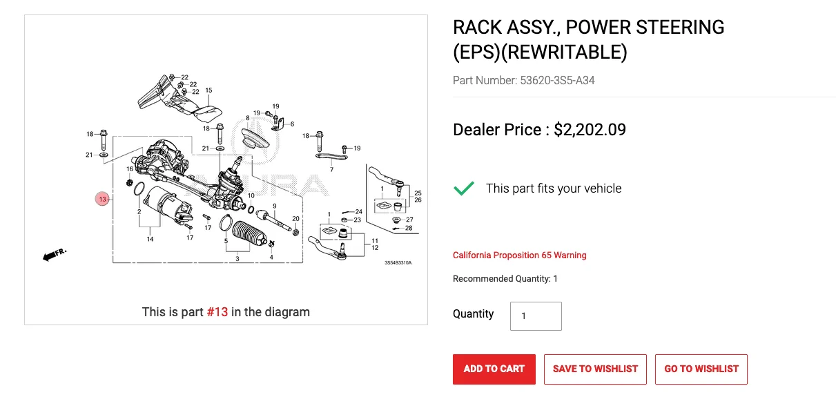

Just took a peek to see if I could determine any parts availability and it looks like we have another new part number for the Rack Assembly: 53620-3S5-A34 (previous was A24).

Emailed my service advisor about the new part number and got a reply fairly quickly. Can't say enough good about Gary Force Acura here in Nashville. Really good people who seem to want to make me a happy customer.
Here's the email I received back:
"Josh (service manager) will reach out to you the 1st of next week. We are going to order a new rack but they are still not available till some time late February or March. The DPSM (District Parts and Service Manager) for Acura is back Tuesday and we will arrange a rental for you till the part arrives."
So if I'm reading this correctly, it looks like they are going to provide me with a car until mine is repaired. That would be unbelievably nice of them.
I really haven't been a squeaky wheel, just kept in touch with them since purchasing the car on November 30th. Probably reach out once a week. I've already received several timely emails from the service advisor and a call from the service manager.
Given that there is no recall or TSB, I am really impressed at how well the dealer is handling the issue. I think they are doing all they can.
