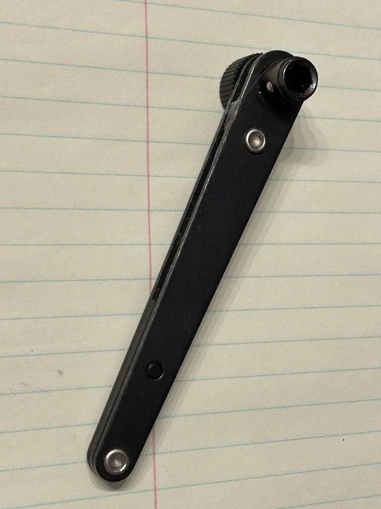

You need to get one of these.
Acura Integra Splash Guards Ratchet wrench small

thanks for that tip. i didnt know a tool like that existed.

I used a small ratchet with a socket that you can put screwdriver bits in it.
Also works very well for the rear splash guard.

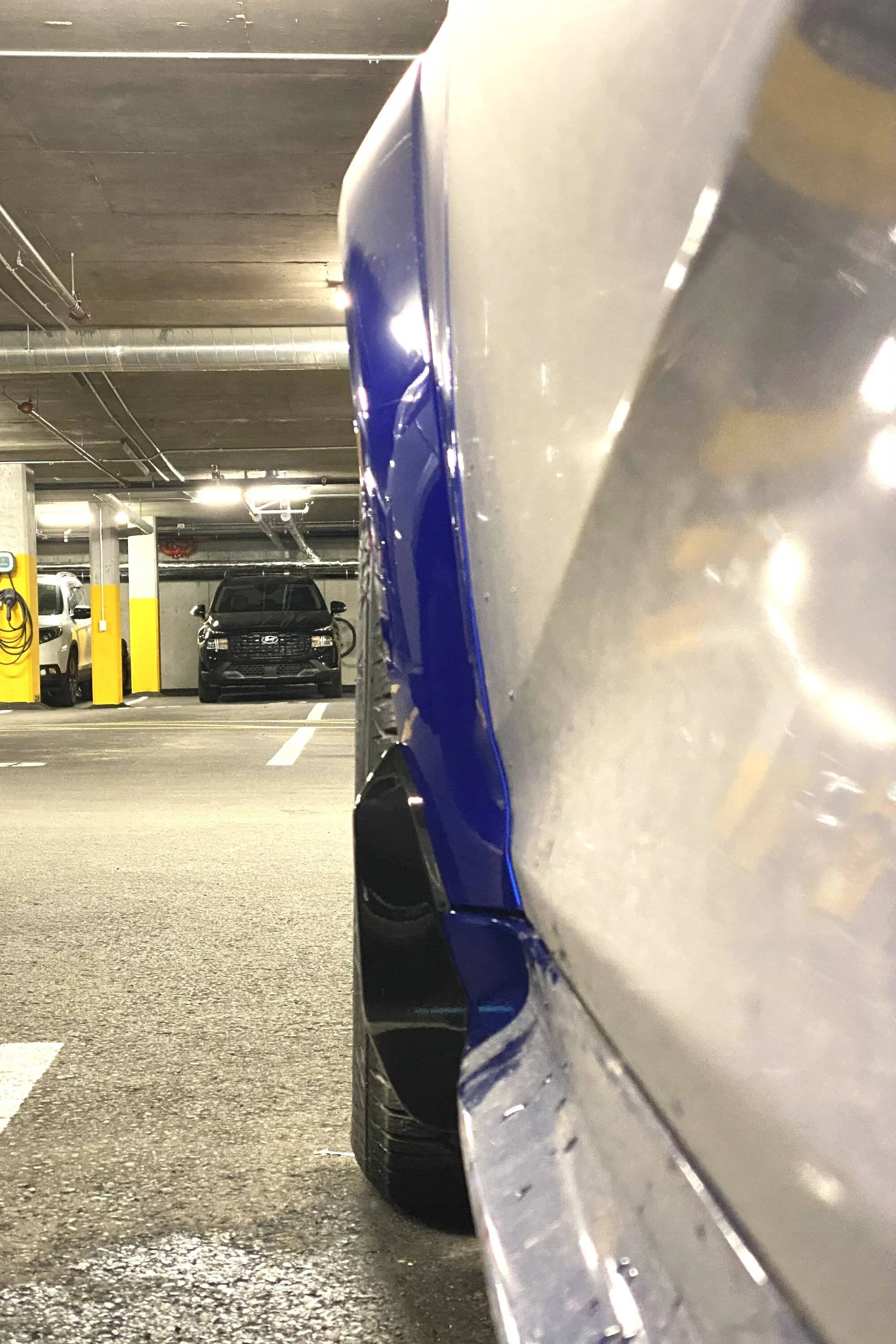

Yes, mine are the OEM splash guards for the Type S. The other thread shows the non Type S splash guards.
On the Type S, the lower half of the wheel sticks out from the body quite a bit. The splash guard extends outward just enough to match the full tire width. Here’s a picture from the rear.

Got them installed on mine as well, and was pleasantly surprised (in a good way) that they stick out further.
I had rally guards on my FK8, but I personally didn't like the aesthetic for the ITS. OEMs seem like a nice compromise

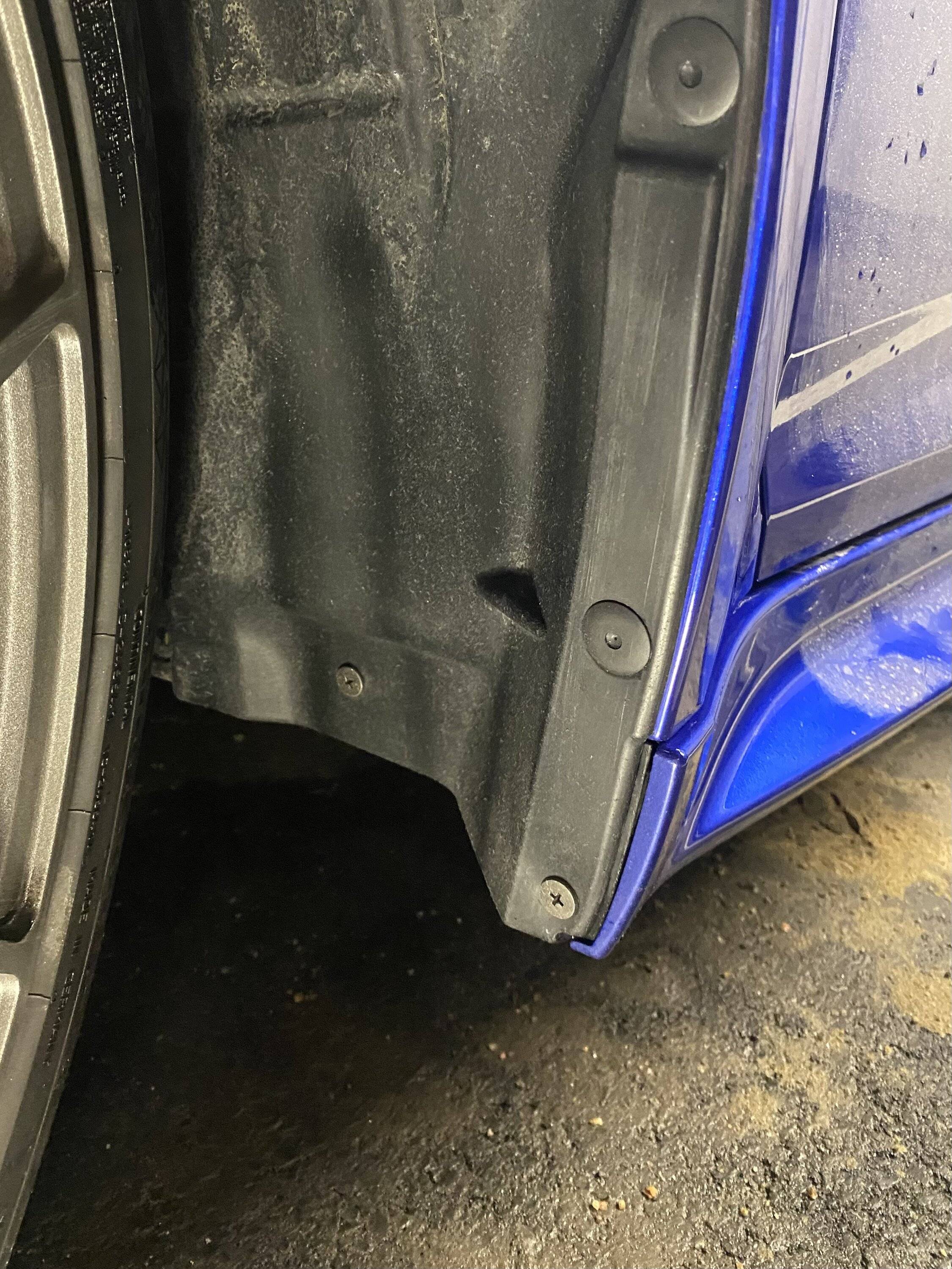

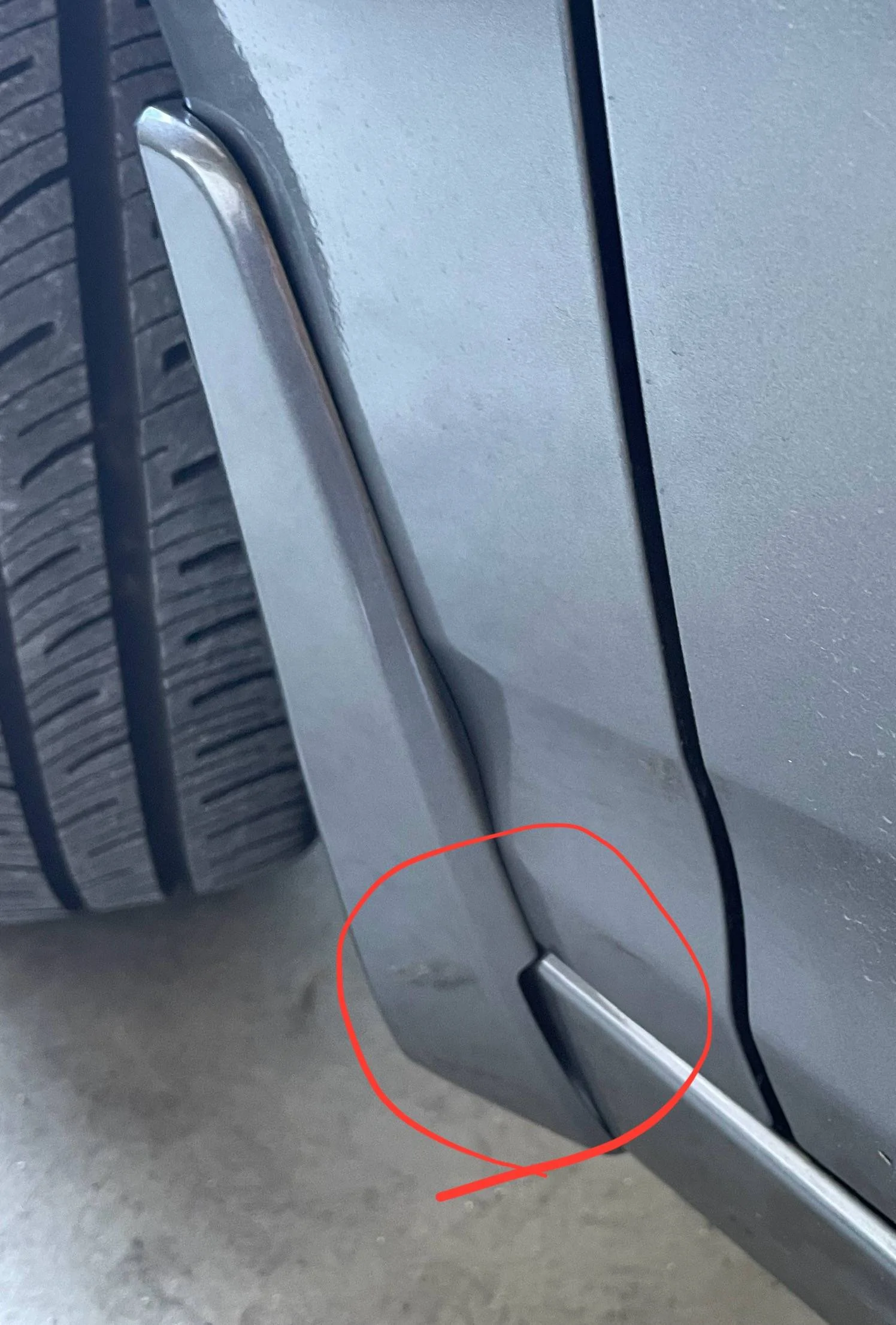

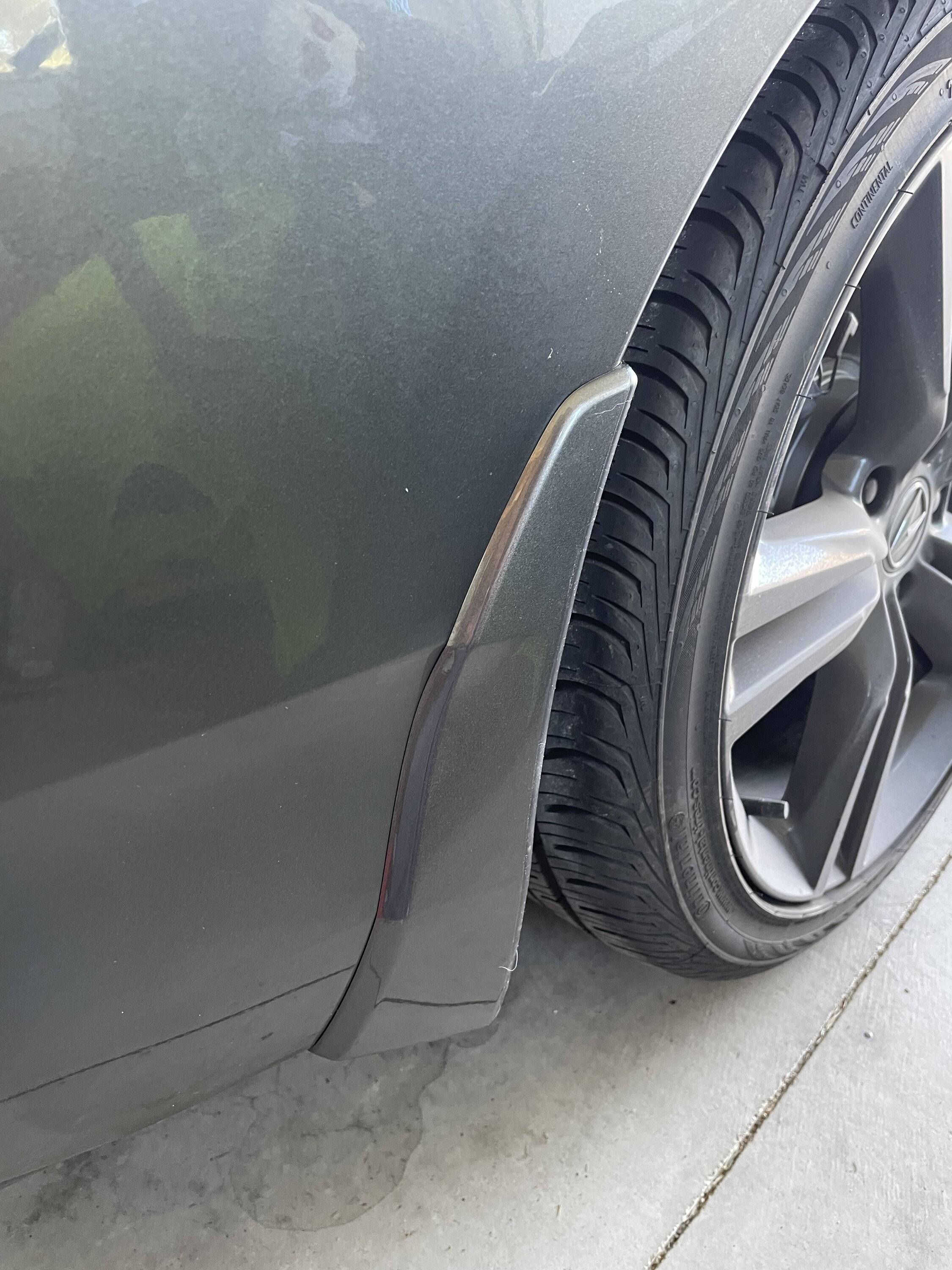

Has anyone self-installed OEM splash guards on a ā€˜24 A-spec? I picked up a set from MyAcuraParts.com. The rears went on just fine with a nice clean finish and tight fit. The fronts though don’t match the contour of the rocker panel - there is a very noticeable gap. Did I get a defective set or is there a trick to installing them flush?
Front:
Acura Integra Splash Guards IMG_1824
Rear:
Acura Integra Splash Guards IMG_1826

Yup, here’s how the front ones are mounted.
