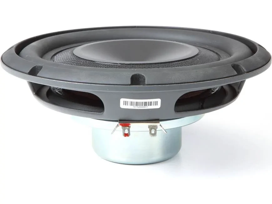

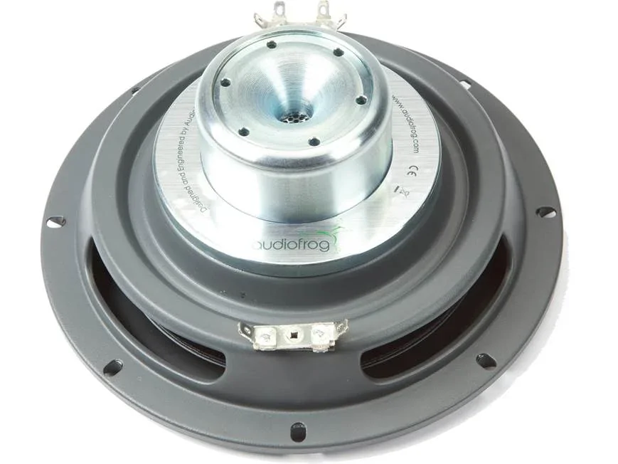

I think I found a subwoofer (Audiofrog GS8ND2) that will work even better than the Rockford in our little factory enclosure, and likely won't hit the grille. The mounting depth is only 3.125" and the basket diameter is smaller than the Rockford, so it may not require the same trimming (or at least a simple trim ring to adapt the mounting holes). Xmax is higher (10mm vs 8.3mm) and the efficiency is much much higher (91dB vs 82dB). This would make it a much better sub choice for those who are using the factory amplification too.
The audiofrog is good. It's minimum wattage is much higher than the Rockford so it's ceiling will be higher but low volumes and low range might suffer a bit on a stock amp, despite the much higher sensitivity. Since you're going with an aftermarket amp you should be good, but the desire to just throw something in is what drove me personally to the Rockford. That and for car systems with noisy interiors I like the way Rockford subs "punch". The audiofrog would be my choice if I insulated every bit of the car, including the roof and floor (which I might eventually get to... we'll see).
I'm curious if the audiofrog will fit for you with the stock enclosure. The trimming for the Rockford was really miniscule and I just did it with tin snips.

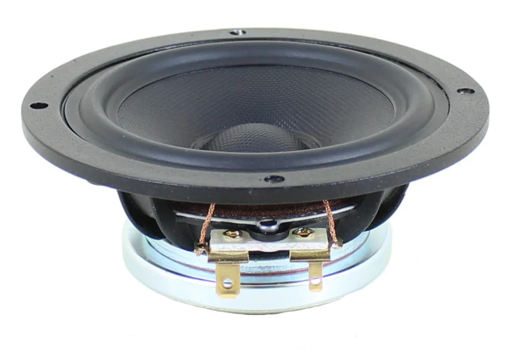

For all the various mixed choices in speakers are you at all worried about variance in imaging or tonality? Or are you trying to correct all of that with the eq/amp?

heard on the simplicity of the RF sub - it just works. That said, why do you say the AF would suffer at low volume despite the higher sensitivity? I'm not following.

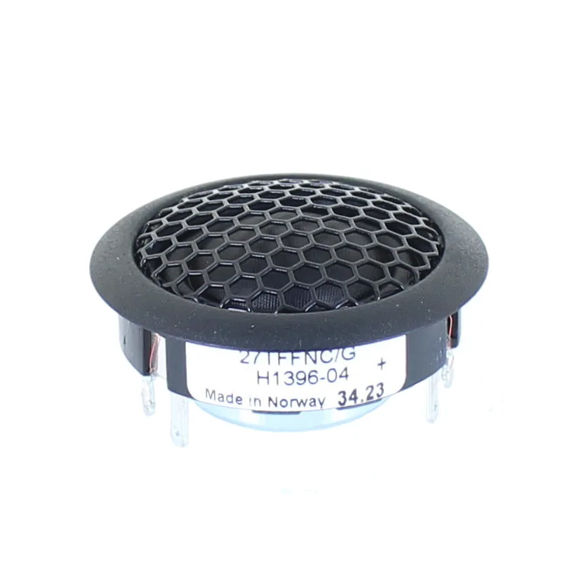

I'm not worried much about voicing for a few reasons: the midrange and tweeters are both of similar materials. All three are very low distortion drivers and all three are operating primarily outside of their system resonant frequency (again, this matters primarily for the midrange and tweeter). They are all similar sensitivity with more Xmax than they need for the listening levels I will achieve, so none will go into non-linear response before the others do.
Voicing is really all of these factors rolled into one, and yes, plus EQ. But to your point, EQ isn't able to fix fundamentally different sounding speakers in the time domain, which is where all of the above comes into play, and was taken into account. That's why I kept changing my driver choice - the deeper I dug, the more nuanced issues I found in the combinations. This combo should sound amazing - I wish I could build it tomorrow!
Oh, you asked about imaging too. This is all about xover point selection, driver location, and aim. All speakers except the tweeters will not beam at all in the bands I have selected. E.G. the midbass begins to beam around 1.6 kHz but my lowpass is 350Hz. The midrange starts to beam at 4kHz but my lowpass is 2.5khz. The sub is obviously non directional. As for the tweeter, it begins to beam around 13khz but that can be mitigated by aiming them at the center of the front seating positions. And then to top it off, every speaker will be time delayed independently. One detail that matters with the tweeter and midrange are the half-wavelength distance which varies by xover point - at 2-2.5kHz it's about 3 inches. If I can keep the center of the mid and tweet close to this distance they will act as a point source, which tightens imaging massively. I'll try to get them as close as possible to this metric.

The af has a lower range of 250w vs the 150w of the Rockford I believe. The Rockford can comfortably go down to 50w in those low to mid sub ranges where the AF will have a bit of trouble (in theory). This is assuming stock amp, which is not exactly your plan/case. Sensitivity helps for sure but even 9db (which is a ton) won't help if you're not pushing the wattage to make the minimum movements, especially in the lower ranges.
I respectfully disagree with this reasoning. In fact I categorize it as a myth I wish would go away.
RMS power handling is purely a thermal specification. There's only so much heat a voice coil can transfer out of itself on a constant basis (that's the RMS spec). It can take shorter bursts and then liberate the heat in subsequent cycles so long as the bursts are not recurring in short periods of time (that's the peak spec).
It absolutely has nothing to do with "minimum power to move the cone"... That simply doesn't exist. Sensitivity dictates how much sound you get from the same power input, period. So the more sensitive Audiofrog will do better than the Rockford with stock power regardless of their power handling specs.
Now, there are other factors that will affect the quality of the sound (the Thiele-Small parameters) but the sensitivity informs the overall volume.
Wait, I think I may have figured out where your understanding could be flawed. The metric "W" is not a frequency metric, it's a power metric as in watts.
If you want to understand how low a speaker can go, you want to look at its fs, or resonant frequency. More easily, most spec sheets actually just tell you what the useable frequency response is (although not all manufacturers are consistent with how this is measured so that's why fs can be more useful as it can't lie).
Did I correctly capture your understanding in my first paragraph?
If you want to understand how low a speaker can go, you want to look at its fs, or resonant frequency. More easily, most spec sheets actually just tell you what the useable frequency response is (although not all manufacturers are consistent with how this is measured so that's why fs can be useful as it can't lie).
I think you're overthinking it. Speakers work with magnets and the point of the power delivered to the speaker is to drive the coiled wired to create a current and produce a magnetic field to work with and against the rest of the magnets in the driver. The larger the coil and heavier the magnets the more power it will take to move. There is always some waste with power delivery (often as heat).
Yes w stands for wattage. The rms is supposed to be an ideal where that speaker works efficiently at high volumes but you can always drive up and down as much as you want. There is definitely a lower range of power where a driver just won't move. As an extreme example, take a 24" woofer and compare it to a 1/2" tweeter... It doesn't matter how efficient the woofer is, it won't move when you give it half a watt, but the tweeter will. Again it doesn't matter to you if you're replacing the amp, but it may matter to others. I'm not talking about the speaker's lower effective range. That's something else entirely and a lot more nuanced once you go below 35hz.

Again, respectfully, I disagree with the thinking above. It's objectively incorrect (again, respectfully).
I'm glad you detected that I know a good deal about audio engineering (I do) and hope that you can factor that in when hearing me out!
Heard on you understanding the 'W' spec is wattage. We agree on that. We don't agree on what it means for a speaker, though.
The power spec on a speaker is simply how much power it can handle. It's not a lower limit on movement at all. In your example where a subwoofer and a tweeter both get 5 watts, you are right that the sub will move a miniscule amount. But the movement alone is not the only variable that determines the sound output. It's the movement multiplied by the area (and frequency), to get volume displaced per unit time. A large speaker doesn't *need* to move much to make a lot of sound. That's why larger subwoofers have higher SPL potential than smaller ones. It's just swept area.
Speakers are remarkably low-friction. There is no "activation energy" required to get a speaker moving. If there was, it would be a terribly nonlinear sound producing device. As I stated before, if every Thiele-Small parameter of two speakers are identical other than sensitivity (technically this isn't possible mathematically but humor me for this point please), then the more sensitive speaker will ALWAYS produce more output than the less sensitive one, no matter what the power input level is.
To your reasonable comment that some power is always wasted as heat, you are absolutely correct. But keep in mind the sensitivity spec is a measured specification, not a calculated one. It's the output of the speaker after all the used and wasted energy has been converted already. It's a real-world number that cannot lie. And keep in mind, it's typically measured at 1 watt, so by definition it's measuring the output of the speaker at a "low level" already... and far, far away from its RMS power handling spec (which is also an empirical measurement).
I hope to continue this discussion!

I believe I'm still not being clear or there's some misunderstanding...
I'm not saying there's a minimum power based on what "wattage" a speaker is intended for, just that the driver is designed for a particular range. This circles around to Newton and lorentz law as well as the fs you already referenced. There's also moving mass to account for in high Excursion drivers which is typically the preference for vehicle subs. Yes, higher sensitivity can overcome some of this, but it all plays together.
While movement in a driver doesn't have much friction, it still has suspension to fight through. Bigger woofer, more weight, more coils all need more suspension which means more resistance and ultimately more power to drive. Look up the part 1 and part 2 research papers titled "Loudspeakers in Vented Boxes" and they go over exactly this.

Ok I understand this clarification, but I still disagree with the belief that there is a minimum input power that varies by driver beyond the sensitivity spec. If Driver A - I don't care how big, heavy, light, stiff, soft, etc. it is or even if it's a tweeter or a woofer - has a higher sensitivity than Driver B, it will be louder with the same input power, even if that power is just one watt. Because that's literally what the sensitivity spec is. There are no downstream forces at play that would counteract this measured reality because sensitivity IS the final downstream measurement (again, sensitivity is empirical, not calculated).
Drivers are indeed "designed for power levels" but that's based on their thermal capacity (the high end of the power spec, not the low end). Under-driving a speaker is totally fine so long as you are not clipping the input signal. There's no downside at all to that.
Again, to be super clear, I disagree that you can infer drivers with different power handling specs necessarily should be run at different power levels to sound good. As long as you are below the thermal power handling limits and you are sending a clean signal, there's no sound quality or quantity issue at all.
I am very familiar with Thiele's work, as one of the godfathers of loudspeaker engineering and the first half of the 'T-S' parameters.
This work details how a speaker *system* behaves in various enclosures and how its electrical and mechanical attributes interact with that enclosure. It's all foundational and excellent work and I take no issue with it at all.
I think what's being misunderstood here is that sensitivity is a measured outcome of all of the above. Once you have two 8" subwoofers in ideal enclosures and measure their sensitivity, whichever one is more sensitive is louder and less "resistant to motion". Bringing it back to the original point, the Audiofrog will always be louder than the Rockford in identical sealed boxes, at any power level. And its frequency response will also be optimal at any power level, until you hit the mechanical limits of the suspension.... and that's why the AF is still better. It has more linear Xmax so it's both more efficient and has more high-power potential. It's just a better sub for this application.
