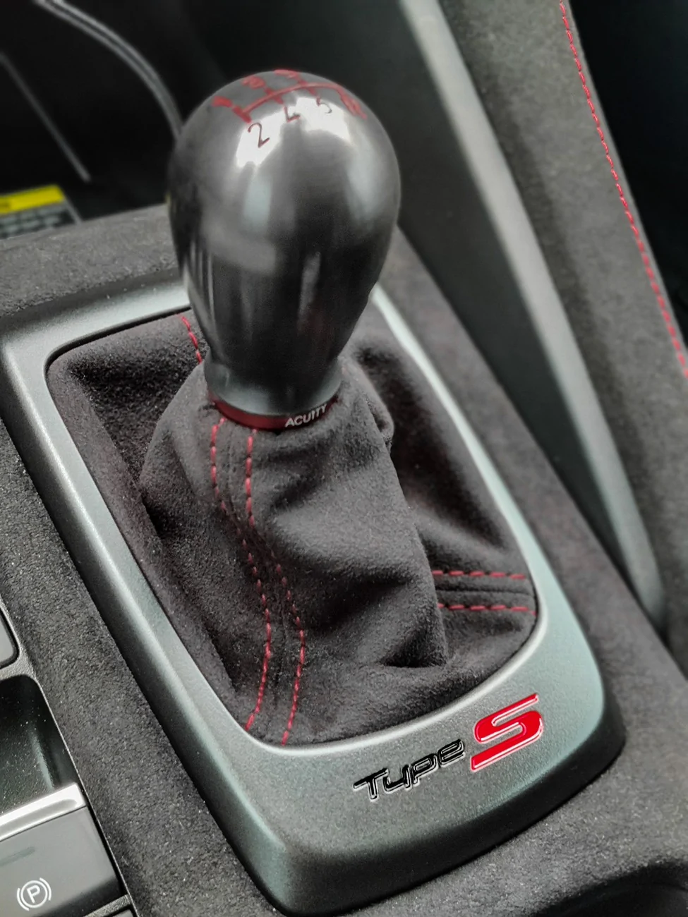

I don't have a picture (of the method) but if you wrap some tape around the collar as Vic mentioned, it can take up enough space to reduce the slack. Best picture I currently have of the results.

If you have some on hand, electrical tape would be a good alternative as well. You shouldn't need very much but some trial and error will get you to the right thickness. I want to say I needed enough for about half the thickness between the collar's original, smaller diameter and the full diameter (the visible portion). A few overlapping layers of tape would also offer some "fine tuning" to add or remove as you see fit. 👍

That looks great. I really like the red. Thanks for posting. If you want to go all out get a stainless or black HybridRacing boot collar. Adds just a little extra.
I ended up changing from the stainless one in my pic to the red one. It looks even better.
It also holds so much better than the cheap OEM one too.
