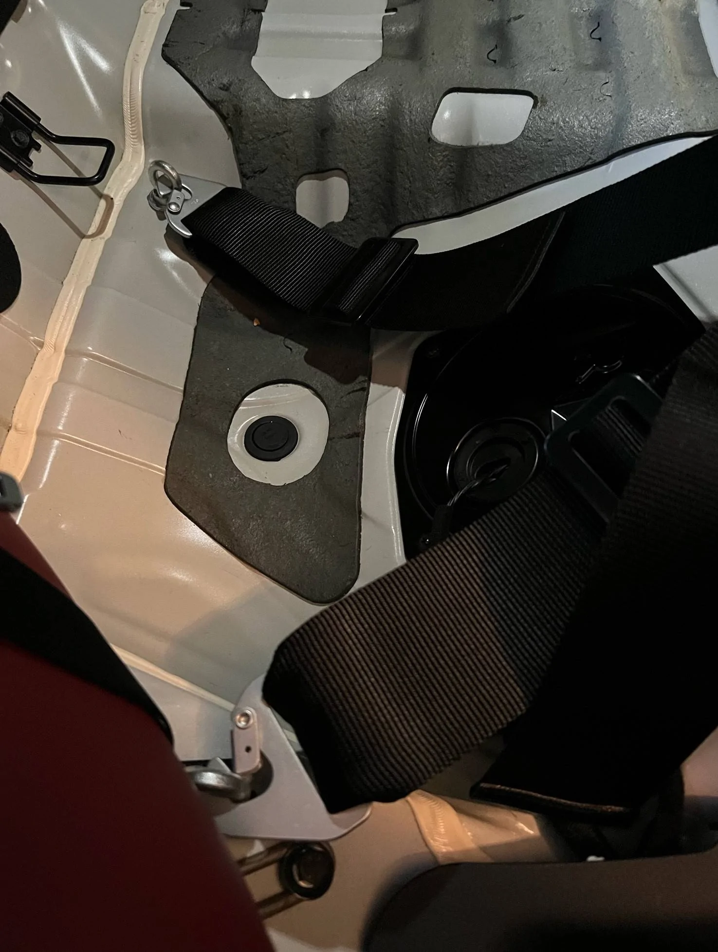

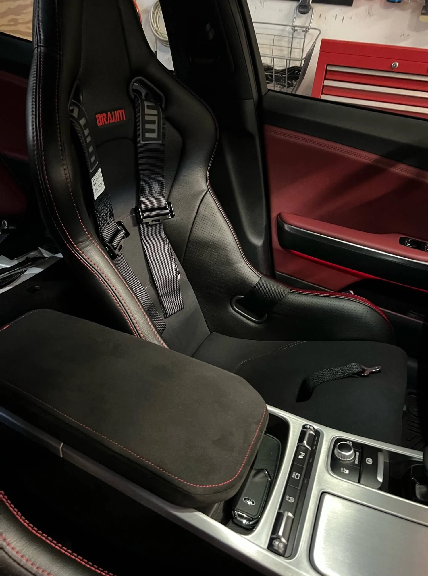

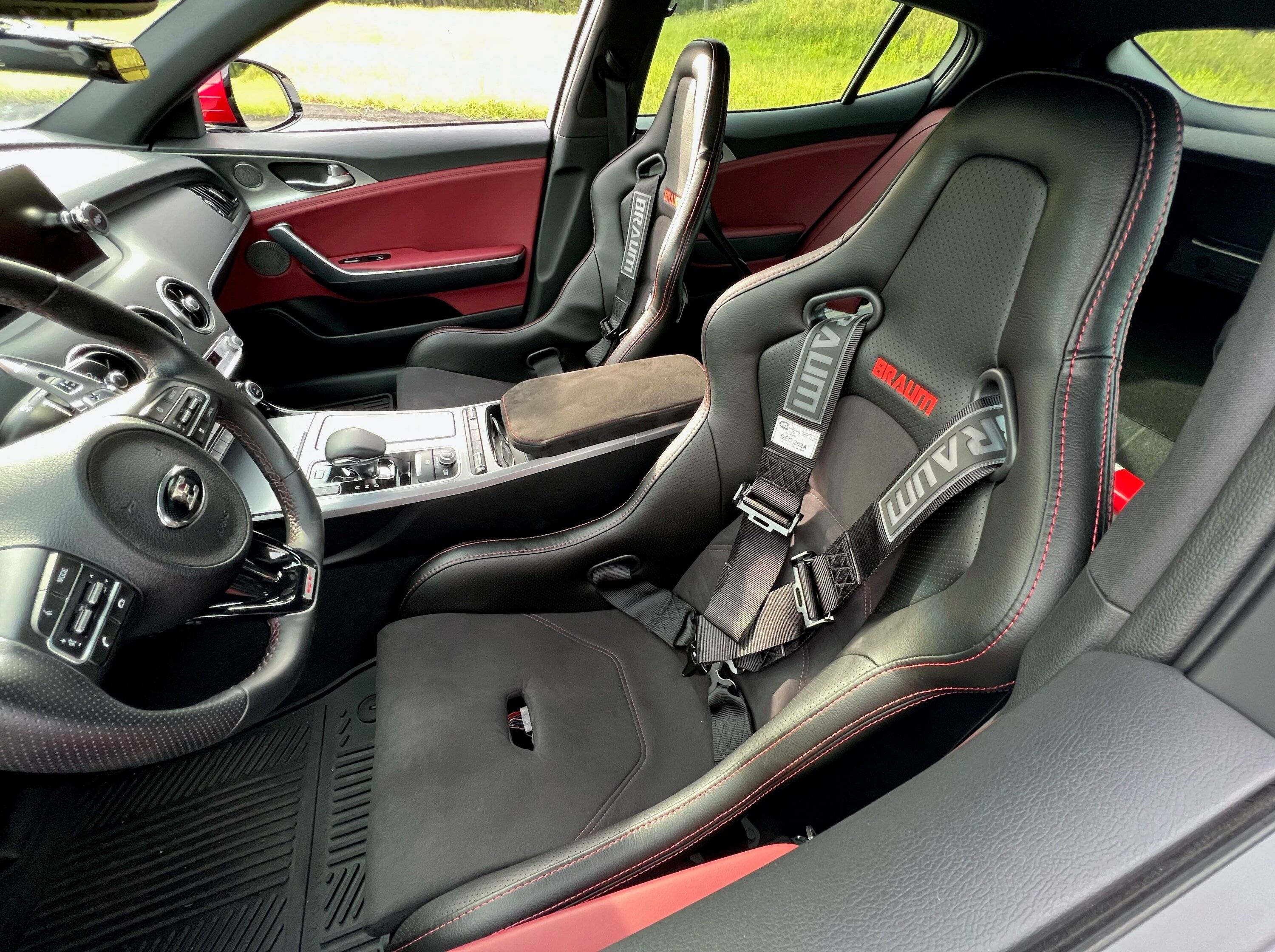

Yes, that's how my harness hooks up as well. just have to remove the back seats. I wold be tracking mine. I did run into a guy that had a direct bolt in Harness bar in his CTR, FK8. I think I would not do the harness bar and just anchor them as I did in my last car. Some track organizers require a roll bar as fixed buckets/harnesses could be dangerous in a roll-over if the roof were to deform at all. You essentially be locked in vertically. That scares me a bit. Not sure what I'll do in the ITS. Love the buckets and harnesses, but the stock seats are not too terrible on the track. Pics of previous car:

I installed a schroth 3(4) point bolt-in harness in my Camaro. Fairly easy install, use the same bolts as the existing seatbelt for the lower, then for the upper I chose to go to the parcel shelf upper child seat anchors because the angles worked in that car, for the Integra I'd recommend going to the lower child seat anchors because it has no package shelf. Can throw it on the floor in the backseat for street driving, then pull it forward for use.
Regarding what was mentioned about what organizations would let you use it: NASA was a no without a HANS, they said they'd consider it if you did have the HANS but it would be up to the organizers discretion, as it really should be mounted to a harness bar. SCCA will let me run it at autoX or TNiAs but anything over that they will require a HANS and a harness bar.
If you have the ability I would ABSOLUTELY swap the seat before putting a harness in, the seat change is the right way to do it. For my circumstances the seat swap was going to change my class so that was why I compromised with the temporary harness. Because of the restrictions around it I still end up using a regular seatbelt for most track days that I run, it's really only for AutoX that the harness does me any good.
