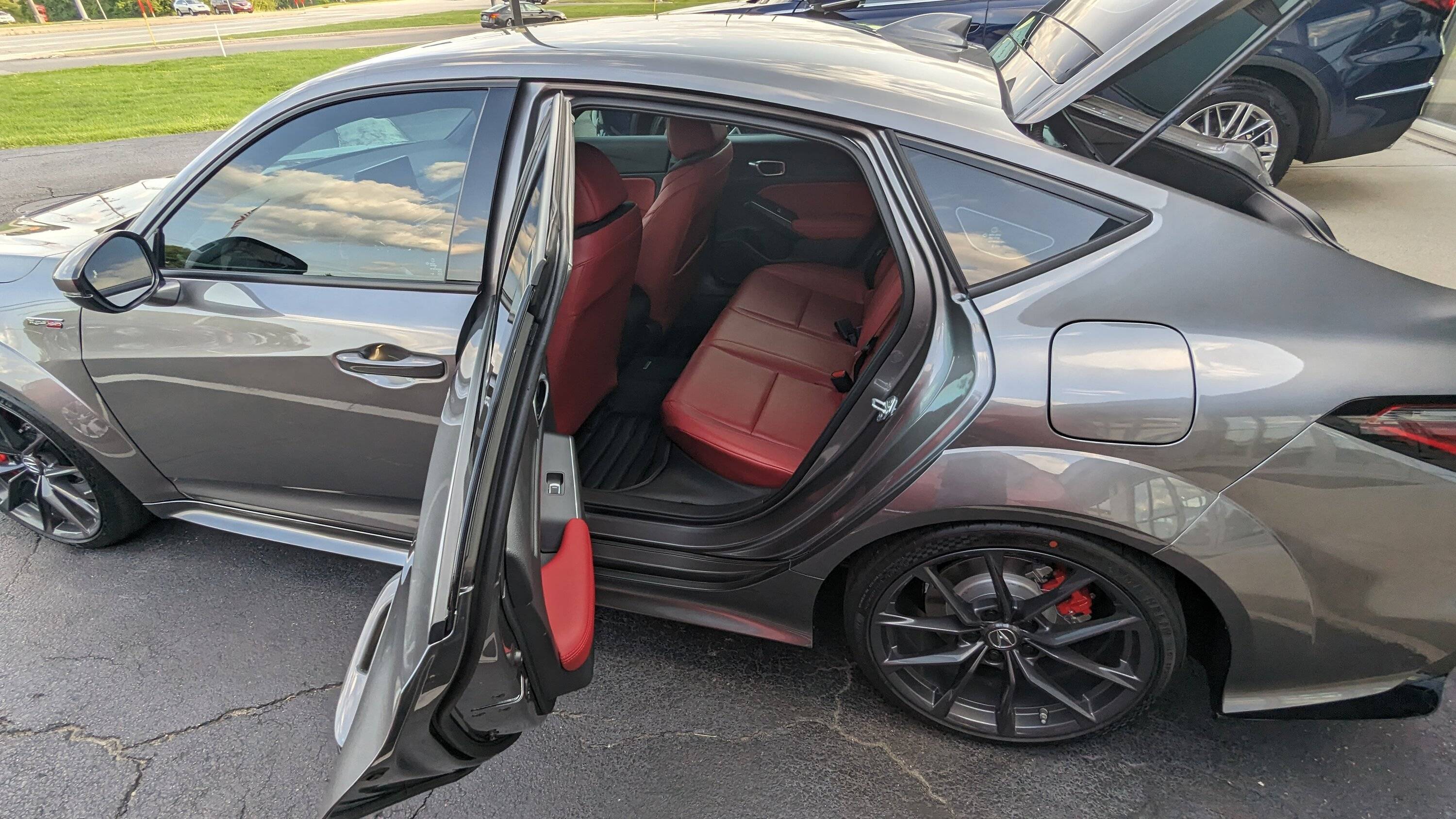

My ITS left the dealership as a 5 seater..

Like I said: It can be done. The legality of it is another story though.

I didn't say they did it. I just said when it left it was a 5 seater?
Everything bolts in. Same mounting points in the ITS as the Aspec. They actually have empty buckle attachment brackets mounted in place since it can't be attached without them.
