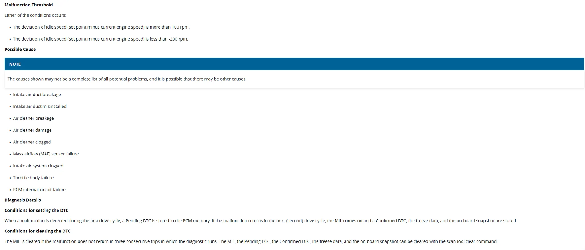

Here is some info specific to the car.
Acura Integra Problem with Idle Air Control Valve? (DTC P050A) 1772324163919-k3
These cars don't have an idle air control valve and instead just use the throttle body to control idle speed. If you keep having issues I would check all of the intake plumbing and vacuum lines to make sure you don't have any leaks. Otherwise it sounds like it might need a trip to the dealer
