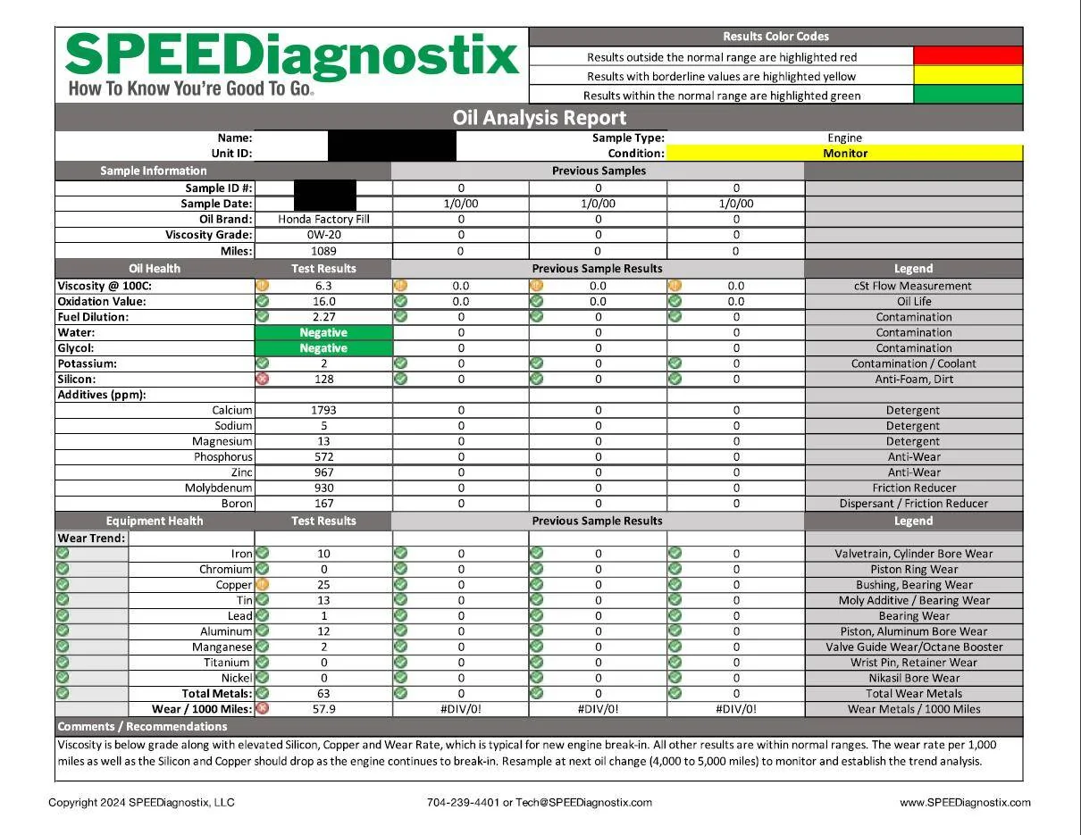

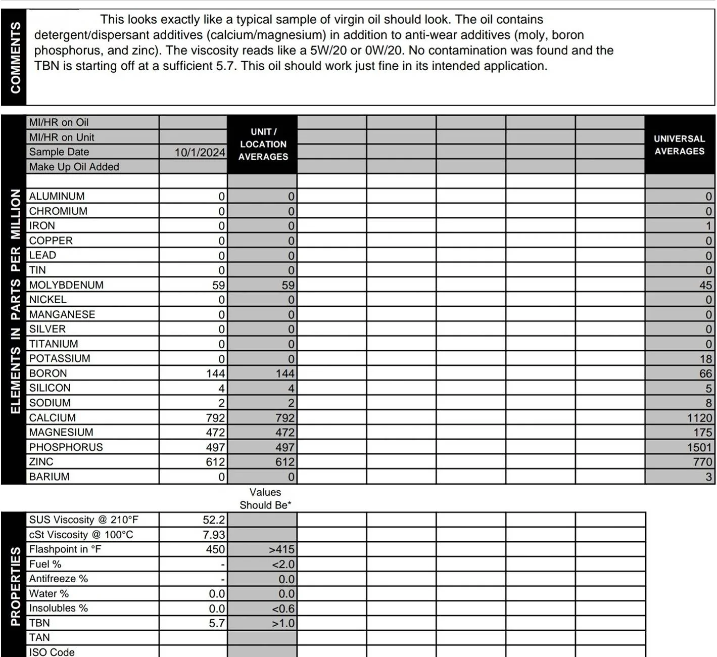

You're right the factory fill contained very high moly content. It's very low on mag though. The replacement oil from the dealer is the exact opposite. I'm. Really not a fan of the virgin oil's formulation from a high level. I curious how it's used values will look and how it will have degraded. Notice in my linked analysis how much viscosity the factory fill lost after one track day. I suspect it was a 0w20 to start.

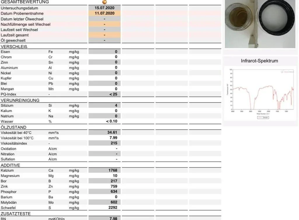

OK, bit of oil geeking but not going too deep here, that is what BITOG is for.
Totally appreciate your posting your experiences @Victorofhavoc , I was a bit cheeky on then notion of a testing agency which I disagree with. Single unit tests that show oil 1 better then oil 2 sure, and that's marketing at its best but an engine is a system the properties multi-dimentional over time.
Your experience is to the point that each application and engine can have different behaviors that react to oil choices and sometimes one has to be more educated about what they use vs. what a manual says or what you have used before.
By M1, you don't specify *which* M1: many many products they make. I am guessing it may have been Euro 0/40 which is known to be a pretty light 40 and shear quickly to a 30 but its also an oil that works very well in many applications, but in yours not so well. STIs didn't like it much, but older EJ20's did. It shears quick but tends to then stay in grade for a long time. That is key that its not a linear behavior, and often you will see drops in samples in the first 1-2K and it then mellows out over time.
Factory Fill is a 0w/20 but its the type 2.0 which is *not* what is sold as the Honda/Acura SYN in the US, its this:
Dream has it listed:
https://www.dream-automotive.com/pr...lCrL05J41xthro7vZQTMjvHbBdV9QVqzJ8xueqJ-qyPi6
For your UOA, sure its then the upper 7's it was new, your 6.76 is still well within grade. I think Redline has one of the higher 8.x ratings for a VOA but that is just V not how it behaves over time.
I suspect for tracking, you have moved to a nice 0 or 5/30 with a good HTHS rating which is more important then the fixed 100 value anyway. :D
There is a fellow in the EU who has run the Type 2.0 on multiple OCIs and educated folks like me on its results for their Type R.
Below UOA is of the Type 2.0 and is similar to your, save the higher Cst.

Thanks for the link on dream. That actually looks like a more decent oil than the dealer fill! I like seeing other's data points as well!
