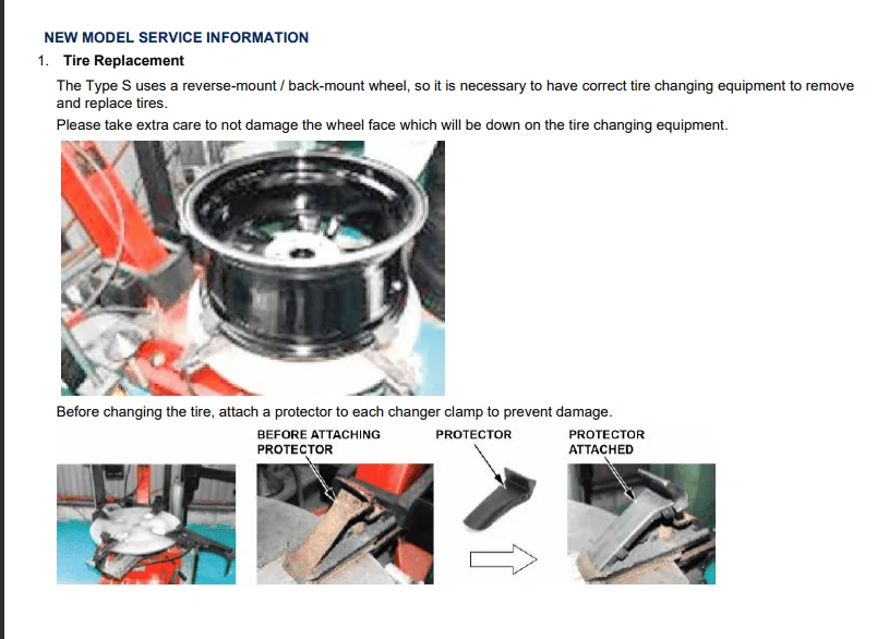

Thanks so much for the info. I was just wondering where I should take it since the wheels are new in the box/didn't want to get either set scratched. Does the Acura dealership do tires?
Sep 21, 2016
Hartford, CT
24 ITS
I would def go to the dealer for these as they actually require a special mounting technique (reverse mount) and the wheels are prone to chipping. The charged me $180 to mount and balance stand alone wheels and tires I brought over. They tried to charge me an hour of labor for TPMS calibration but I called them out on it (they will self program after 5 miles or so of driving).
