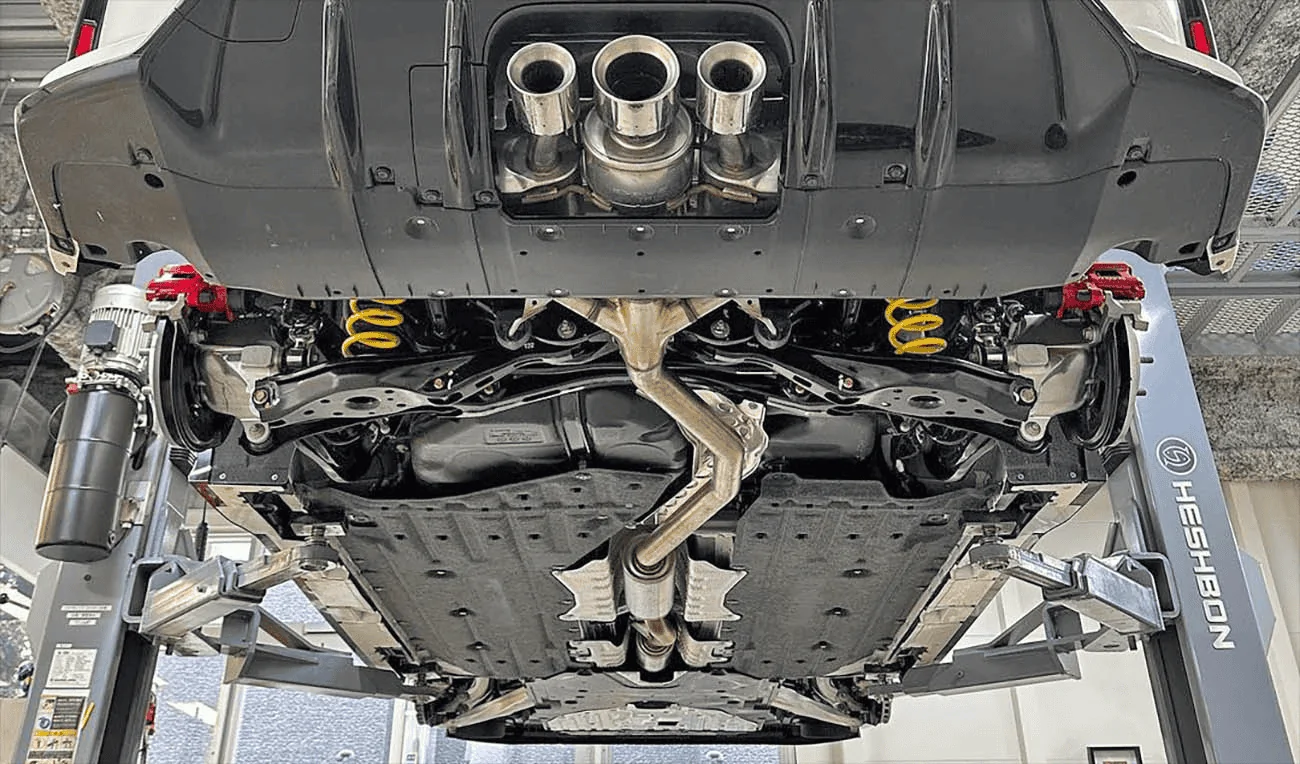

Also something to note about the rear diffuser. On the Type S it doesn't cover underneath the exhaust or extend as far as it does on the FL5:
Yeah that is not a functional floor or diffuser. It's doing just what it's doing for every other Honda Civic on the road, increasing fuel efficiency.
Acura says the rear diffuser reduces lift on the ITS. Absent independent testing, I do take their word that it’s functional
I tend to agree though... if it's not actively introducing lift then technically it's "functional"... but let's be real we all should recognize it's not a racecar.
I think with this, it's just a "take the win" situation. It's a great car, personally I don't think you really need to try to peel it back all that much.
