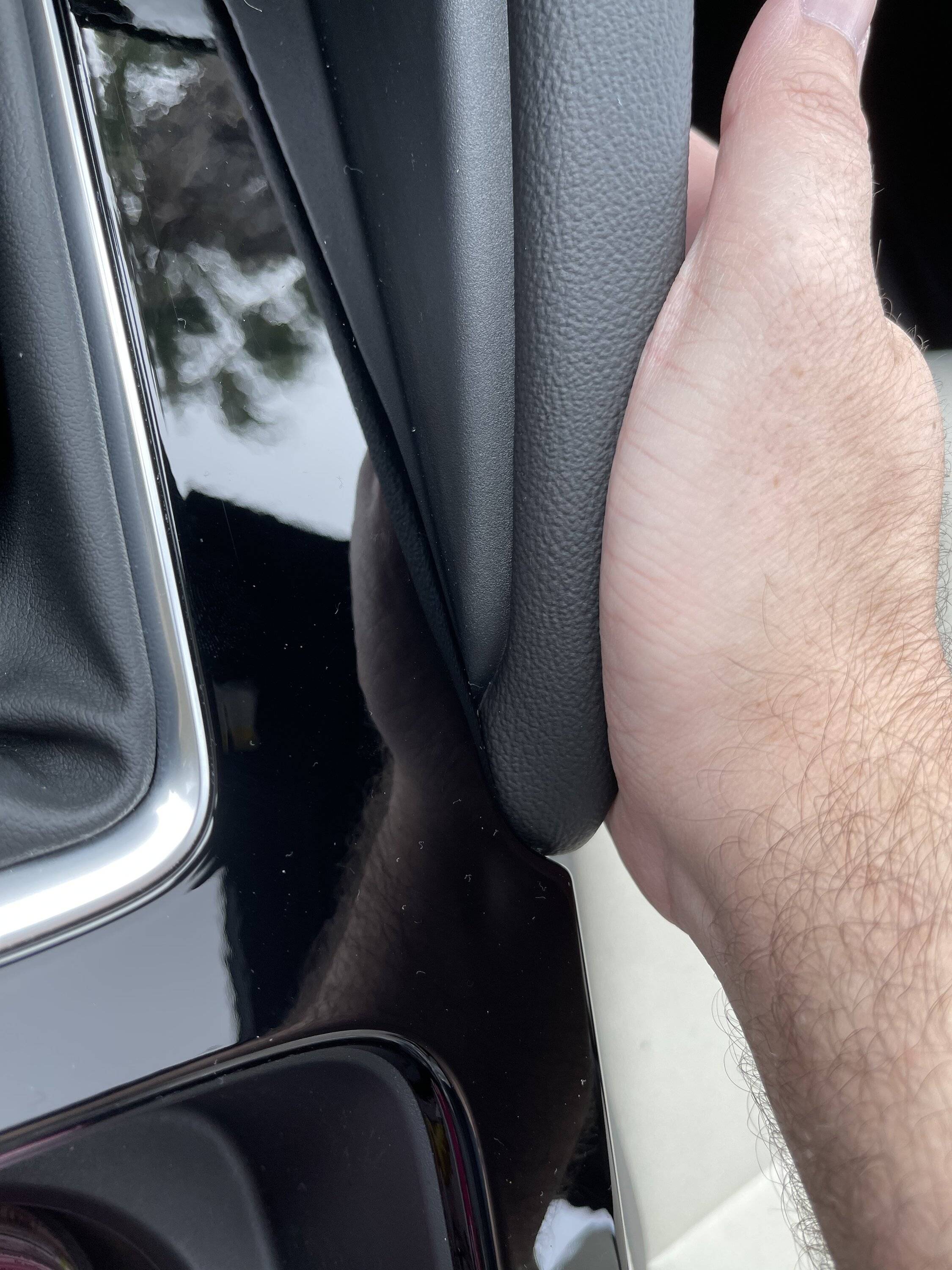

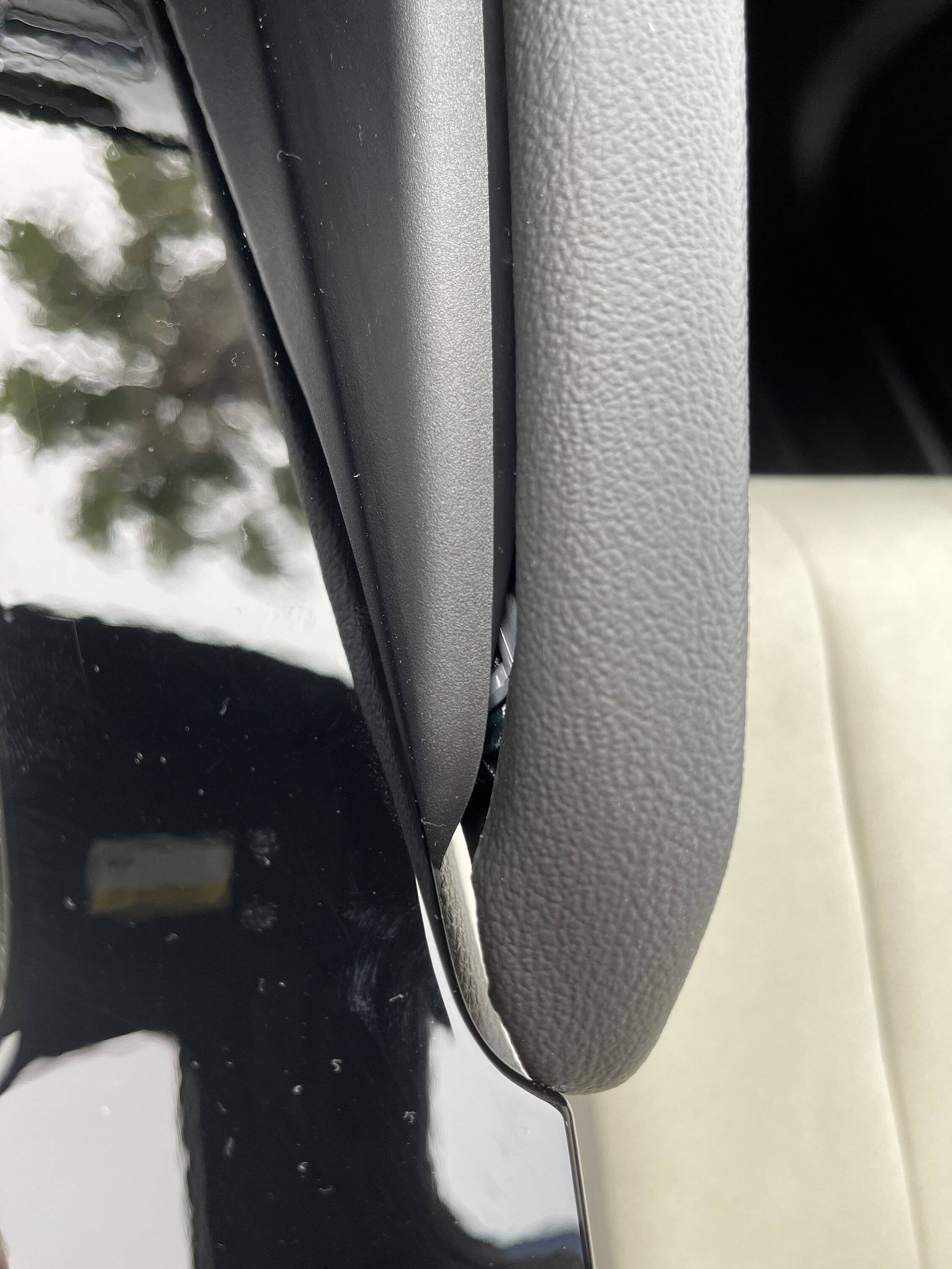

I just got her today. I love it. BUT I noticed this when I got home. To the right of the shifter there is a large gap. I can press it in place. But it doesn’t stay.
Any suggestions short of going to the dealer?

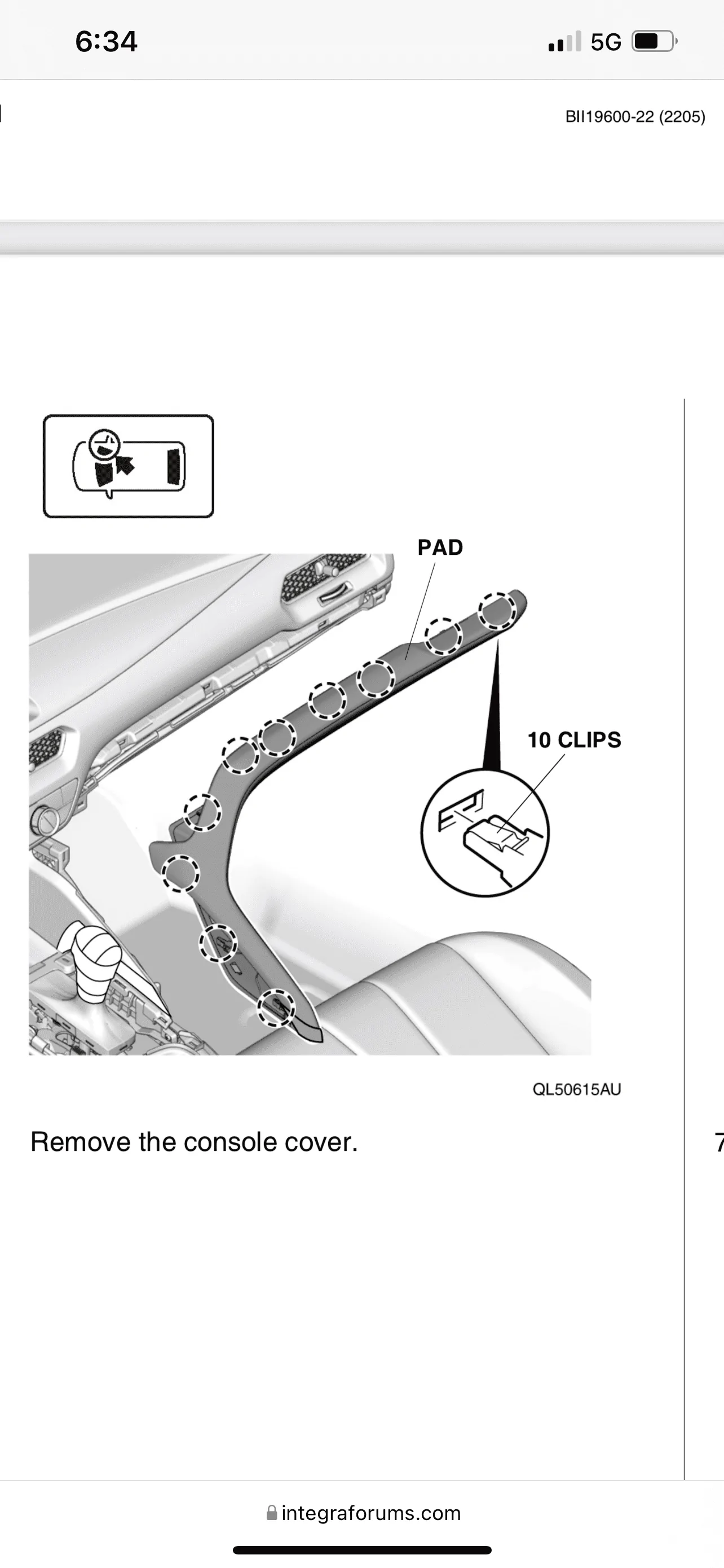

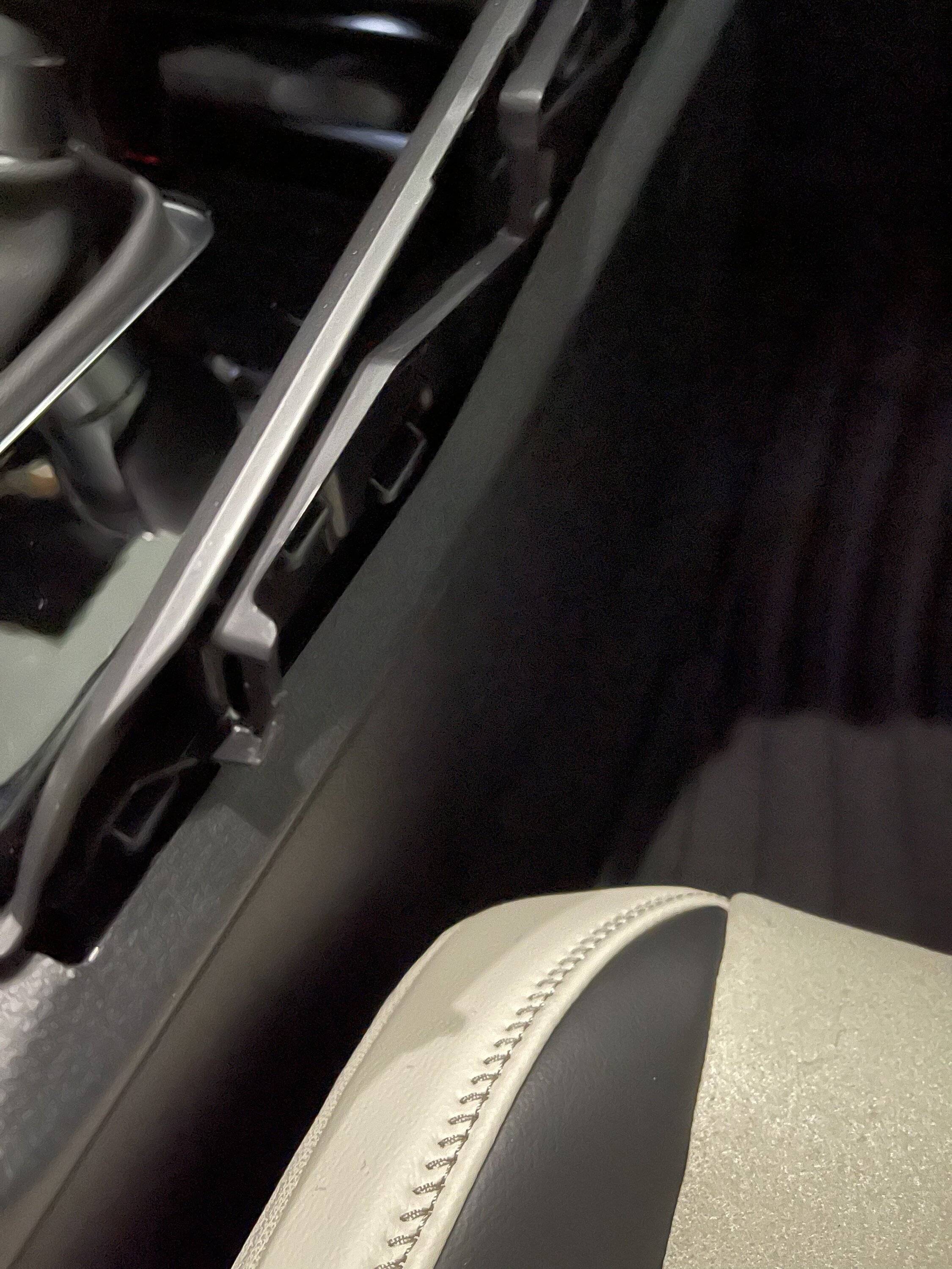

So that trim piece pops off very easily. I used the wireless charging pad accessory install as a guide. The clip was in its place and everything seems sound. Not sure why it’s off.
A funny note is that on the inside of that trim piece there is a sticker that says ILX 2022.

Update: so the dealer grab the same piece from an unsold Integra and it fit MUCH better. Still a small gap, but the others on the lot they had also have a gap.
The NSX tech believes it’s the material and how it’s bunched up and stapled in on the underside. It was very bunchie in that spot and could have stopped it from sitting tighter.
Oddly enough, my old piece fit snug in the other Integra. 🤷‍♂️
