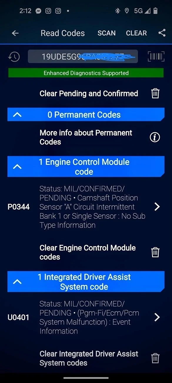

Im having the same dam issue basicallyon and off since about 900 miles. ive taken pics everytime it happens so i have documented at Least 16 times since Nov23.
i took it twice, first time they claimed they replaced camshaft sensor back in Jan, but since then its happened a dozen times
i went to Amazon and bought the BlueDriver Bluetooth Pro OBDII Scan Tool
just to see the codes myself and reset them if needed
im taking it in this wk and asking for another loaner while they check . Im not gonna be nice about it anymore. This is the error msg i get all the time . My previous 2022 Honda Si was flawless for almost 20k miles…..ugh

I've had the same issue 4 times with P0344. The dealer has no answers, and I am also growing frustrated. Curious what your VIN is as your timeline roughly matches mine. My VIN is 1284. Please send an update after you take it to the dealer this time.
