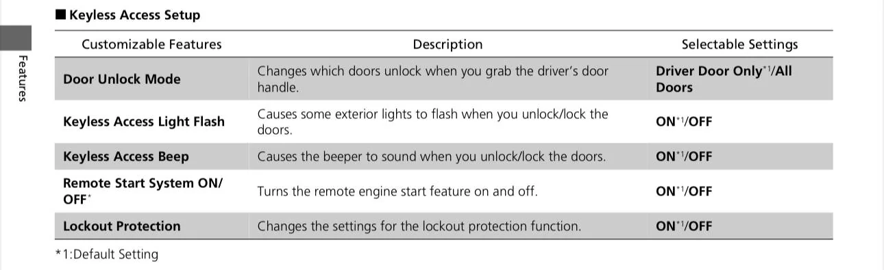

It could be turned off in the settings under keyless access in the head unit also
Lockout protection is one of the steps required. When enabled it will not allow the doors to be locked when the key is not detected. It does not effect how the vehicle responsds when the key is detected. To do what I want to do will require both disabling lockout protection and putting the fob in a faraday pouch so that the vehicle does not detect the key and will thus allow the vehicle to be locked.
