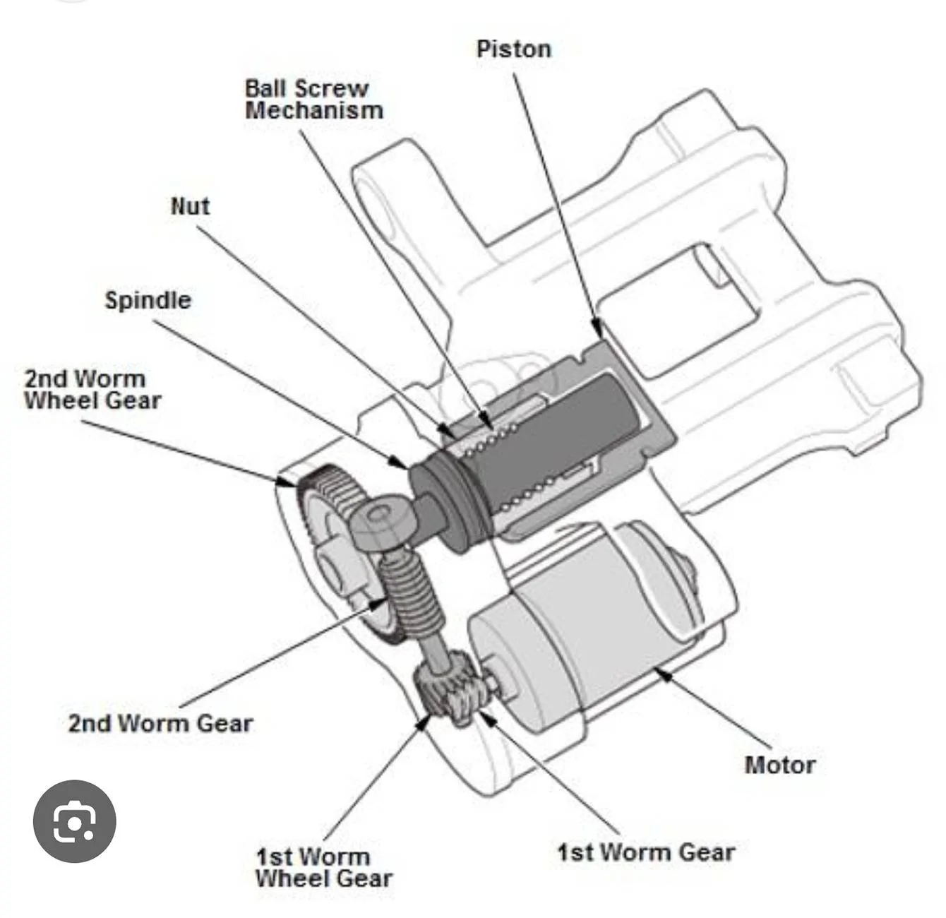

ok, yes, just wondering about the turning manually part.
Acura Integra How do you know when your brakes are toast? Screenshot_20250616_095859_Googl
This is a diagram of how it looks. (found it a few days back on civicx somewhere).
Hopefully that helps visualize. When you turn the piston clockwise it compresses back, equivalent to turning the piston shaft attached to the motor clockwise.

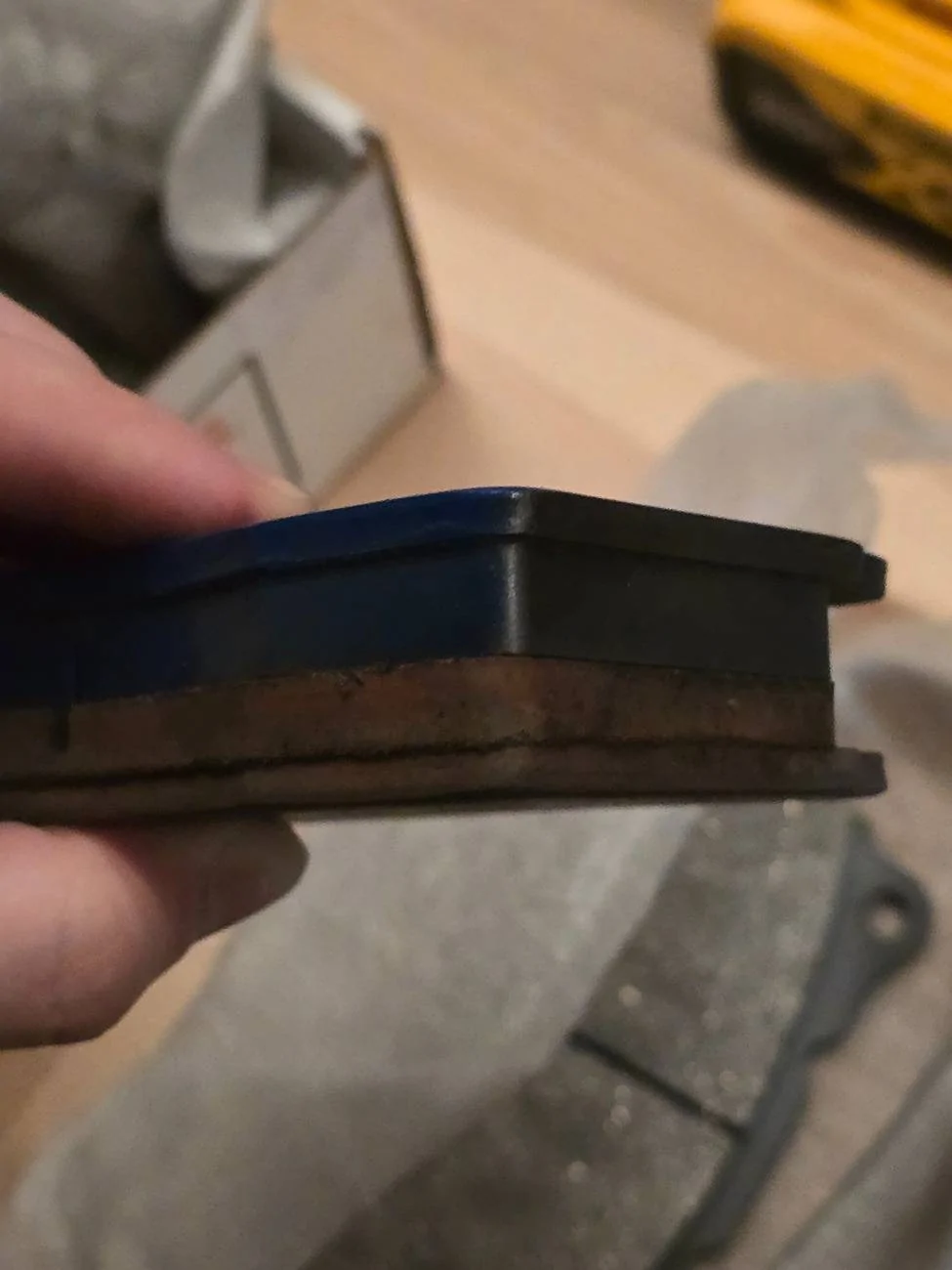

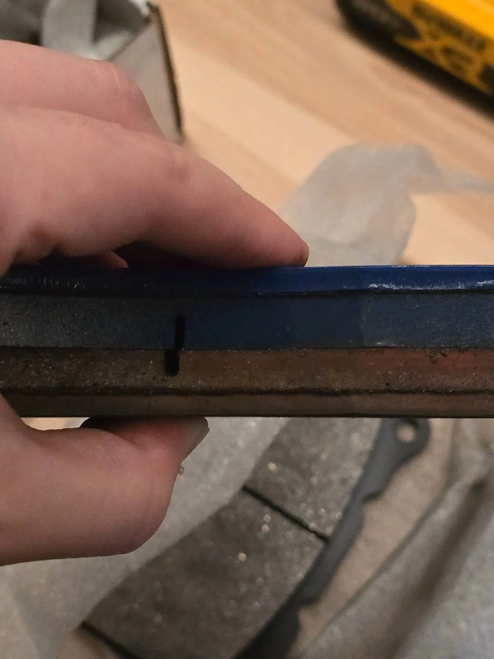

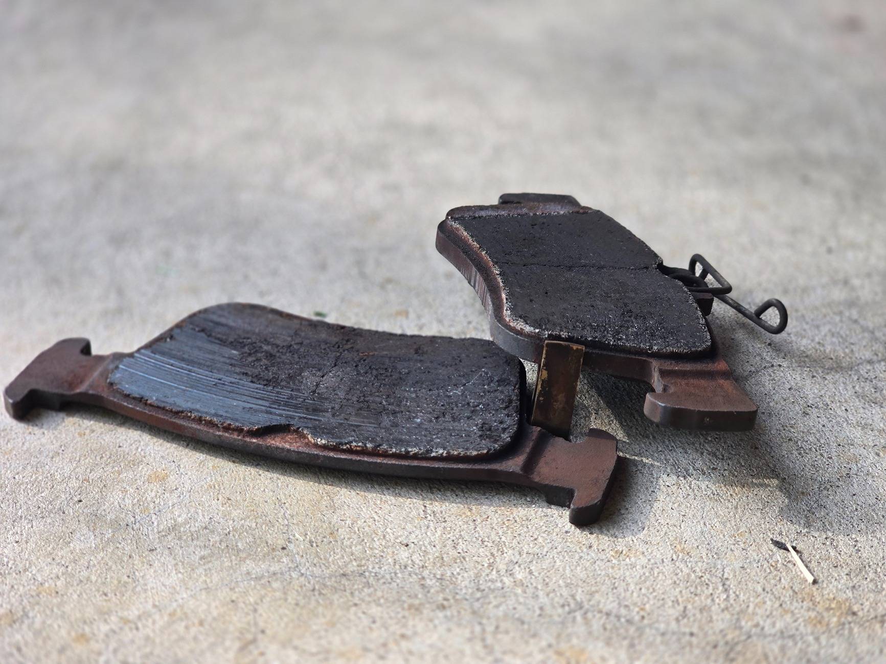

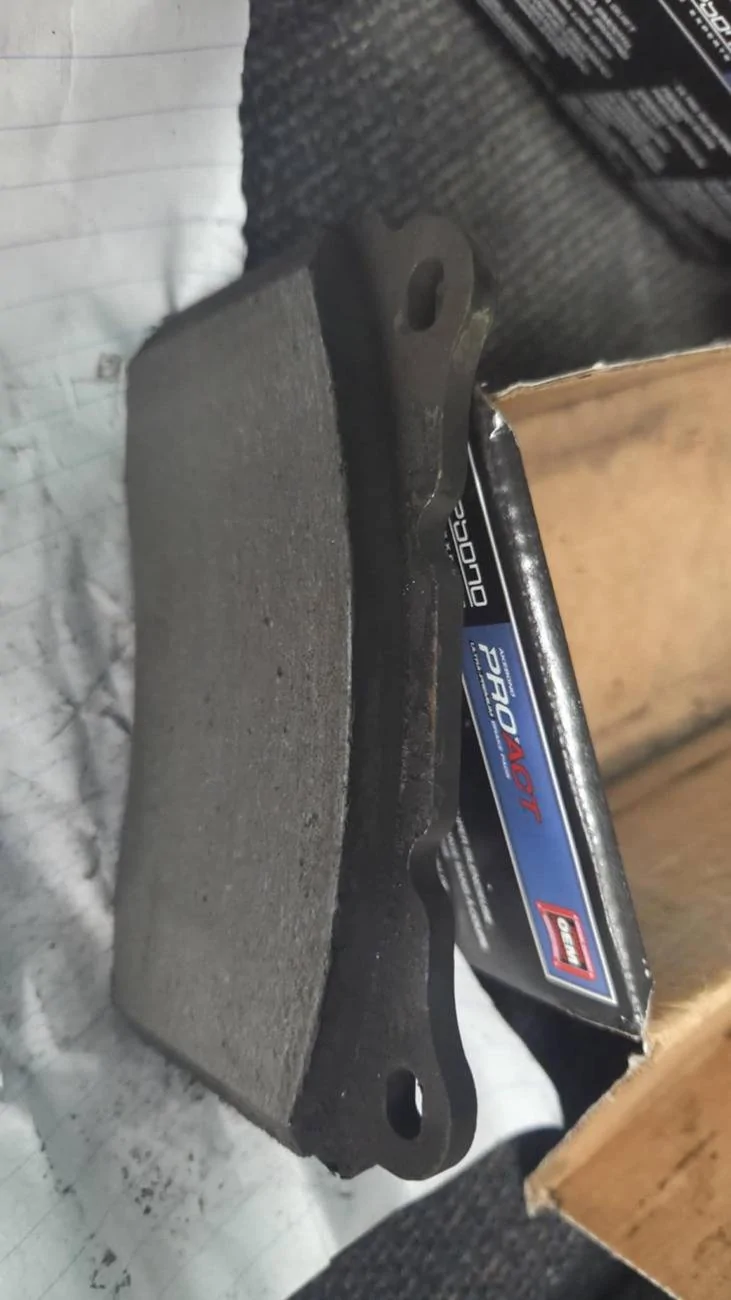

So here's what a carbotech xp10 race pad looks like after 12 sessions. The other pad is a brand new xp12. This means the xp10 is going to last about 24 sessions and I bet the xp12 will last the same. This is really solid for a race pad.
Acura Integra How do you know when your brakes are toast? 20250622_205523
Acura Integra How do you know when your brakes are toast? 20250622_205516
which DBA rotors did you go with? i was looking at doing Girodisc and i do see there are quite a few DBA options. i'm getting horrible brake judder and i'll probably throw some new pads/rotors on and see if i can get my current "juddery" rotors turned or at least sand 'em to see if that helps.
my friends with an FL5 and FK8 have had good success with the XP10s but I wore mine down to ~ 1/2 of what yours are showing in only 10 sessions. i'm not sure what i do to brakes but i absolutely obliterate them. used up a set of G80 M3 CS stock brake pads in a single day... down to the backing plate. i pride myself on braking as late as possible but i'm wondering if that's excessively hard on them. my buddy noted that he gets on the brakes sooner than me but also comes off them sooner to roll back on throttle. *shrug*.
that being said, after one weekend at Watkins Glen (first time taking this car to the track) i'm looking at new front pads and rotors.
Considering bumping up to XP12 or XP20? possibly Ferodo DS3.12 which i really liked on my GT4.
Why are you changing rotors by the way? Maybe i missed your reasoning... worn out or judder?

I changed to the dba4k because my rear were totally worn out. Fronts are still oem disc and now on xp12.
Xp12 is the way if you're chasing the best times. Xp24 if you want a more endurance pad, but be ready to sacrifice tire and have some lockup on anything less than a slick.
Your friend is right, being super late on the brakes isn't always ideal. Ross Bentley has a good article covering this. It's all about managing momentum, weight, and heat. Keep that concept in mind. Something will always overheat. I'd rather it be brake before tire. If you overdo brakes and keep chasing brake zones you end up cooking tires. Then it's time for slicks, then aggressive alignment, and so the vicious cycle goes.
I highly recommend using a tool to graph a speed chart and look to make every corner a smooth sharkfin shape. Smoother and gentler is often the fastest way.
Xp12 should last 24 sessions and Xp24 should last 36 when the brakes are reasonably sized to the vehicle. These brakes are fairly appropriate for the platform, but may need some extra help for airflow. Fender vents would be ideal if getting serious. Ti shims also help more evenly distribute heat a tad
