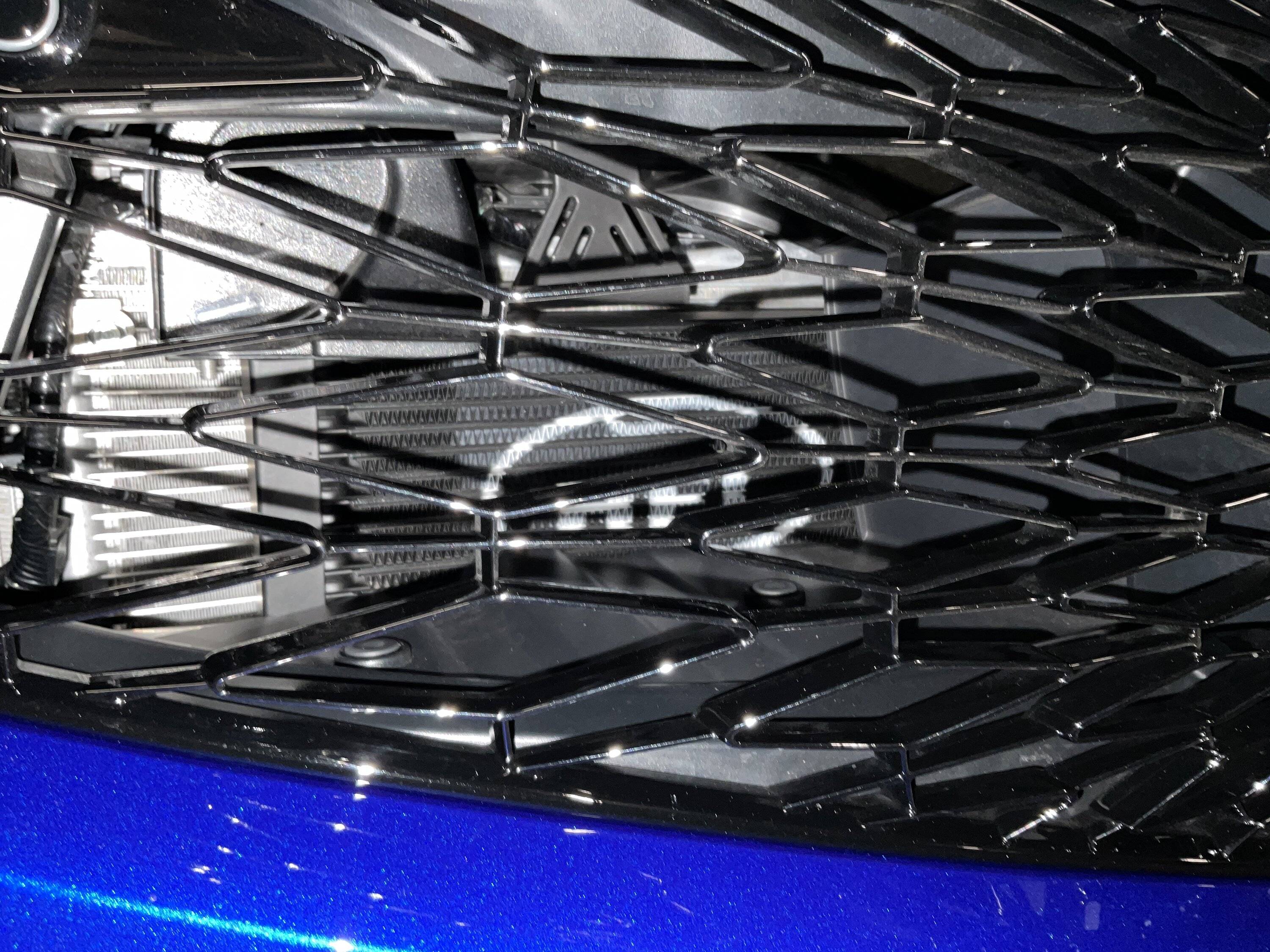

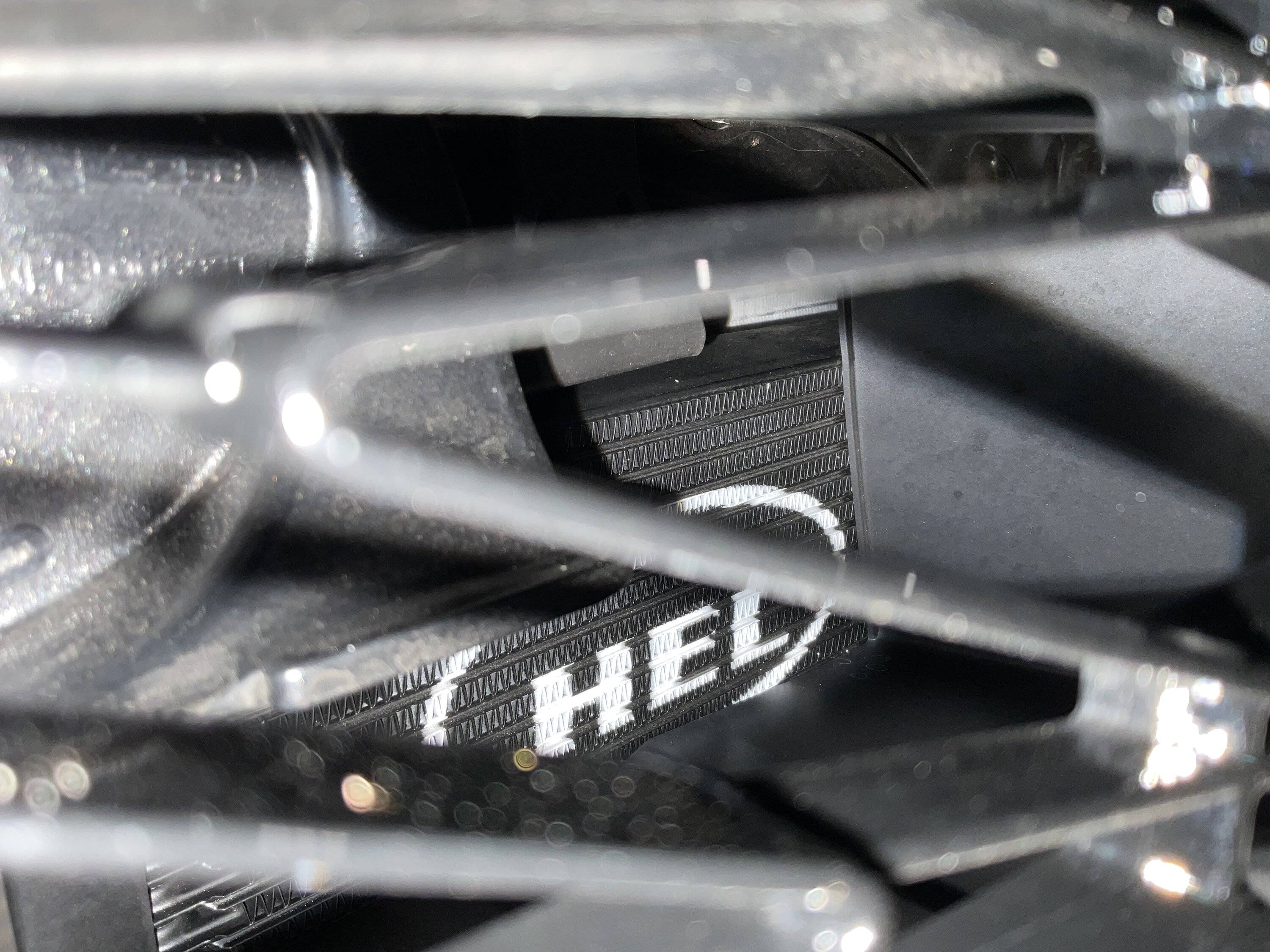

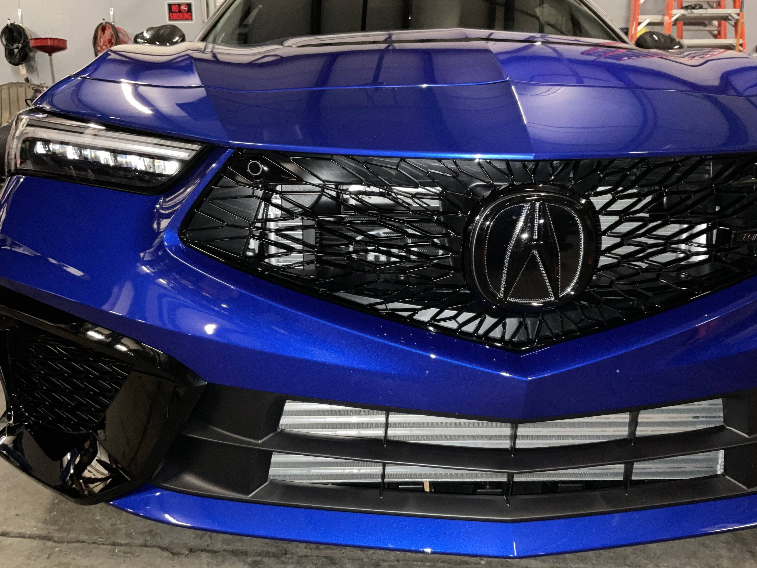

I’m concerned with the top right side of the oil cooler when you’re facing it I’m worried about that rubbing up against the oil cooler what do you guys think? Should I trim it?
Did you ever get an answer that satisfied you? Or, did you go ahead and trim? Have been thinking about picking up the HEL for my DE5.

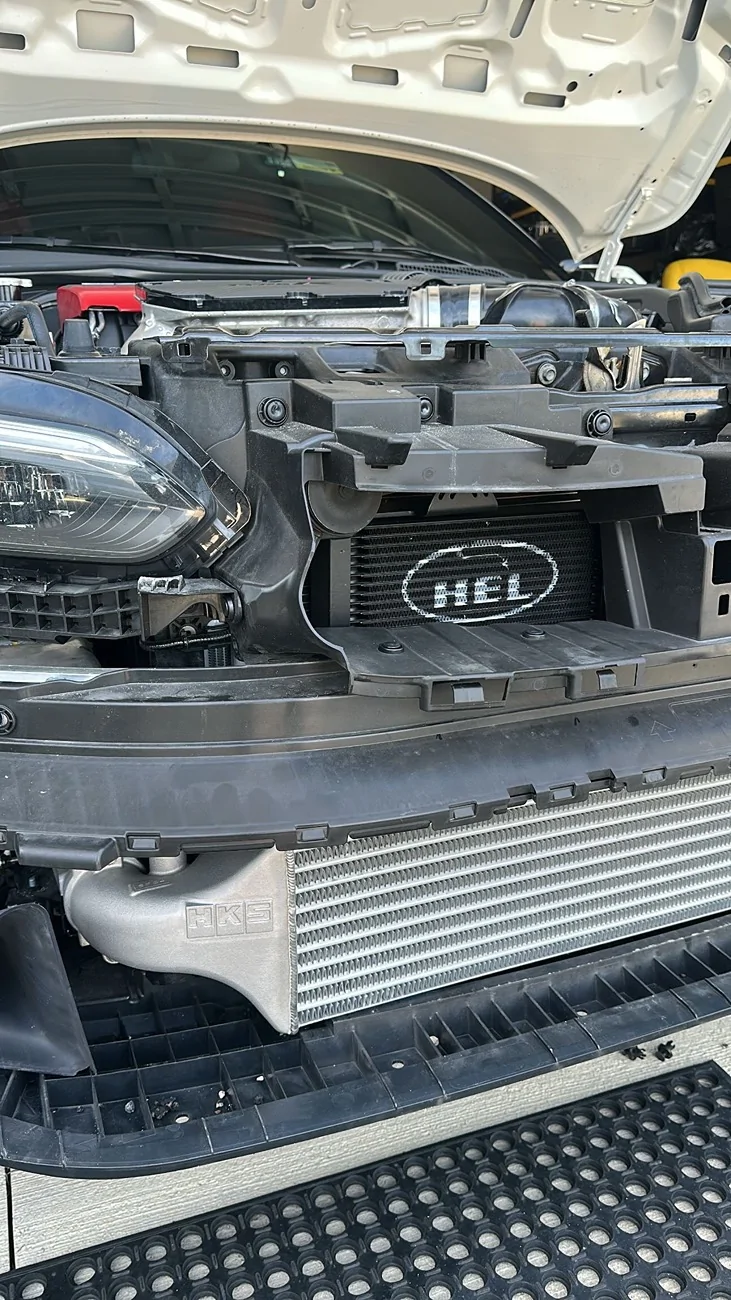

I am running the HEL oil cooler with CSF radiator on my Type R. Went to Daytona last month and it was a sunny / humid 91 degrees out and I experienced no overheating.
I did get close a couple of times the car hit 231 degrees coolant temps at the end of the 140+ mph long straight away.
But by the time I braked and came out of the first turn I was back down to 214 degrees and an inaccurate (310+ degrees oil temps).
I will be installing a AEM oil temp gauge soon to see the “real” oil temp readings as LogR is not a sensor and only a algorithm that doesn’t take into effect my cooling mods.
