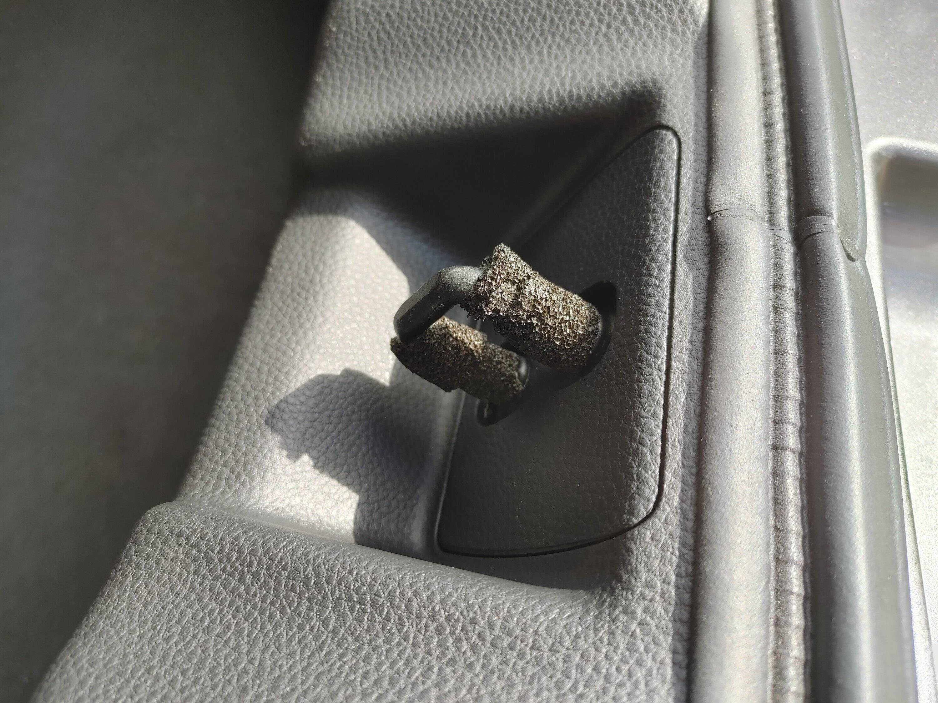

Having to use tape to solve a rattle didn't sit properly with me, so I took the Integra to the Acura dealer to have them resolve it. Naturally, I took my 3M 33 electrical tape off before bringing it there. They diagnosed the latch mechanism as the issue and told me they ordered a new one.
In the meantime, "The technician was able to temporarily resolve the rattling issue by using some tape around the hasp." Wonder where he got that idea? :p ROFL
If that tech from a Louisiana dealer is reading this -- dude, you're awesome as the foam tape you used completely got rid of the rattle. :cool: (vs the 3M 33 electrical tape which only reduced it.)
He applied the foam tape in the location below. Photo as requested
Acura Integra Hatch Glass Rattle Tape

I'm glad to report that the latch mechanism was replaced earlier this week; there are no further rattles.
