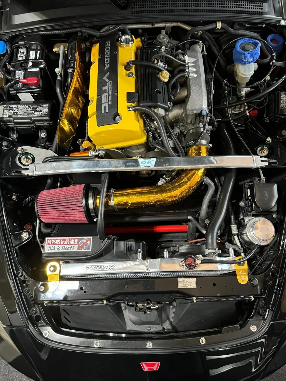

AP1 - This was my masterpiece. I built this from the ground upβ€”every nut, bolt, and bushing was replaced by my own hands. I started with almost zero mechanical background, but thanks to endless YouTube tutorials and community support, I made it happen.

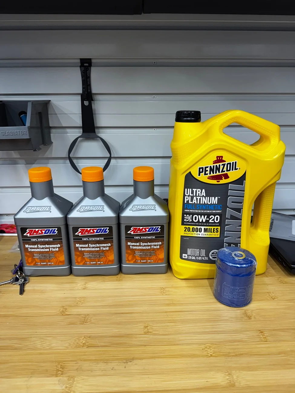

Plate looks awesome!
And Amsoil is good stuff.
However, I would only use Pennzoil in my lawnmower as it's Group III oil. Stick to Amsoil, Redline, or Mobil 1 for true synthetic Group IV. I typically use Mobil since Amsoil and Redline can be expensive.

Yea I ordered AMSOIL engine oil but I didnt realized they’re 1 gallon jugs instead of 5QT so I’m a bit short😬. Next time at 30k Ill switch over to AMSOIL

I'm not a big pennzoil fan, but I will say despite being a group 3, they're a very well filtered and purified 3 that acts like a 4. They're still not ideal if you plan to run any sustained oil temps above 275, but they're good.
Mobil1 is the one that ime thins quickly as it ages and makes its way through turbo gaskets and into the turbo. It was horrendous on my subarus and gti.
Amsoil and redline can genuinely sustain oil temps in the 325 range without falling apart. I've oil tested all of these on my daily and track toys, and the results tend to favor Amsoil and redline most. Liquimoly in the full synth is another that my German cars have really liked. Over 80k miles on my q7 with nearly 30k miles towing heavy (6600lbs typically), and it loves the stuff.
