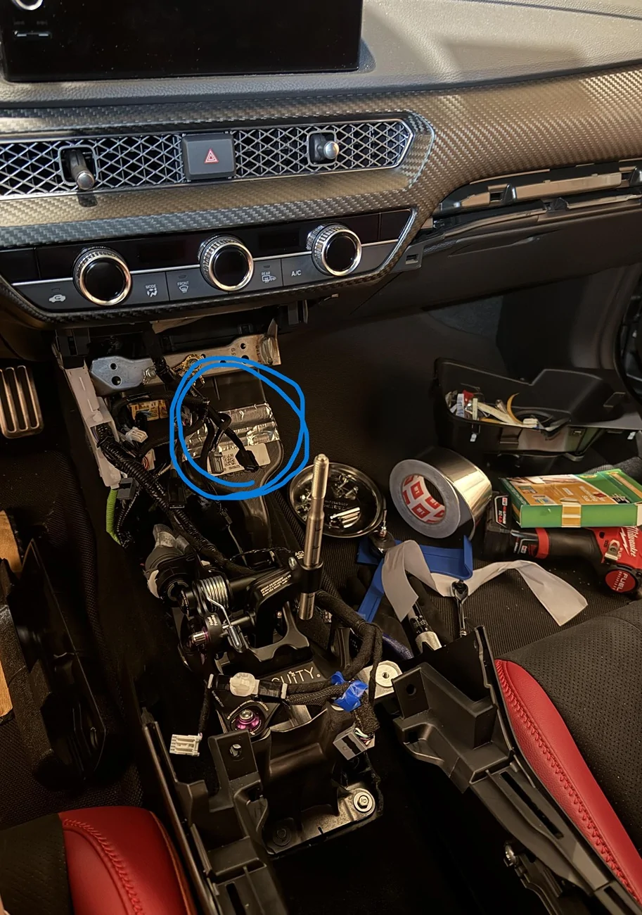

Installed my acuity shifter the other day. While I was in there, I fixed the rattle I had around 4-4.5k rpm coming from the center console in the passenger side vibrating all the way through the drivers side by adding foam and taping the duct. It seems like the FL5/DE5s are plagued with this issue and I figured y'all would be interested in the fix for it.
Materials needed:
  1. Foam weather stripping tape
  2. Aluminum tape for ducts
Instructions:
  1. Take apart the center console see acuity docs or videos online for shifter or rear vent install
  2. You will notice that the duct connector that routes air to the center console down to the rear floor was very loose. Take that connecting piece and put it aside.
  3. Stick weather stripping around the outer edges of the top duct. Do the same for inner edge of the bottom duct. (I had to split the weather stripping tape in half because it was too thick, you might have to do that too in order to get the plastic connector piece back in there)
  4. Place the connecting piece back in. It will be tight but should feel very snug after doing so.
  5. Wrap the top duct and the connecting piece around with aluminum tape.
  6. Done. Feel that it’s snug and it should be good to go
This completely eliminated the rattle I had around 4-4.5k rpm rattle.
Materials needed:
Instructions:
