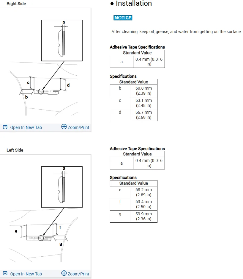

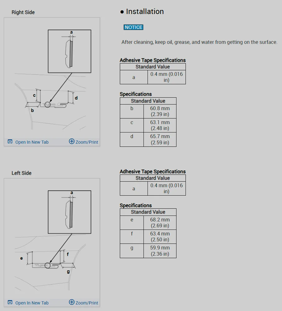

kristobel New Member Joined Jul 17, 2025 Threads 2 Messages 4 Reaction score 2 Location San Francisco Car(s) 25' LSM ITS Sep 30, 2025 Thread starter #1 Hey all, Got some ppf done and they removed the Type S emblems on the fenders. I was wondering if someone could measure theirs so I can double check mine are correctly placed. Thanks! Sponsored

OP OP kristobel New Member Joined Jul 17, 2025 Threads 2 Messages 4 Reaction score 2 Location San Francisco Car(s) 25' LSM ITS Oct 1, 2025 Thread starter #4 acurax said: Click to expand... Awesome! Thank you so much!

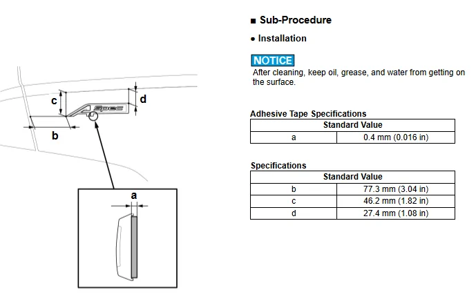

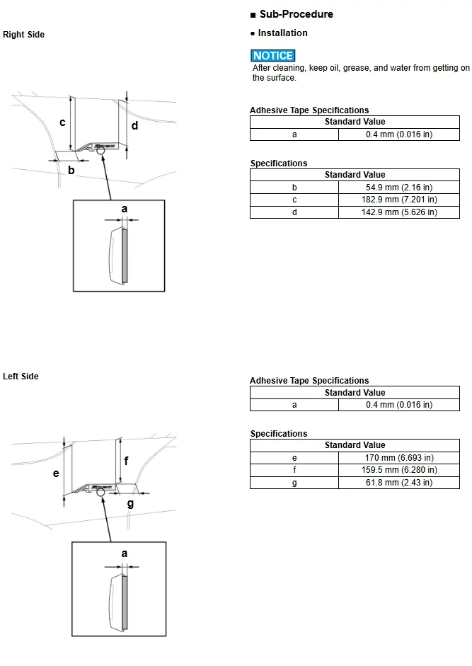

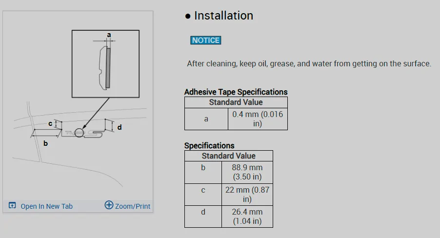

4Dparadox Member Joined Jan 23, 2025 Threads 1 Messages 41 Reaction score 8 Location NY Car(s) Integra Aspec/Tech Manual Jun 23, 2026 #7 Anyone got a template for the a spec emblems?
acurax Senior Member Joined Mar 3, 2022 Threads 0 Messages 259 Reaction score 94 Location USA Car(s) 2024 Acura Integra Type-S Jun 23, 2026 #8 4Dparadox said: Anyone got a template for the a spec emblems? Click to expand... Here you go...
4Dparadox Member Joined Jan 23, 2025 Threads 1 Messages 41 Reaction score 8 Location NY Car(s) Integra Aspec/Tech Manual Jun 23, 2026 #9 acurax said: Here you go... Click to expand... Thank you! I got it pretty close before seeing this post.

juan23.fm New Member First Name Juan Joined Sep 5, 2026 Threads 0 Messages 1 Reaction score 0 Location @1234And5 Car(s) 2025 Integra Type S Saturday at 7:27 AM #10 acurax said: Click to expand... Would you happen to have the one for the rear "Type S" emblem? Sponsored
