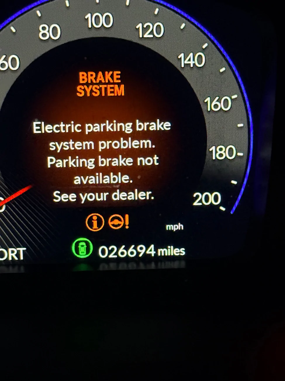

I changed the rear brake pads and rotors after putting the epb in maintanance mode and releasing it from maintanance mode after the job. I ensured that I listened to the parking brake motor wind out and back in the maintanance mode, which helped compressing the piston with minimal resistance. However the electric parking brake is showing the following error messages: "Electric parking brake system problem. Parking brake not available. See dealer". Tried recycling multiples times, but to no avail. I would hate to take it to the dealer, so please help!

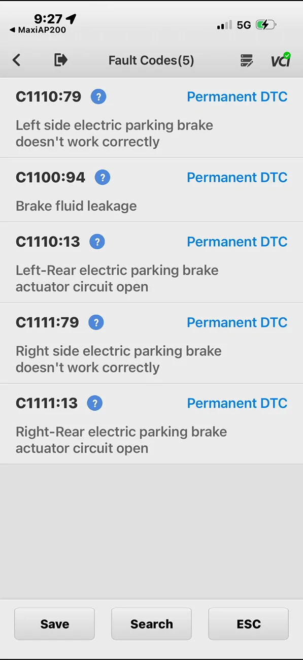

Here are the codes that are triggered.

When you took them out of maintenance, you did get the success notification right? And you cycled the parking brake a few times?
That error and codes are saying they don't see the brake caliper epb as serviceable and that happens when they're disconnected or still in maintenance.

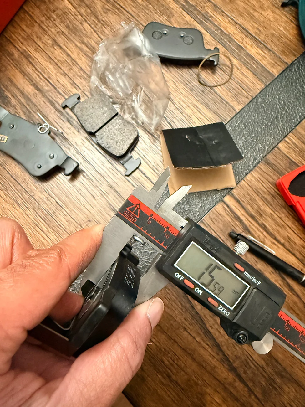

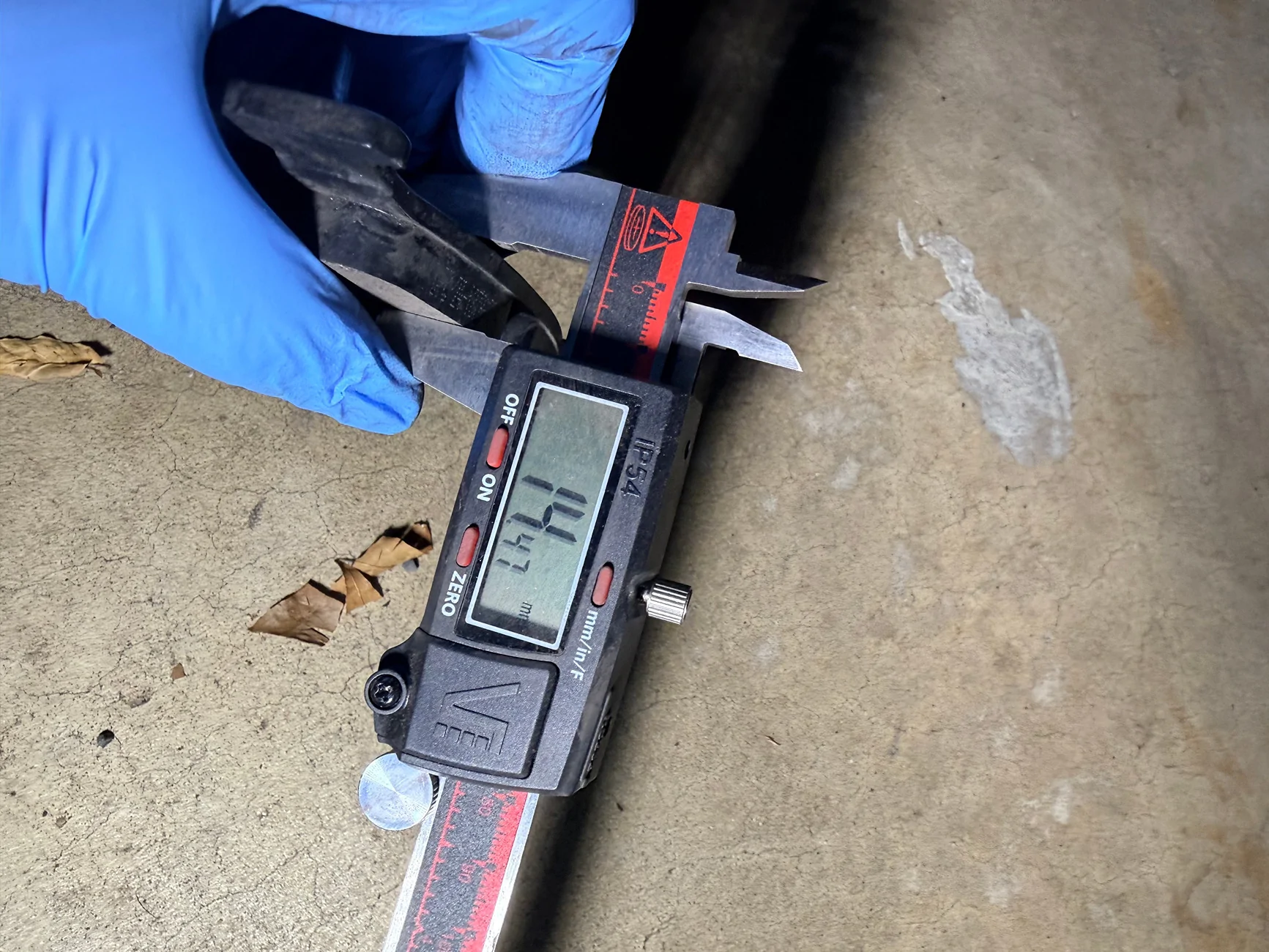

Finally figured out what the issue was. I had my hunch it was not the epb actuator or connector.The pads were not 14.5 mm as advertised, it was about a mm thicker due to the shims. Took out the shims and sanded it down couple 10ths of a mm till it was closer to 14.5 mm. When you add the thickness of both shims and sanding, it comes to about 2mm. Immediately noticed that the calipers slide in easily and there was more play. Hopefully removing the shims wont create problems down the line!
FYI, I used the R1 concepts discs and pads from Rock Auto. https://www.rockauto.com/en/moreinfo.php?pk=14174753&cc=3454950&pt=13824&jsn=430
