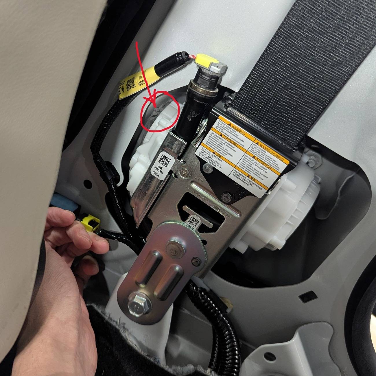

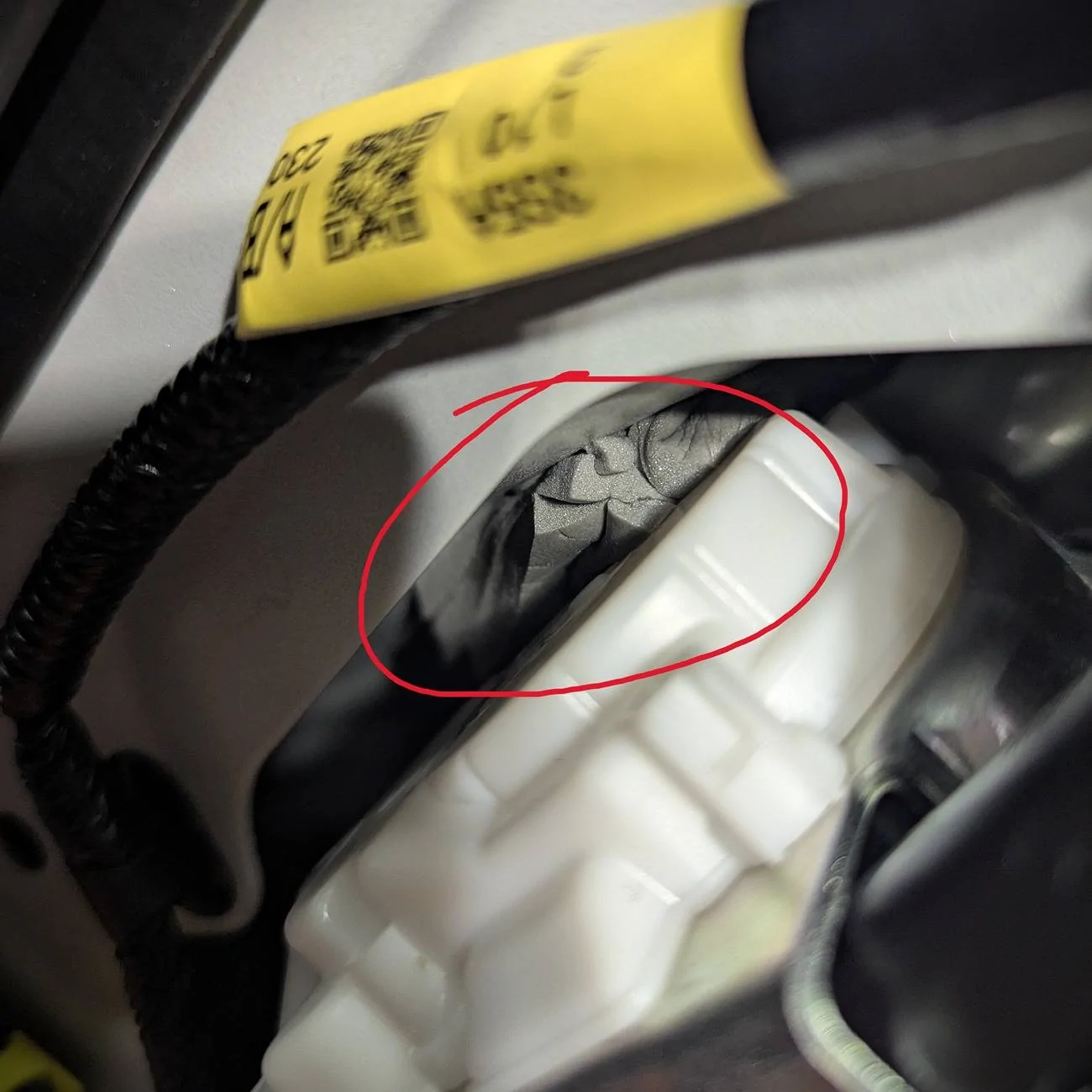

My second rattle has always been around, but I haven't been able to track it down. I know it was coming from the passenger-side b-pillar, but I couldn't pin down the noise. A few trips to the dealer with no fixes and I gave up.... Until today.
The rattle sounds like a spring resonating in harmony with the engine. It's only noticeable when revving the engine over 4k RPM. This specific rattle wasn't triggered by speed or road surface.
I did some more research into this and apparently this is a common issue on both 11th Gen Civics and 5th Gen Integras. Someone posted a YouTube video which captures the rattle on camera perfectly, and provides the location.
My rattle comes from the passenger seat belt retractor. When percussed it resonates, likely because of the spring inside of it. I found that by simply placing a finger on the plastic housing, the sound was mitigated.
I didn't really agree with the solution the video-maker provided -- I'm not keen on loosening seat belt bolts or messing with an SRS mounting point. Also, at the time of writing this, I don't have sound dampening material like butyl rubber on hand, otherwise I would have tried that. Instead I have some foam tape. My solution was to wedge a big wad of sticky foam tape in-between the pillar and the retractor.
Here's the fix:
  1. Remove the bottom piece of trim on the passenger side b-pillar. You won't need to remove the top piece.
  2. Take a piece of thick foam and wedge it between the plastic housing and the metal of the pillar. Ensure it won't migrate. You may also try butyl rubber here.
  3. Reassemble.
Acura Integra Documenting my rattles and squeaks, and how I fixed them fix-1
Acura Integra Documenting my rattles and squeaks, and how I fixed them fix-2
And the results.
