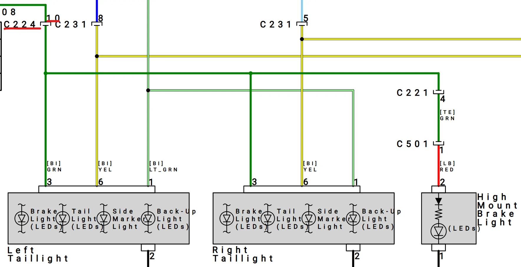

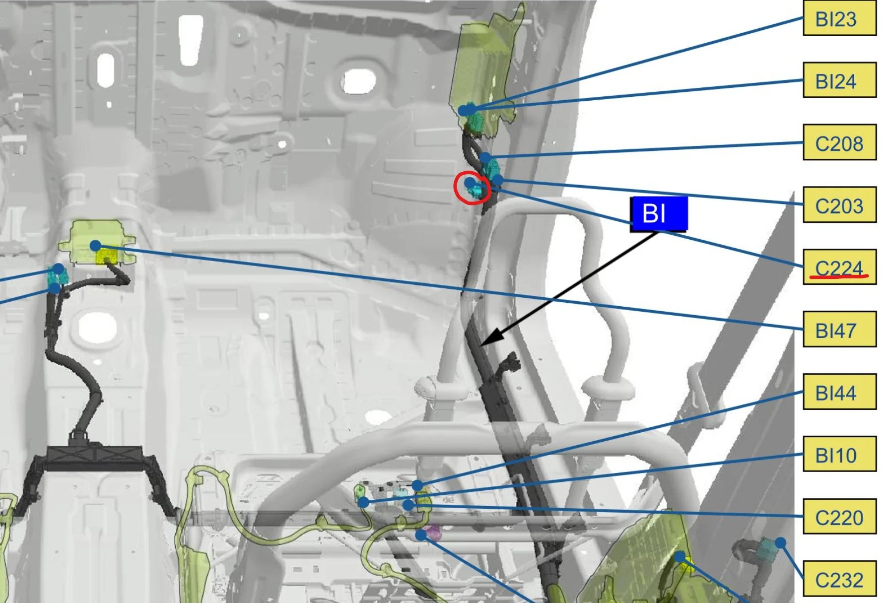

So, looking at the wiring diagrams, it looks like you may be able to tap into the brake light signal wire for all brake lights on connector C224, position 10, which is located behind the passenger side footwell kick panel. I confirmed this the same across all trims for 2024. Which might be easier than installing at the high mount brake light location. Take a look at these images and let me know if that's accurate or if more information may be needed to confirm.

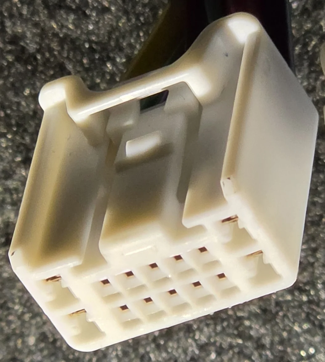

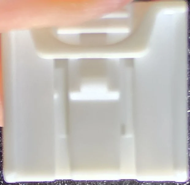

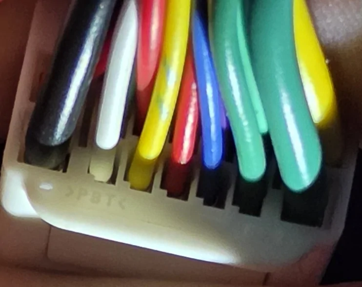

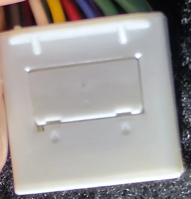

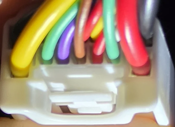

That would be very nice! If you could PM the connector photos or part numbers, if you have a way to get that? I’m really curious to see what connector it is, and if it has both power and ground, as the diagram only seems to have 1 and my module requires both.
So after looking at the diagrams there are some important things which use that same connection, i.e. wheel speed sensors (RED/YEL, LT_GRN/WHT), parking brake actuator (YEL/GRN, RED/BLK), EVAP Canister Vent Shut Valve (LT_GRN/PUR). Even though those would just pass through, I'm not sure how finicky they may be. There's one wire that I have yet to locate in the diagrams.
