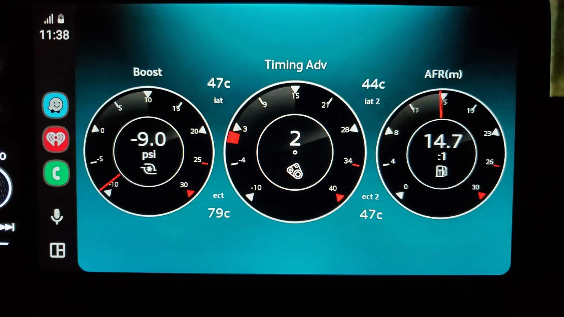

This is what I came up so far... with help from other users we could get all the pids we want but I don't know as of now how to get more... I would like to extract knocks and oil pressure...
May I recommend you start a thread for just this? Pretty cool and I think deserves some dedicated attention. :)

Thanks a lot! but nothing more to add I think, knocks and oil pressure are not available on the obd2 from the bosch ecu so the data/dashboard I came up with are all normal honda pids values. Unless a bosch wizard found a way to get more! o_O
