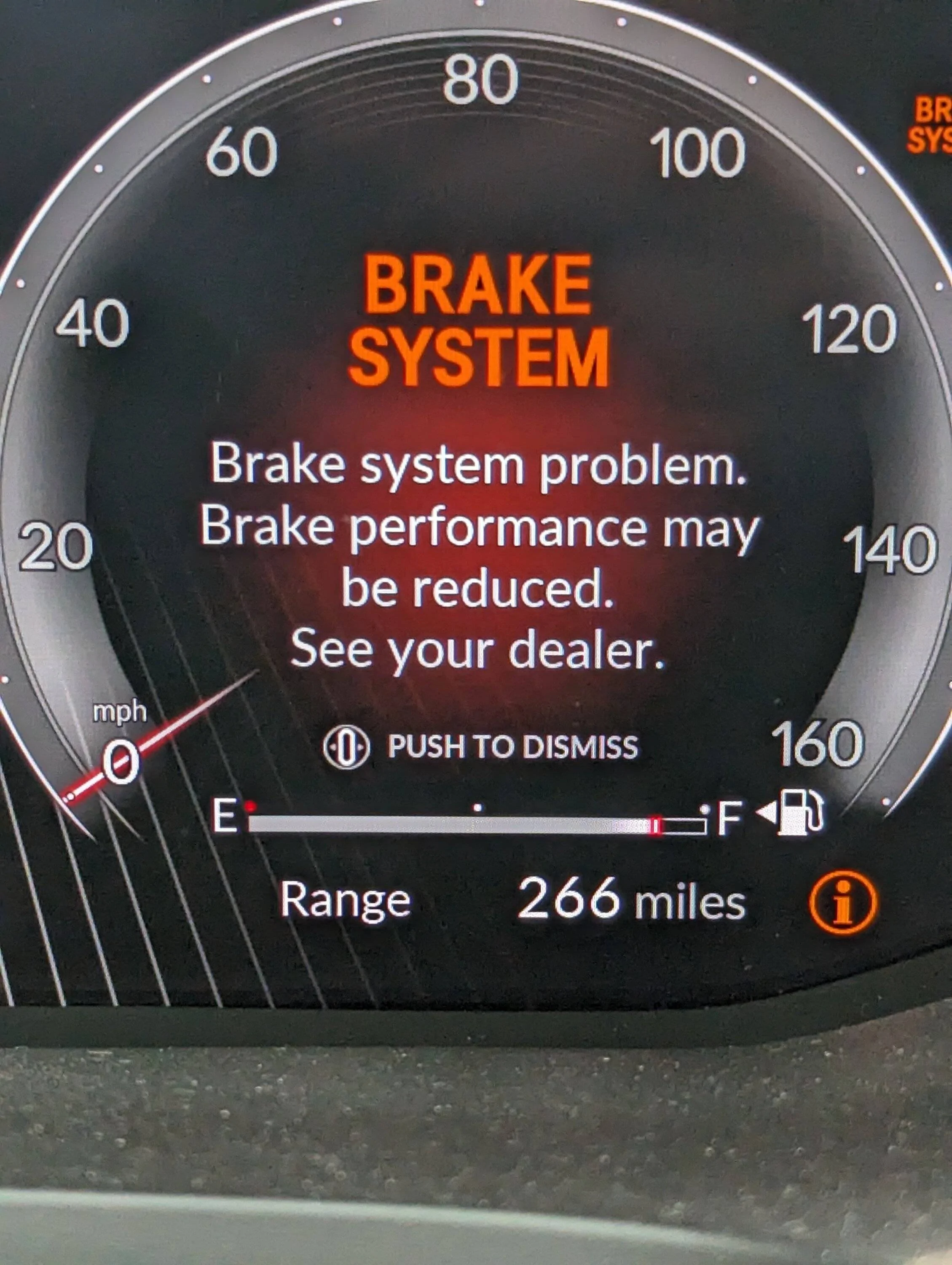

Jude
Jude
Jul 16, 2023
U.S. - Ohio
2023 Acura MDX Type S
Sigh.

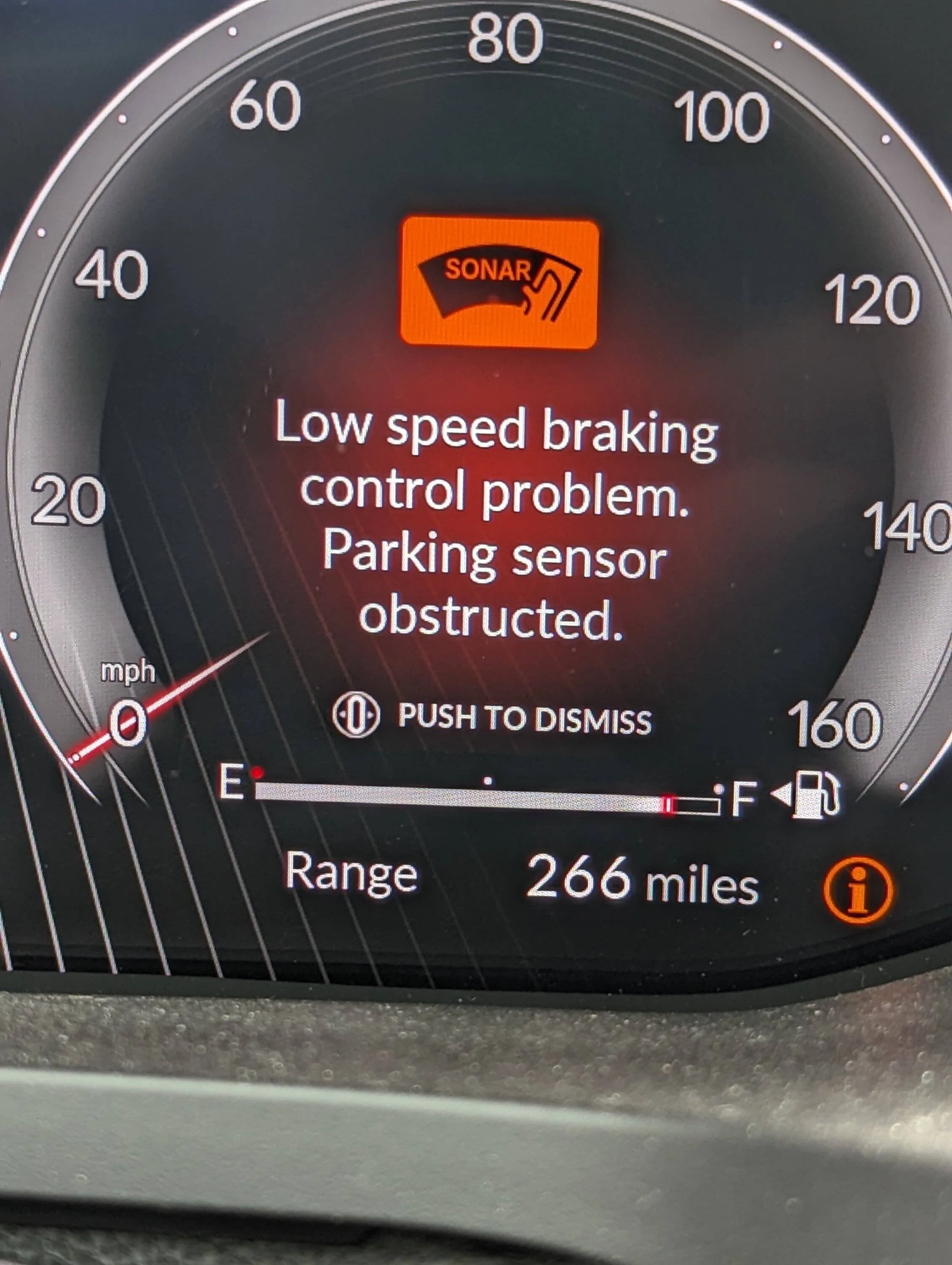

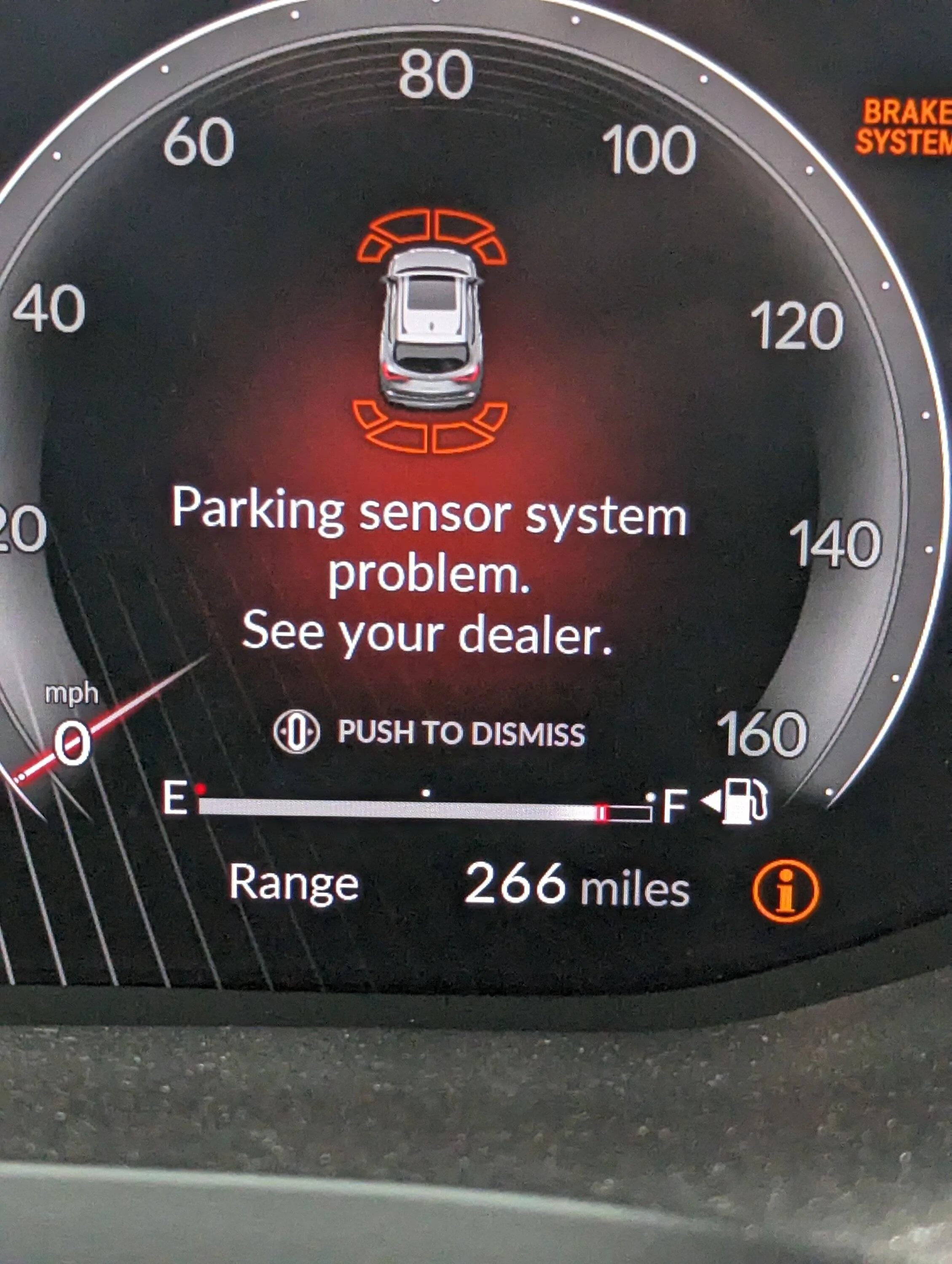

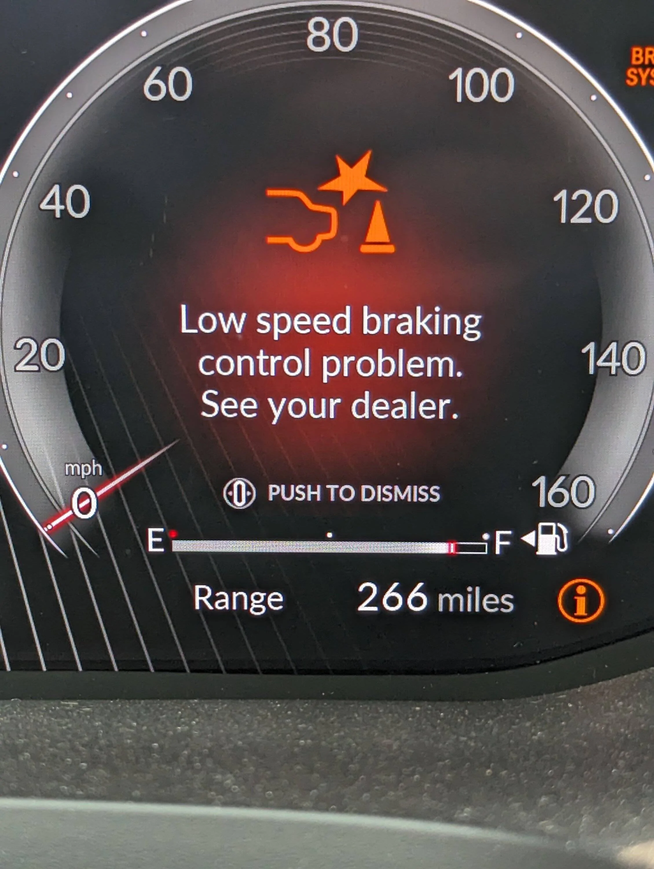

2023 Acura MDX Type S. This started two days ago out of the blue.
Acura Integra Brake System & Parking Sensor Errors PXL_20230716_173705087
Acura Integra Brake System & Parking Sensor Errors PXL_20230716_173655537
Acura Integra Brake System & Parking Sensor Errors PXL_20230716_173654379
Acura Integra Brake System & Parking Sensor Errors PXL_20230716_173629699
Did you get a chance to get it into the dealer yet?
I hope being the flagship model they put the right amount of priority on it.
Jude
Jude
Jul 16, 2023
U.S. - Ohio
Scheduled for next Tuesday to diagnose. The service guy on the phone seemed unsurprised. He said, "Most likely a failing rear parking sensor. We just have to determine which one and order the replacement."

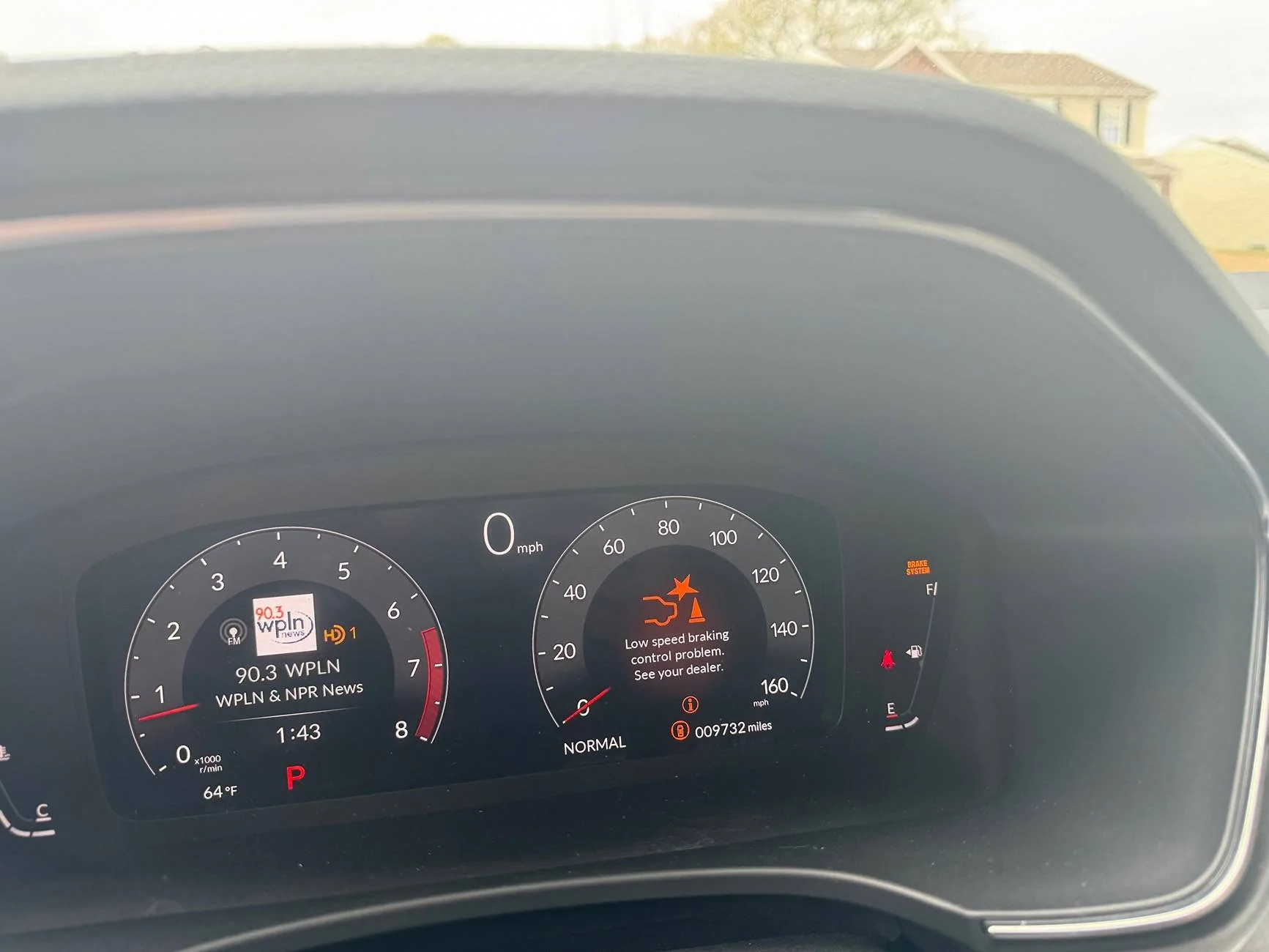

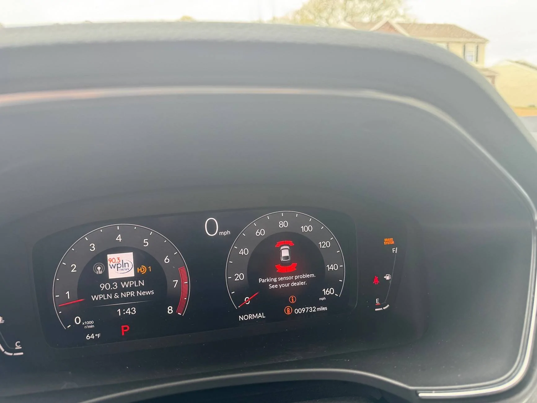

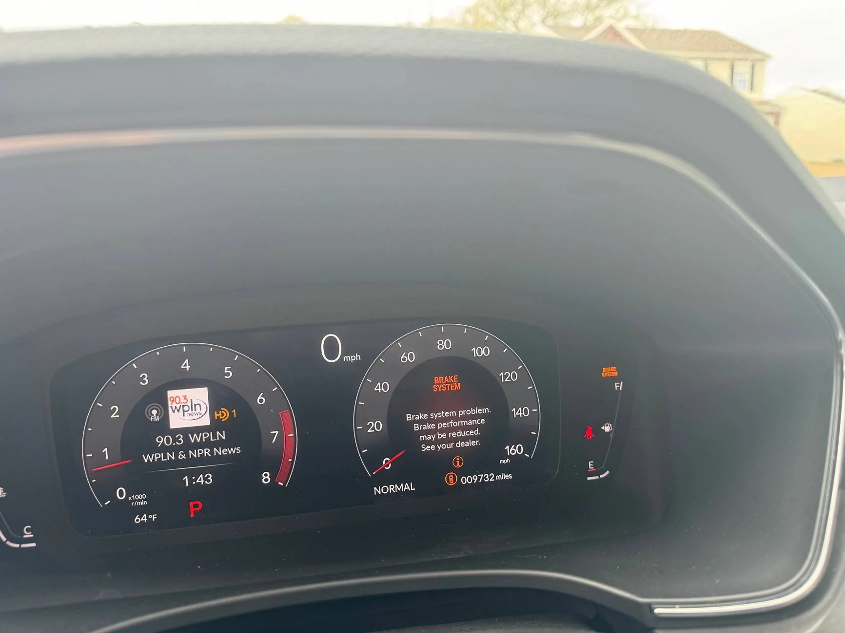

Well now I’m getting all of these warning popping up. I have a nice scanner and it’s not pulling any distances on my parking sensors except front sensor temporary failure value 192 and same for rear. Any ideas?
Acura Integra Brake System & Parking Sensor Errors IMG_1979
Acura Integra Brake System & Parking Sensor Errors IMG_1978
Acura Integra Brake System & Parking Sensor Errors IMG_1977

Did you end up getting an answer on this?
