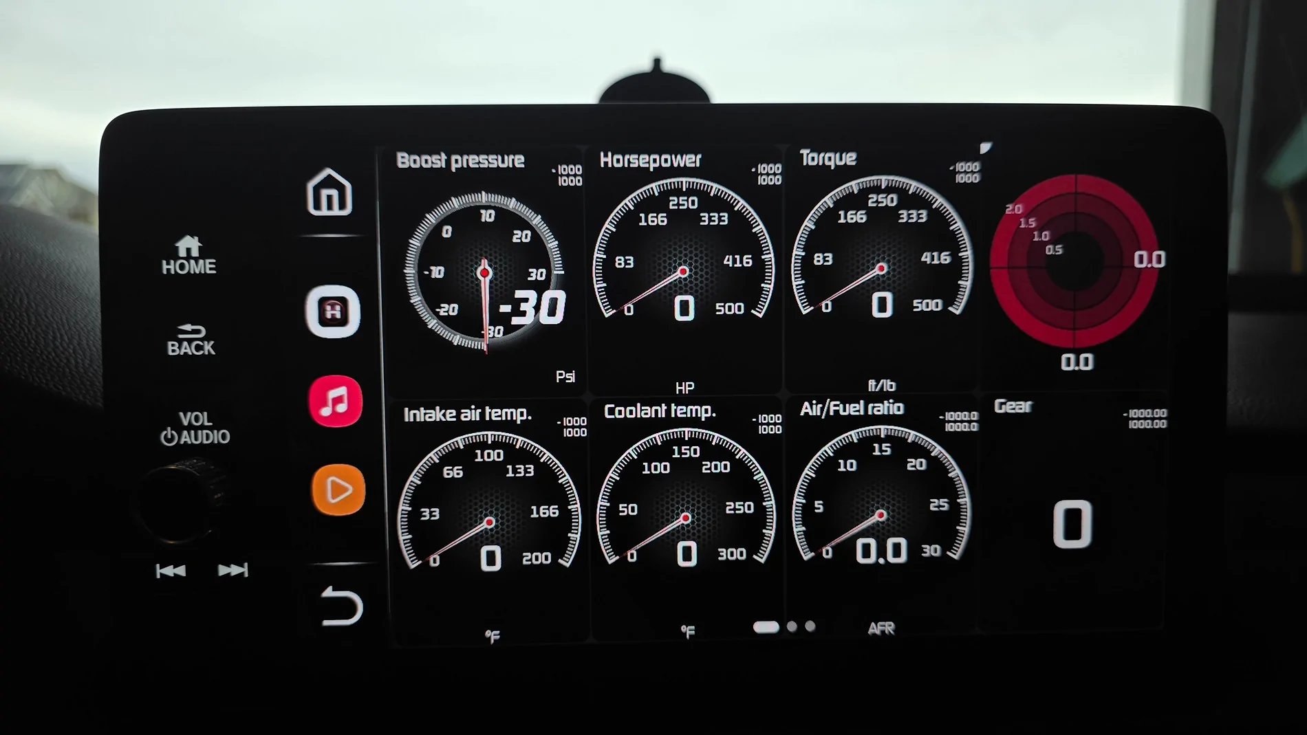

Follow-up: DE5 "S-Log" via Hondata & Autolinkr (got it working).
Watch the YouTube videos below first for information & installation instructions of the Autolinkr,
then watch my video below for connection instructions. I can also verify, the mobile Hotspot is not necessarily for Hondata metrics transmission.

I see no reason to. I did try to pull from my Autel but no success. Just gauging input to eyeball the data is true to inputs. I.e. it is as fast as data receipt within the Hondata phone app. I cannot use both the Autolinkr & phone app or I'd try. This is good eyecandy, can't really watch it if I'm really driving.

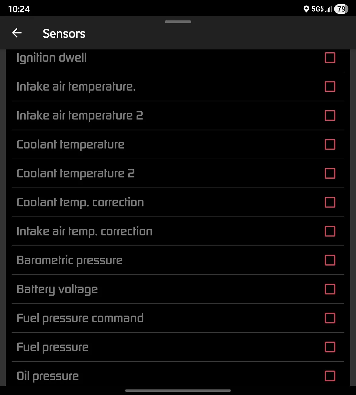

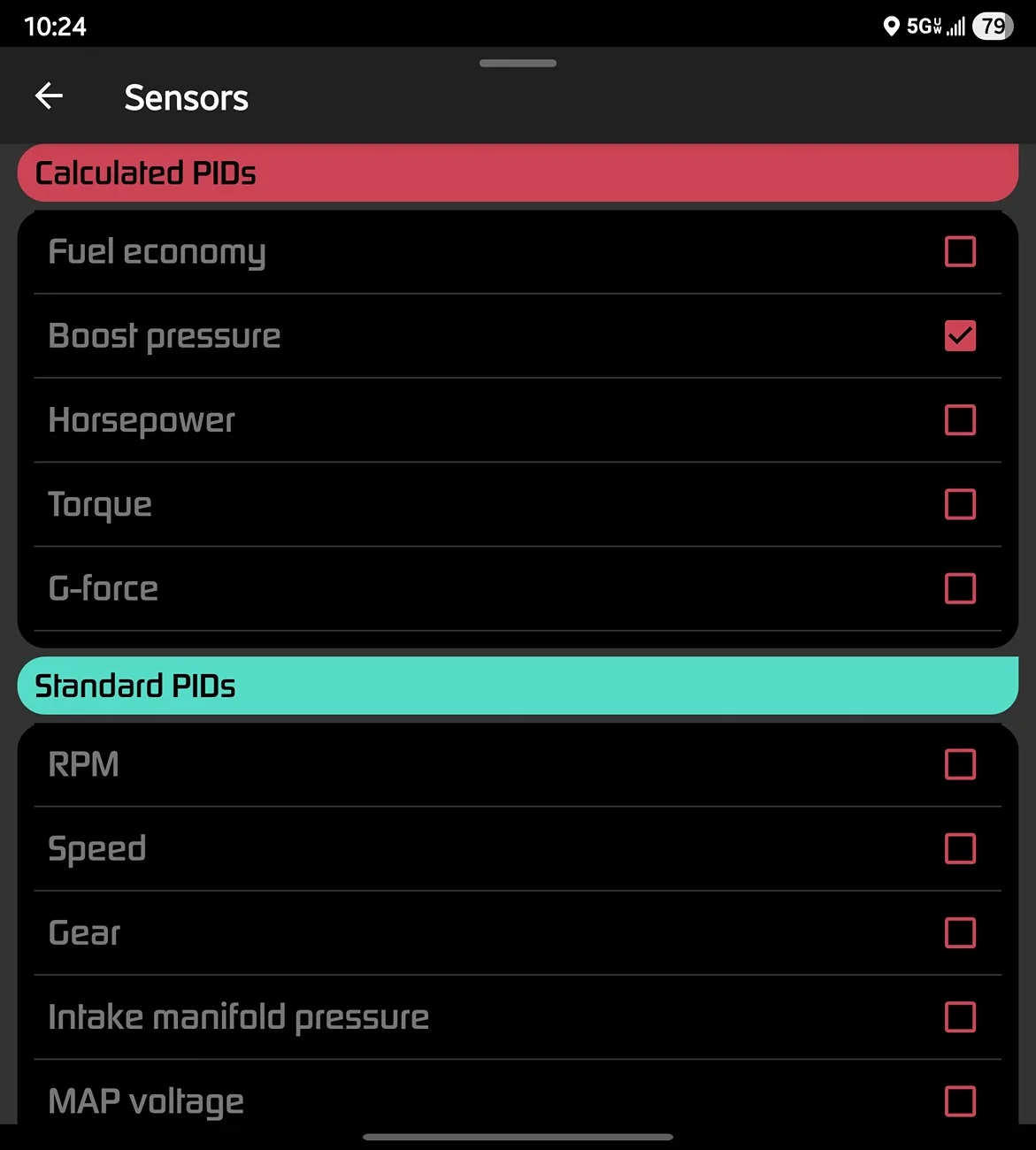

I also discovered yesterday that the Autolinkr to Flashpro connection is good without wifi, just BT. That mean only one "wireless" data stream. The Autolinkr is wired. My phone is not a part of the equation (originally I thought the wireless data for my phone had to be active).
1,836
1,293

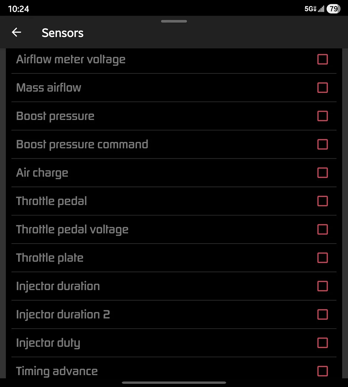

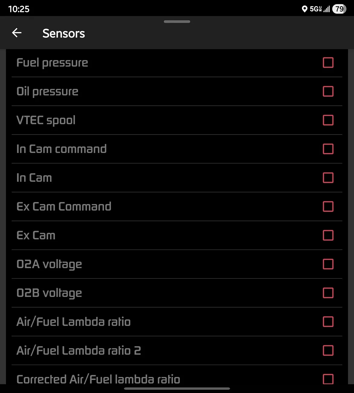

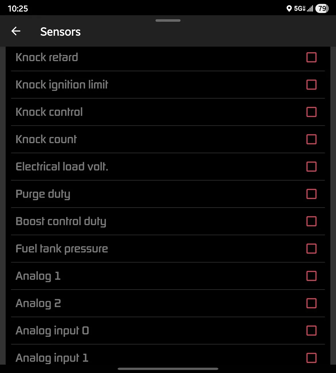

For me the benefit was that my camera is mounted behind me (to see my inputs and the course) so having it on the display is ideal to review later. I really wanted to get throttle position, boost, steering angle, brake position, iat up there. The Honda canbus is NOT making it easy for me to get this data into a nearly real-time feed.
Does hondata give you any of those PIDs? I know they exist, but I'm having a very hard time pulling many of them consistently/reliably.
1,836
1,293

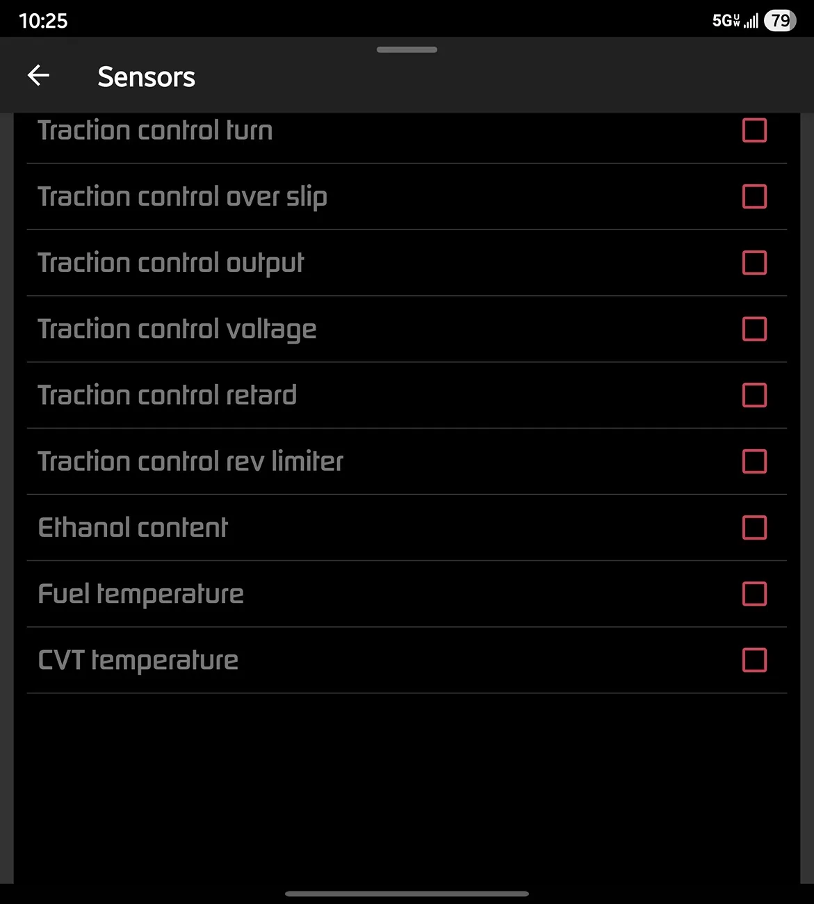

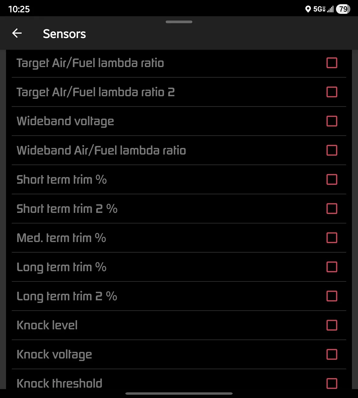

Thanks! That's very helpful.
That's what I've been able to find as well. Sadly no brake position or steering position, which are two of the most important things for post track review... Or oil temp, but we won't go there today šŸ˜’
I'm excited to see how real time yours is! Good way to see would be if you can get throttle position up and check the response when you rev it.
