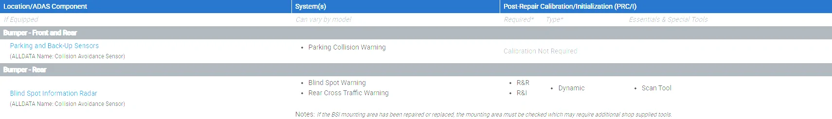

If they are removing the front/rear bumper to apply PPF, then the sensors were more than likely unplugged. I would think this is uncommon for clear PPF, but a colored wrap, which is also PPF, would be more likely to have this done. In either case, here's the A.D.A.S. calibration requirements for the front/rear bumpers. For insurance reasons, i.e. CYOA, they must follow these requirements.

Right on, I’m giving them a call later today and gonna ask about the bumper/sensor removal.
