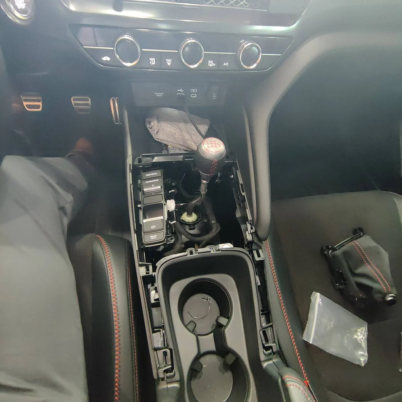

Did you have any trouble driving around while the piece was off getting stitched?
No troubles on my end, just be sure to keep the drive mode switches off to the side and the wire harnesses out of the way of the shifter. I had mine out while I was doing the Hybrid Racing short shifter.
Drove around this for about 3 days.

You should not have issues, this is the upper boot to prevent loosing things like Legos and coins into the center console. When it's off be sure not to drop small. There is another shift boot that the shifter goes through to under the car, that boot you are not removing, just the nice leather boot and trim.
You will want to reconnect the switches on the left of the panel, you are not sending those in, you can simply re plug them in and they will work mid air, not ideal but will be fine. I have seen and done a lot more weird things building hot rods, this is just an inconvenience for a few days.
