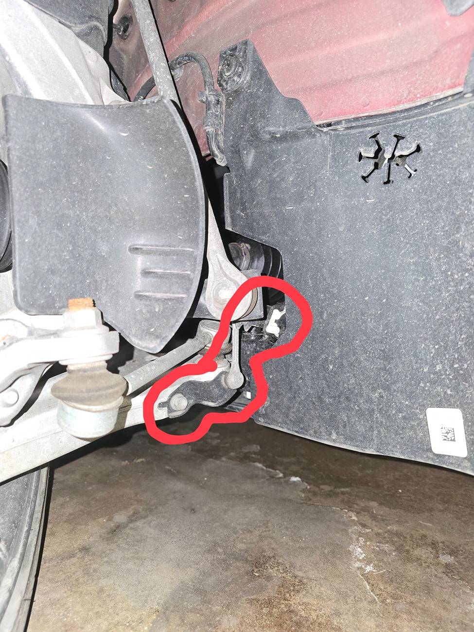

Can you confirm the Integra Type-S has level sensors? My understanding is that only the MDX Type-S has such level sensors due to the air suspension. Since my wife has one, I looked into it. They make shorter aftermarket links that will trick the car into a lower stance.
Based on what I’ve seen, the Integra (in all trims with ADS) just uses electric current to change the damping characteristics of the shock. This leads to a different feel from comfort to Sport.
Correct me if I’m wrong.
1,854
1,302
Sure thing! Here's a photo of the one on my car circled in red.

Also, air suspension will be different from electronically valved shocks. Air is a bit dumber and doesn't have a compression curve because it can't change pressure so quickly. It sets static ranges in the bag and changes based on preset values like steps.
Electronic "adaptive" suspensions have a preplanned curve where the valve is moved as changes occur to impact both compression and rebound. Simply shortening the arm on the sensor can change your static range, but the range of compression and rebound can be negatively impacted, especially at full compression or full droop. It would be a risky change without seeing the actual curve values... Risky in the safety sense due to the resulting dynamic balance.
