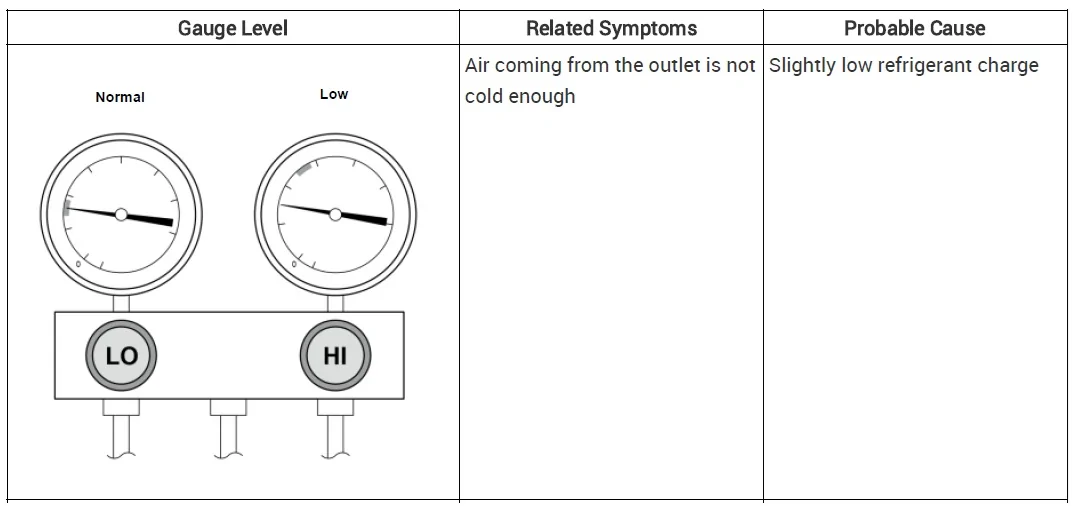

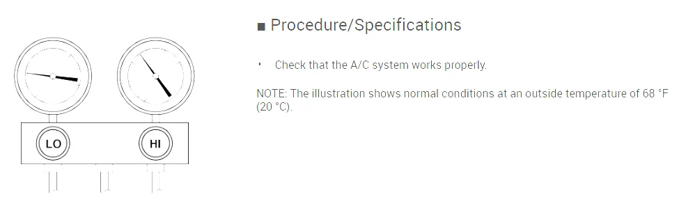

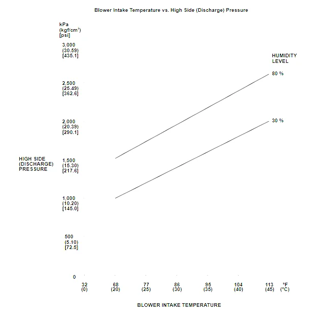

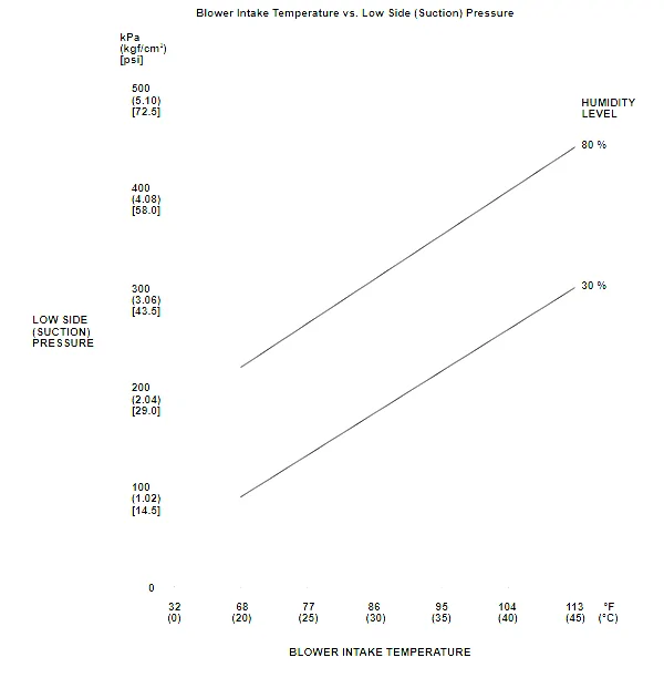

If all appears good, then you can move on to the temp and pressures. Since you've already taken a pressure reading, I'll post those images first. These are all for the non-Type-S since your profile indicates you have an A-Spec, but if that's incorrect I can swap these for the Type-S graphs.
Acura Integra AC not very cold Screenshot 2026-07-23 105229
Acura Integra AC not very cold Screenshot 2026-07-23 105243
Acura Integra AC not very cold Screenshot 2026-07-23 105351
Use the graphs to determine what the correct high low ranges are based on your outside temperature.

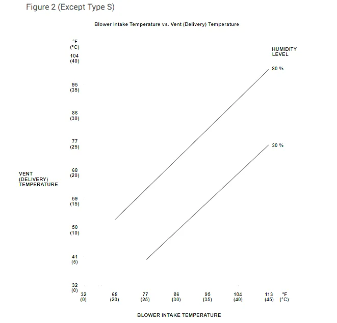

If that all checks out, then you could check the air temp entering and exiting the system against this graph.
Acura Integra AC not very cold Screenshot 2026-07-23 105200
If the temps are not within the correct range based on the graph above, then it's likely best to have it checked at a dealer, if under warranty, or a trusted shop. They should be able to safely measure the volume of the refrigerant which would decisively tell you if there is a leak. If the volume is below spec, they can then do a leak test to find it and tell you exactly what needs to be replaced to fix it. You can still decide to just pump refrigerant in as it gets low, but it's possible to put too much in which will have the similar result as not having enough.

Thank you for the graphs, and yes, I have the A-Spec.
According to the graphs, the low is just barely within spec and the high is low.
Sounds like I just need add just a bit of refrigerant.
