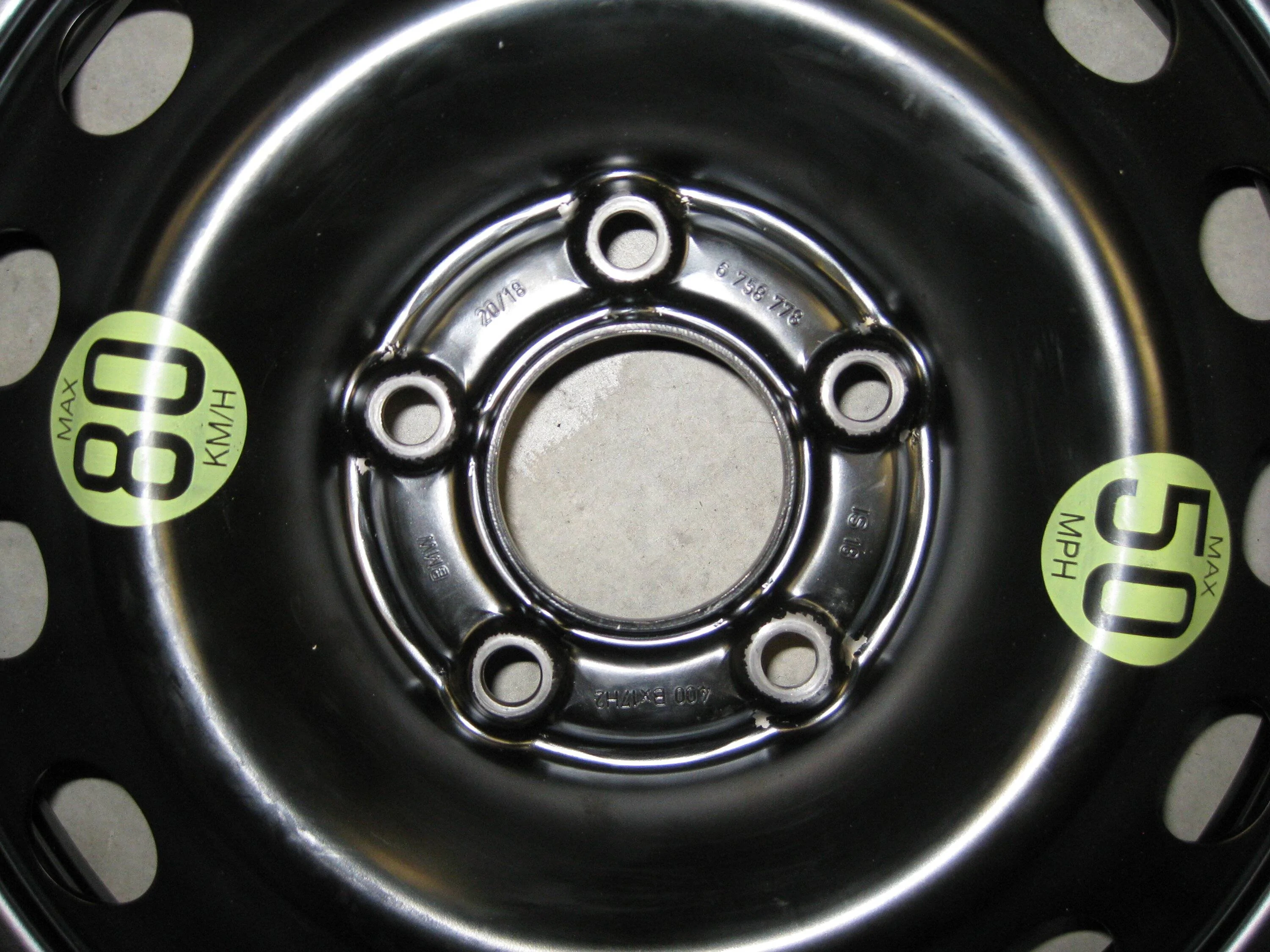

Yes, this is absolutely correct. Sorry to stir up so much worry on this subject - It's not as bad as I may have made it sound. The #1 takeaway is DON'T JUST PUT THIS WHEEL ON WITH YOUR OEM LUG NUTS AND TORQUE THEM TO 80+ FT-LBS - THE WHEEL MAY GET STUCK ON THE STUDS.
So here's the problem: The BMW lug bolts are 12mm and the surface that seats against the wheel (at a 60 degree angle) narrows all the way down to 12mm at the bottom. So the lug nut seats on the wheel are quite small in diameter. Our ITS wheel studs are M14 x 1.5, so the narrow part of standard M14 x 1.5 60 degree conical lug nuts are too big in diameter to fit into those small lug nut seats.

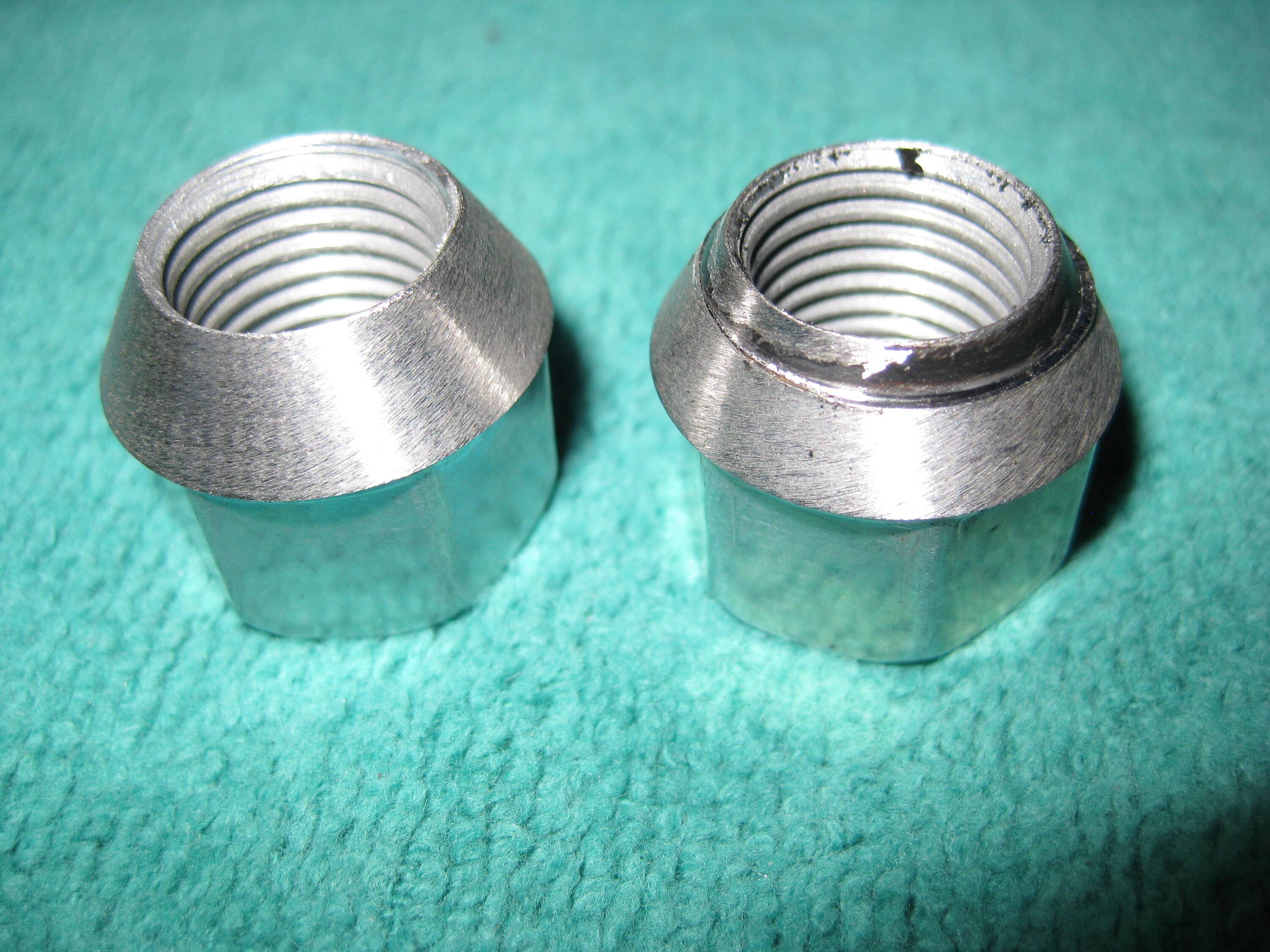

Here's a "solution" that didn't work: So why not just get M12 x 1.5 lug nuts and tap them out to M14 x 1.5, or machine down the conical surface of M14 x 1.5 lug nuts to the diameter of M12 x 1.5 lug nuts. I chose the latter. Here's what happened when I torqued them to 80 ft-lbs:
These are before (L) and after installation (R). You can see the nut on the right has a groove near the top and is squeezed down above that, causing the threads inside to be pinched down against the stud. That made them hard to remove. Thankfully the studs had plenty of anti-sieze on them. This happened because at the pointy end of the lug nuts (where it engages in the seat) the material is just too thin and deforms (shrinks) as it is forced down into the cone of the seat.
Next I tried using M14 x 1.5 Flange Nuts that are flat on the back, as explained in my earlier post. All seemed fine with this solution until the torque got above 50 to 60 ft-lbs. I sensed a little too much rotation for too little increase in torque, indicating something was deforming (if you've ever broken a bolt or stud while tightening, you know this feeling). So I decided to remove and inspect, and found one of the holes in the wheel had begun to deform around the wheel stud. Imagine if I hadn't stopped then to inspect - That would be bad.
So if you take this path, be sure to ADD SOME EXTRA CLEARANCE in those holes, torque the nuts carefully and progressively and remove and inspect as you increase the torque incrementally. I was able to successfully and repeatedly torque the M14 x 1.5 Flange Nuts to 70 ft-lbs, but above that I was concerned about additional deformation of the wheel. Here's what the lug nut seats look like after installing the Flange Nuts:

So next I tried what I probably should have started with - Using the OEM spherical seat lug nuts. Using the same procedure described above, I torqued these to 70+ ft-lbs without additional problems. Since I had already pre-flattened the lug nut seats with the Flange Nuts and opened up the clearance on the holes, this went pretty smoothly. But if you are starting with "virgin" wheels, I'd imagine that you may experience similar distortion in the lug nut seat area and tightening of the holes that I did when installing the Flange Nuts. So my advice is to be sure to ADD SOME EXTRA CLEARANCE in those holes, torque the nuts carefully and progressively and remove and inspect as you increase the torque incrementally. Let us know how it worked for you. I will continue to monitor this thread and answer additional questions and concerns as best I can.

Re: #1 Be sure to use a hub centric ring to center the wheel properly, so you are not counting on the wheel studs to do that. IMO (as a degreed mechanical engineer) any nut that provides adequate clamping force and doesn't come loose should work.
Re: #2 That's why you proceed cautiously when torqueing for the first time. Subsequent installation at the same torque should cause no additional deformation.

As delivered, the holes in the wheel are just barely big enough to allow 14mm studs to fit through. Any distortion risks locking the wheel on the studs - a big problem. Opening up the holes is easy with a step drill.
