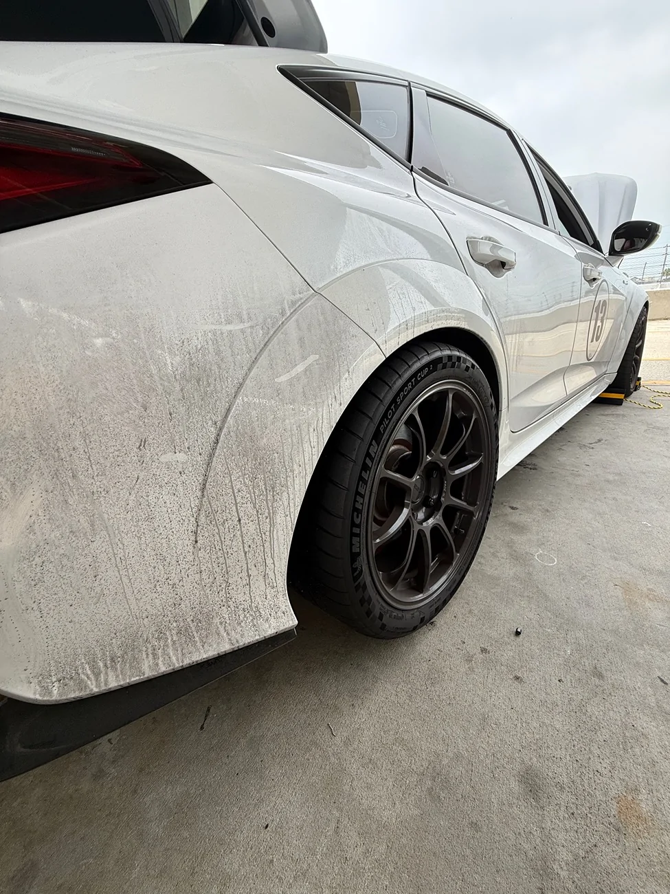

I dropped from the 19” stock rims and tires to 18” Rays ZE40 M-Spec rims wrapped in 275/35R18 Michelin Sport Cup 2 Connect (240TW) rubber. Picture attached. Made quite a difference. Shout out to Felipe at Velocity Factor in Coral Springs for the wheels and tires. https://www.threads.com/@velocityfa...n3IwKr96EcNy45OeZPYaBoPUJxyw31XfWFy3xc&slof=1

Just curious - what makes the 18" rims preferable to the 19" stock rims

Lower unsprung weight and rotational mass. Each of the ZE40 rims is about 8lbs lighter than the 19" stock rims. The tires themselves are each about 1lb lighter than the OEM tires. This reduction in weight helps the brakes and the suspension to be more efficient. It also helps with acceleration. These forged rims are also supposed to be stiffer/stronger than the flow-formed OEM wheels, which helps with wheel integrity when going over bumps, rumble strips, etc... Here's a good explanation of the difference between forged rims and flow-formed rims:

With a high quality flow formed wheel there's really not as big of a strength difference, honestly. The oem wheels are high quality enkei MAT wheels.
I believe the bigger difference is the availability/cost of tires that you can run and the fact a sidewall acts like a spring, so a taller sidewall has more variability you can get out of tire pressure tuning.
Either way, 18s are the way to go for track use.
