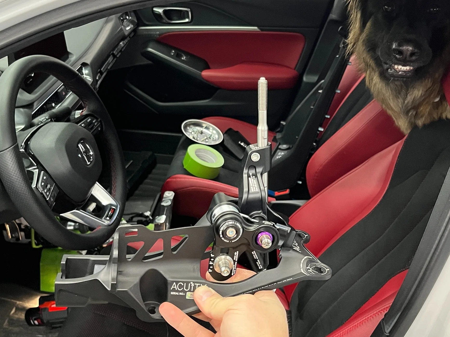

I had a few ways to solve that with this shifter: shortening the throw, raising the knob, and shifting the whole shifter body. I did all three to varying degrees. I was also going to explore a fourth method of shimming the shifter where it bolts to the bracket in the car, but I found that unnecessary. But if you find it necessary, I would say that it felt like it was doable.
Regarding the shifter body, I used position "C" to get the shifter as far to the left as possible.
Regarding the height, I played around with the maximum height I could get away with and not have the boot be taut or stretched out when going into first gear (which seems to put the most stress on the boot in position "C".) I set the upper rod at a height between 3 and 4, and then used the jam nut to fine-tune the height.

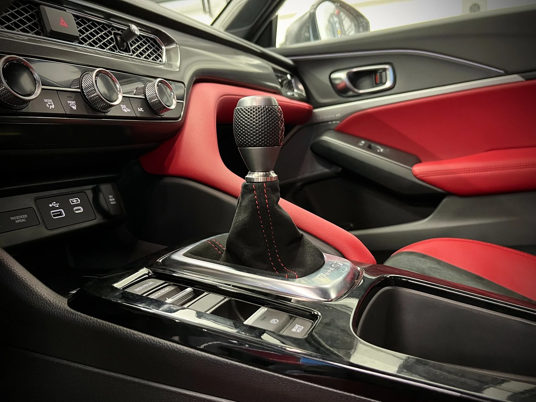

As you can see, I was able to get the knob to sit decently high. This alone reduces the reach for me, as I'm reaching down less to access the shifter.

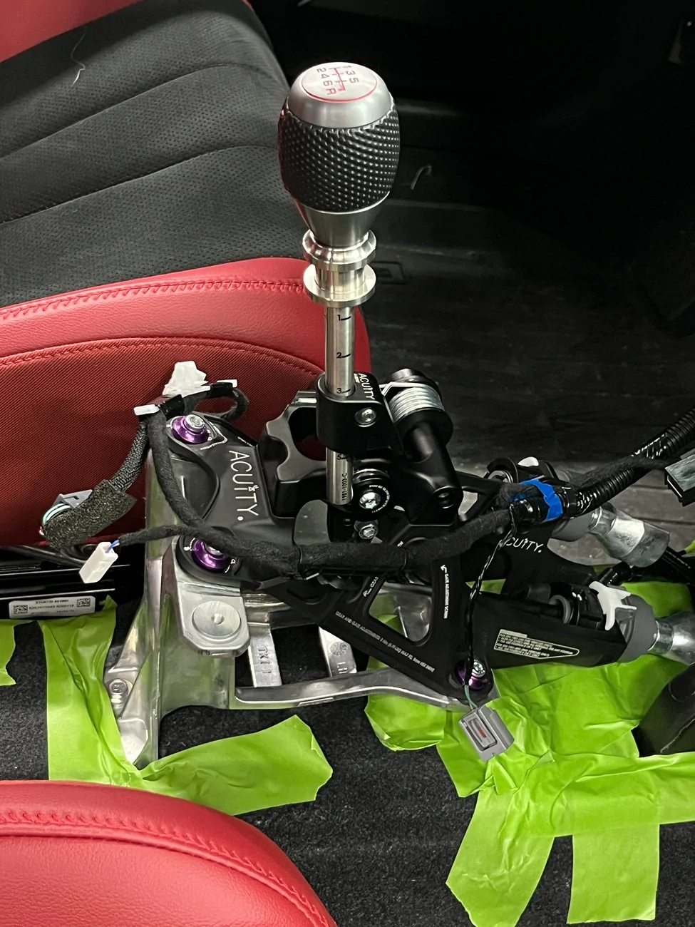

  • I heard some horror stories about folks dropping bolts or clips that found their way into the holes of the carpet, and then migrated down around the exhaust hump to the floorboards. Resulting in either throwing in the towel and ordering a new part, or going so far as to remove the seats in order to get access to the lost component. I taped over all of the open holes in the carpet with painter's tape as soon as i got the center console out:
    Acura Integra Acuity Short Shifter review IMG_5419
    and this proved useful, as that weird clip that holds the gate selector cable on came off unexpectedly and I'm sure it could have landed in one of those holes right under the shifter.

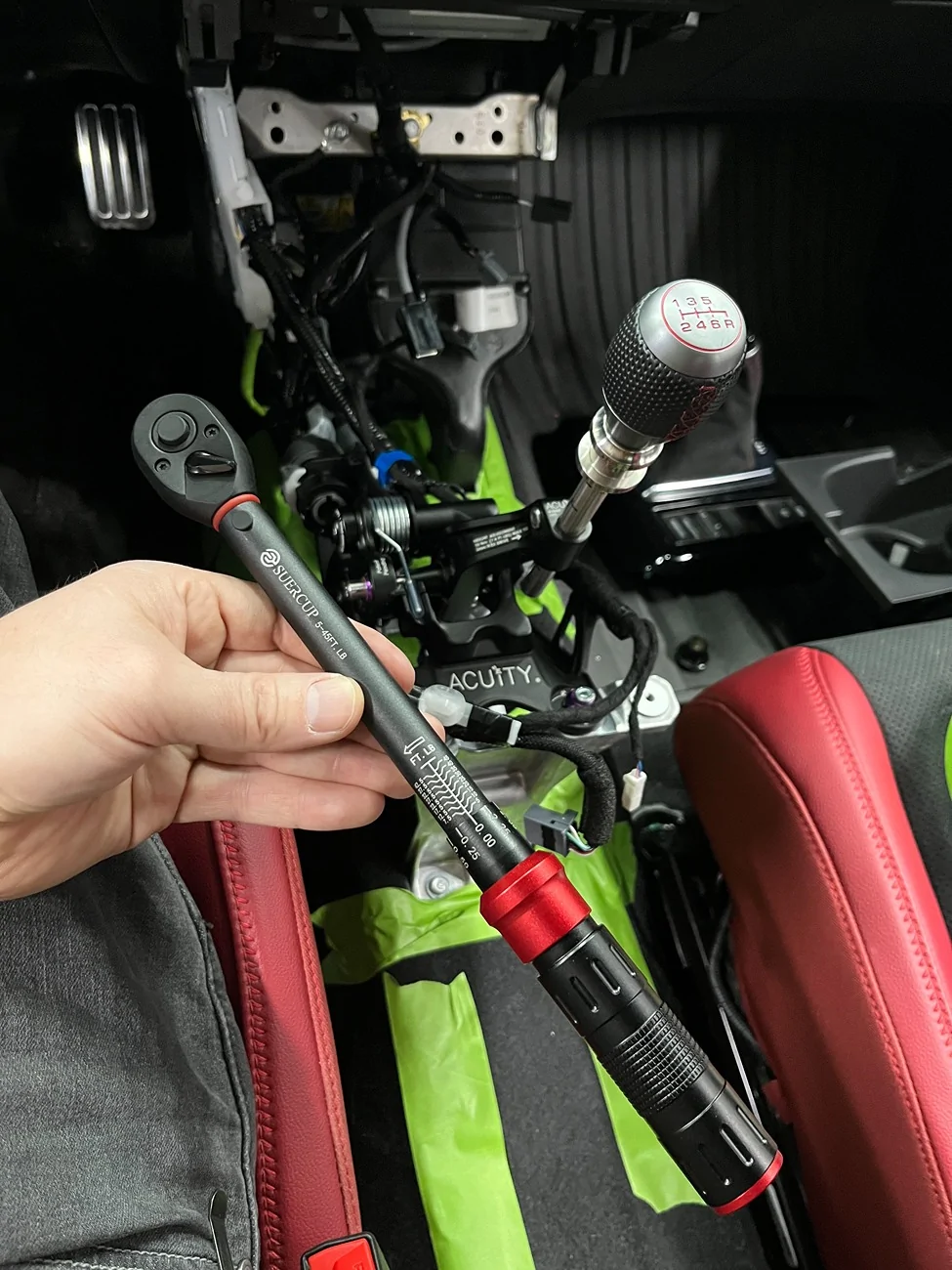

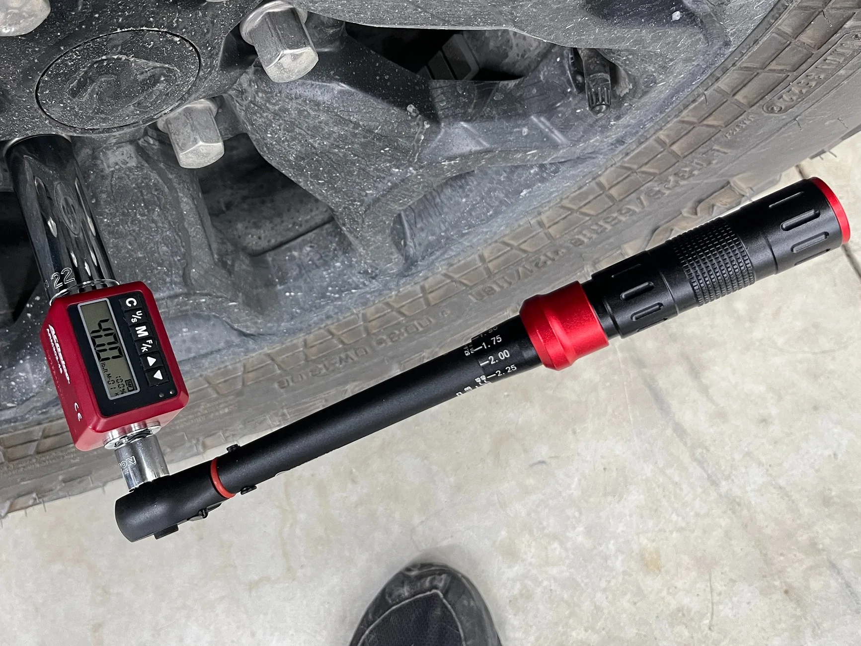

  • Acuity has a lot of very specific torque values that are all under 10 ft/lb. My smallest torque wrench (aside from a torque screwdriver) only went down to 10 ft/lb, so I hunted around for a torque wrench with a useful range for this task. The YouTube channel "Project Farm" did a review of torque wrenches lately in which the alphabet-soup brand "Suercup" from Amazon performed quite well, and the reviews seemed positive. Suercup has a torque wrench with a nice 5-45 ft/lb scale. A lot of torque wrenches in this size only go up to ~20 ft/lb, and they're marked in inch pounds which can be annoying. This torque wrench proved accurate and it was great to use, for a whopping $30 I'd recommend it. As with any torque wrench, check it for calibration at least annually.
    Acura Integra Acuity Short Shifter review IMG_5418
    Set to 40 ft/lb and nailing it:
