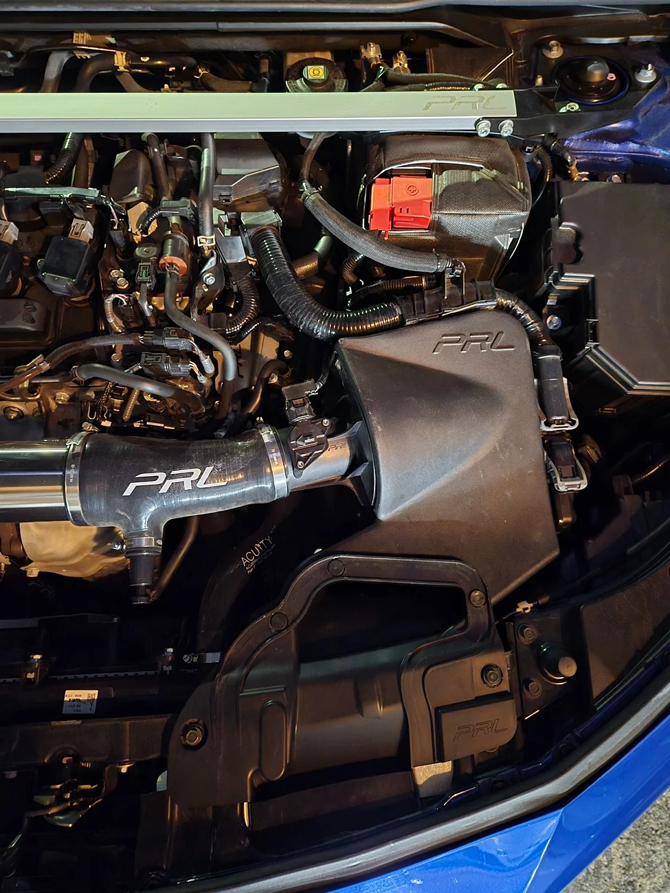

Great! Was it difficult to replace the O.E intake? Again, I am not planning to install the side duct.

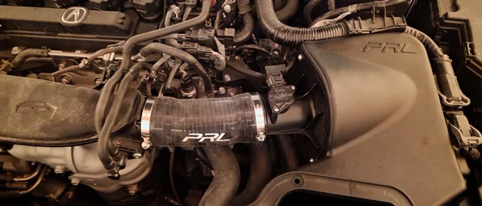

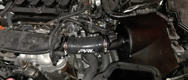

Do you have a picture of your install (engine intake pic)? Would like to get an idea (not of OEM)

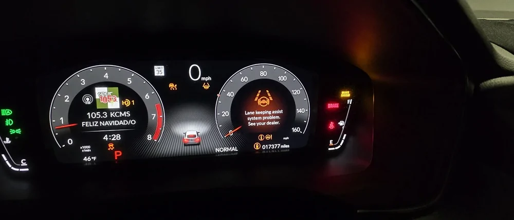

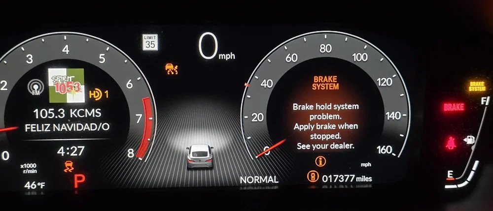

I managed to get the intake installed. However, it was a bit of a pain and unfortunately after the install... I am getting brake failure lights and such (see picture).
Acura Integra 2025 DE4 Integra 6 Speed ABP Build 20251203_162723rs
Acura Integra 2025 DE4 Integra 6 Speed ABP Build 20251203_162803rs
(I did connect that map sensor from OE to the new pipping). Do I need to reset anything? I drove it for a few miles and it displayed it throughout. Therefore, I took it easy - although, was able to brake and it seems me sensors does warn me when close to something. I could not turn off the lane assist and such though :/

Are there any other sensors I should maybe re-plug that deals with what the lights are indicating?

I notice you have this:
Acura Integra 2025 DE4 Integra 6 Speed ABP Build 2025-12-03 17_31_28-Clipboard
What is that to? I didn't have to remove anything their...I have 24 a Spec (CVT) not ITS. I didn't have to remove whatever that is; as mine doesn't even have what you seem to have.

That is from the PRL turbo inlet kit - you're not missing it.
You'll need to do a drive cycle to clear those errors - the steps to that should be listed online somewhere. If you have a tuner you can just reflash the tune to skip that. The only time I've gotten those errors is when I either forget to plug in a sensor before I start the car after install, or another time when it went in limp mode because of boost leak.

I do not have a tuner... when you say drive cycle, is that a button to reset with or literally drive a bit? I will google around but if you have a link. Please, could you provide?
yeah make sure the sensor is connected properly. that'd be the only thing throwing codes if you installed it properly. I had no codes after install.

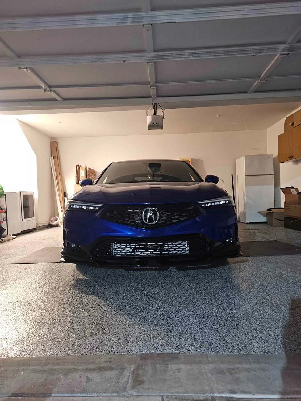

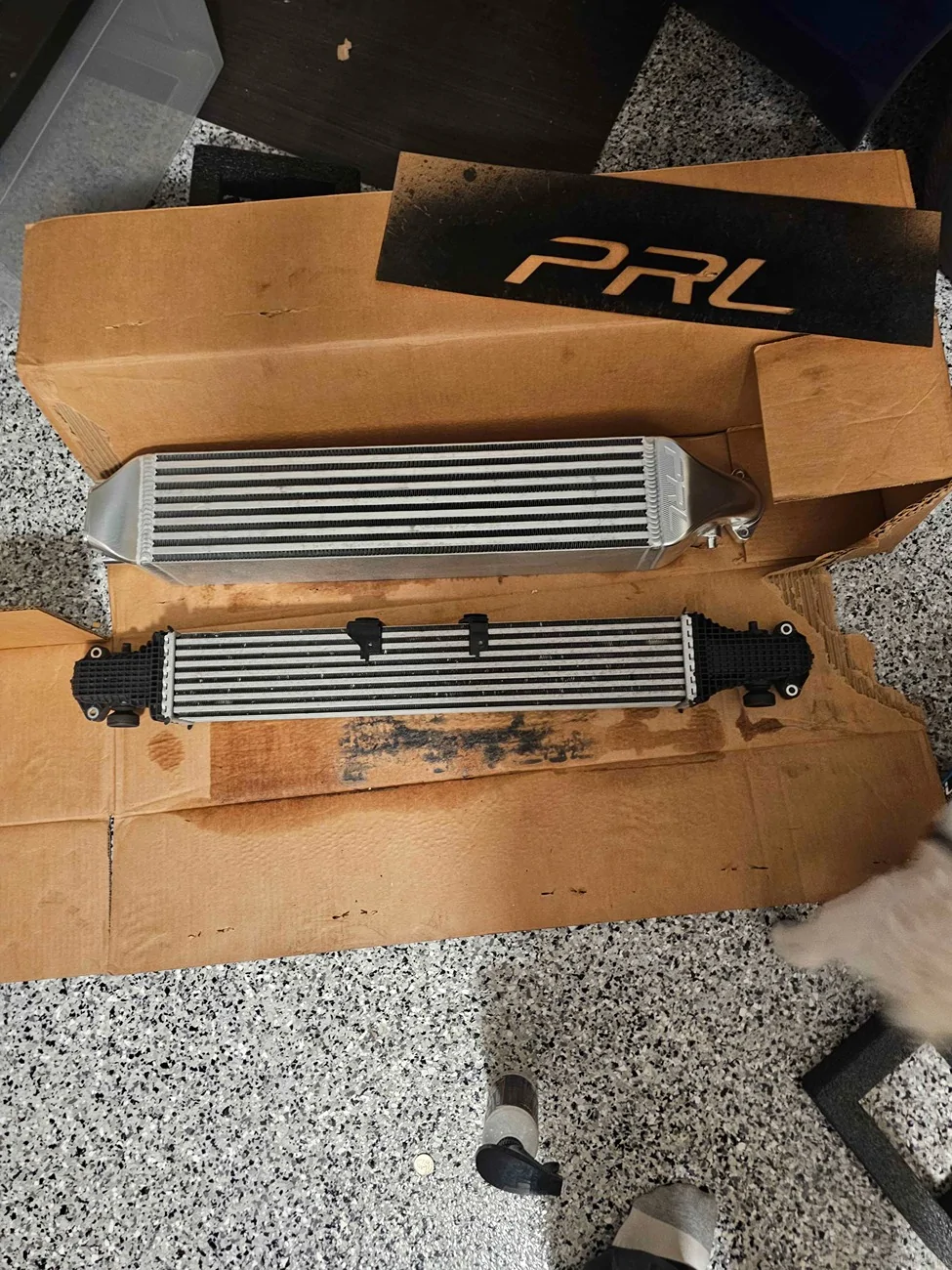

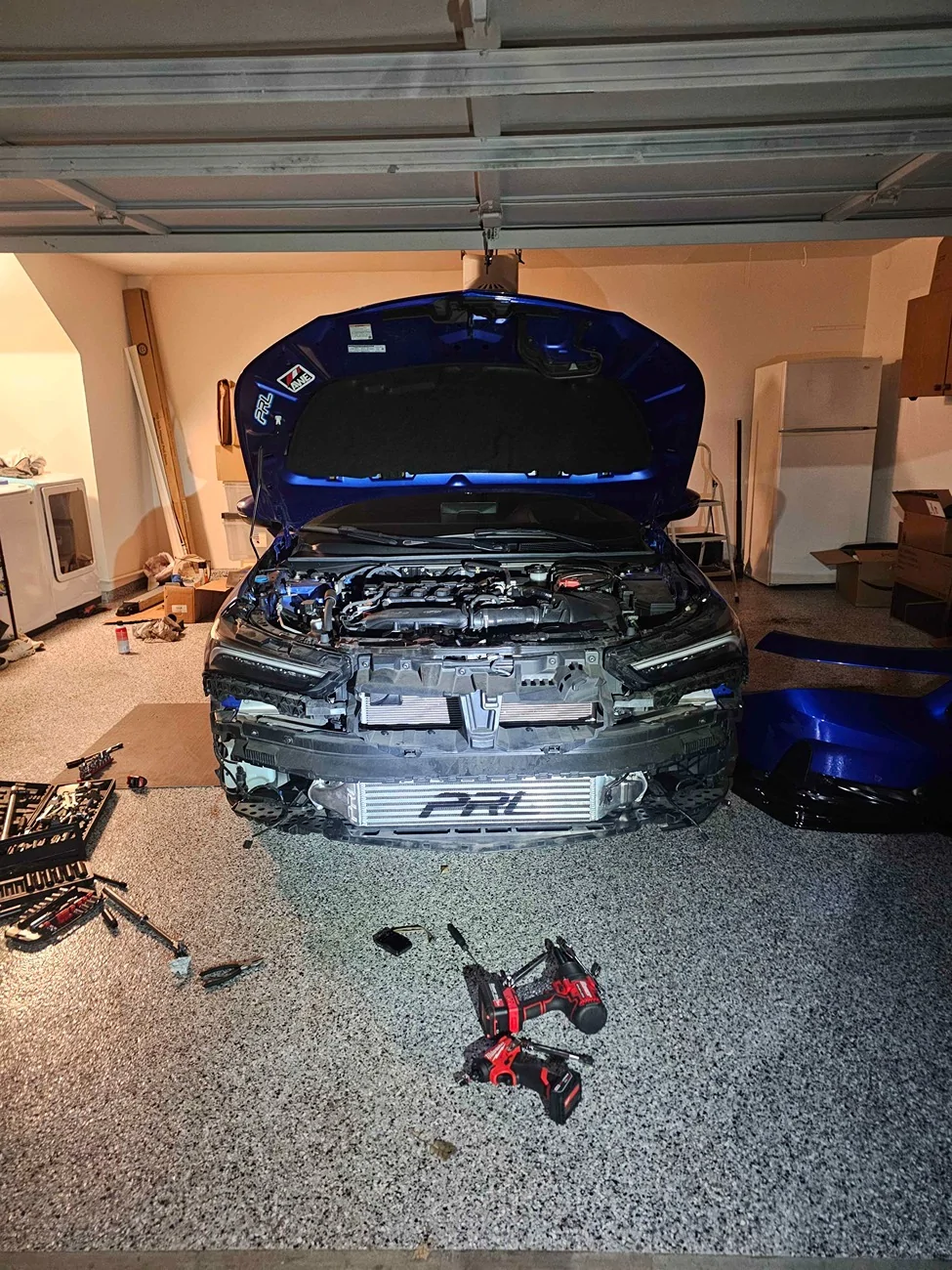

got done with installing the PRL intercooler, and also got the DE4 GF bodykit lip V2 for Christmas, which i test fitted. i think it makes it look way more aggressive, although im not sure how i feel about the two middle pieces. i'm most likely gonna keep it, though. i do really like the look of it. (would love to hear your guy's opinion on the lip)
everything was smooth installation, the only thing is... im getting codes for a sensor issue. i'm assuming i forgot to plug in a sensor, or one of the sensors is loosely fit onto the plug. so, thats a PITA. gonna have to get the bumper off on monday and see whats up. either way, the hard part is done, and it looks great.
still need to send Ktuner my ECU ID, and then gap my spark plugs before loading in the tune, and I should be good from there!
