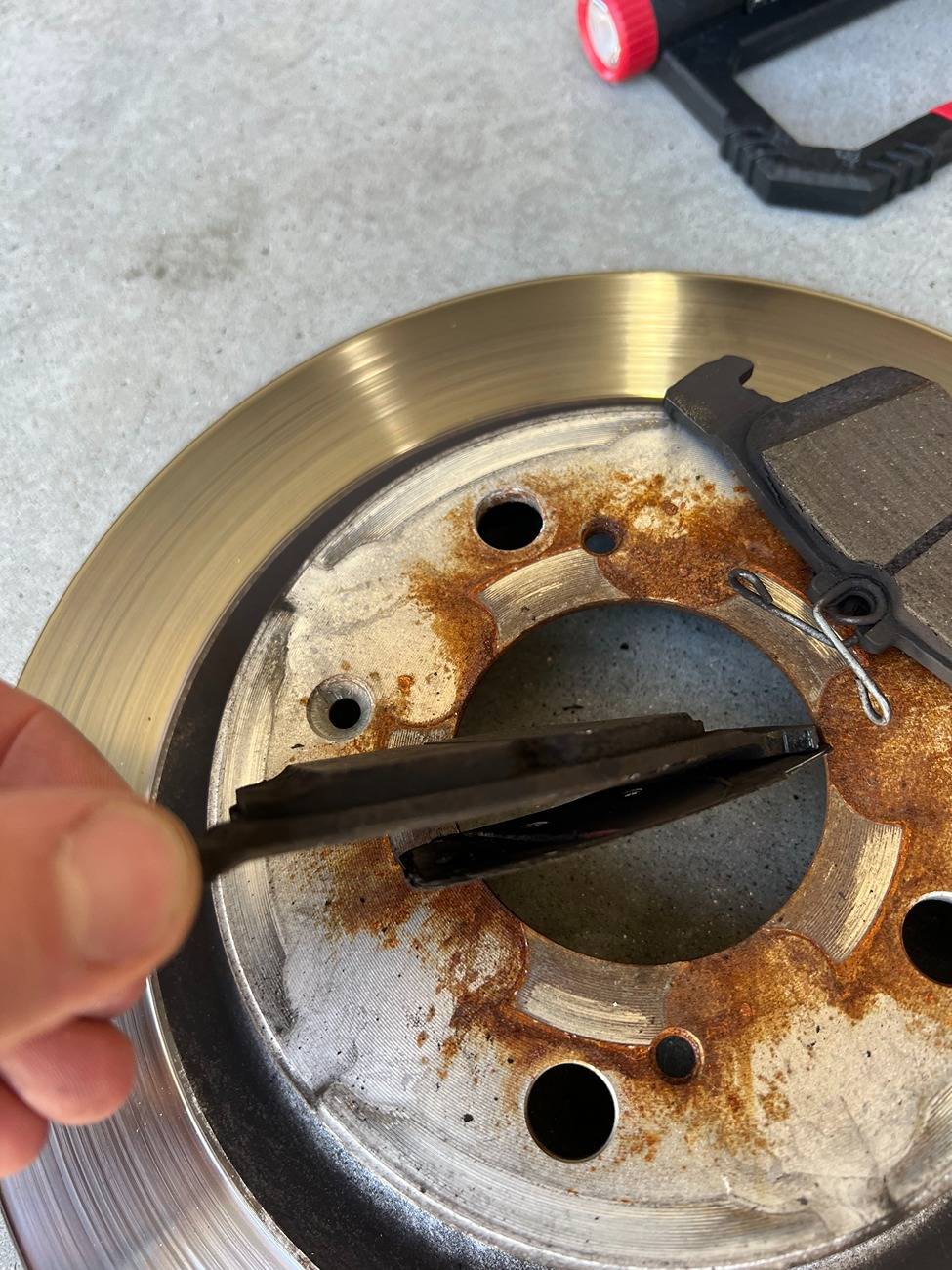

My dealer mentioned the same thing when I had about 17k miles. I decided to replace them myself, and it ended up being about 2.5 times cheaper! I was pleasantly surprised to find that the pads still had plenty of life left, but I went ahead and replaced everything anyway.
Acura Integra 16k Miles and already need to change brake pads!! IMG_9647
