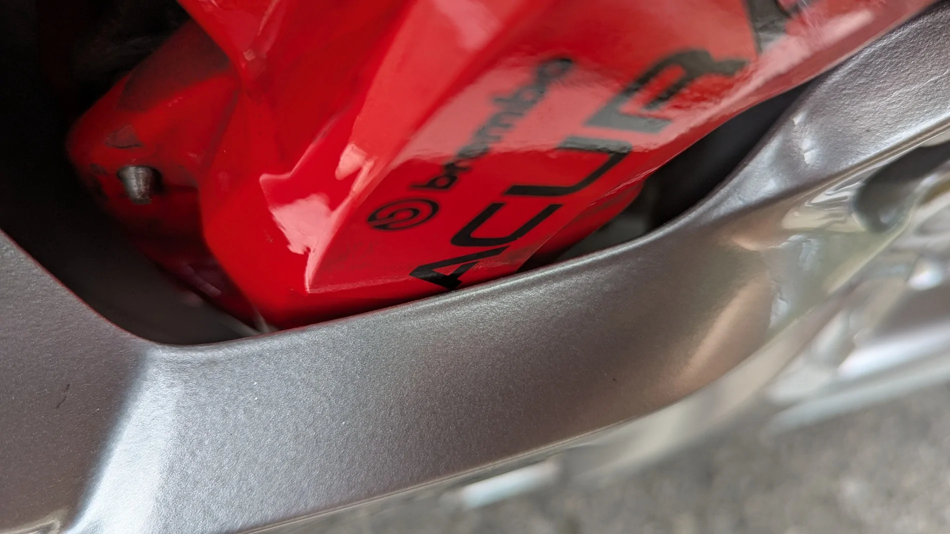

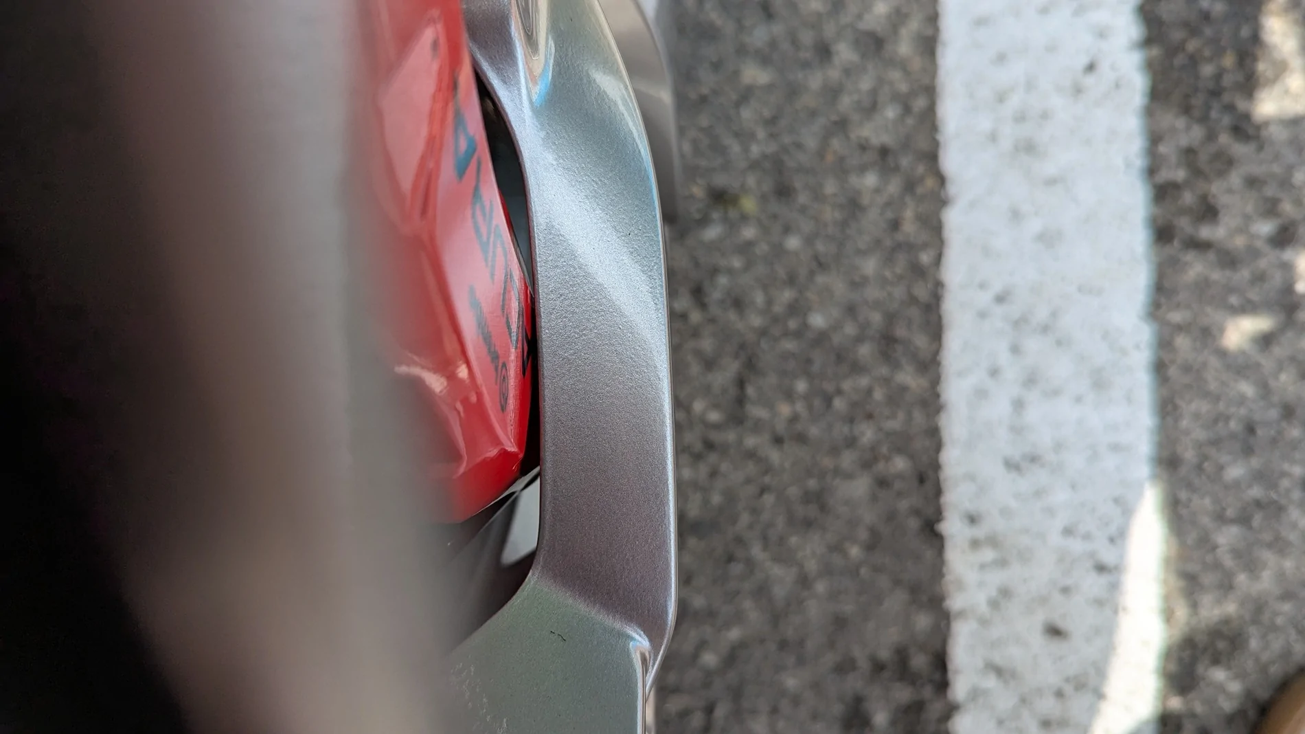

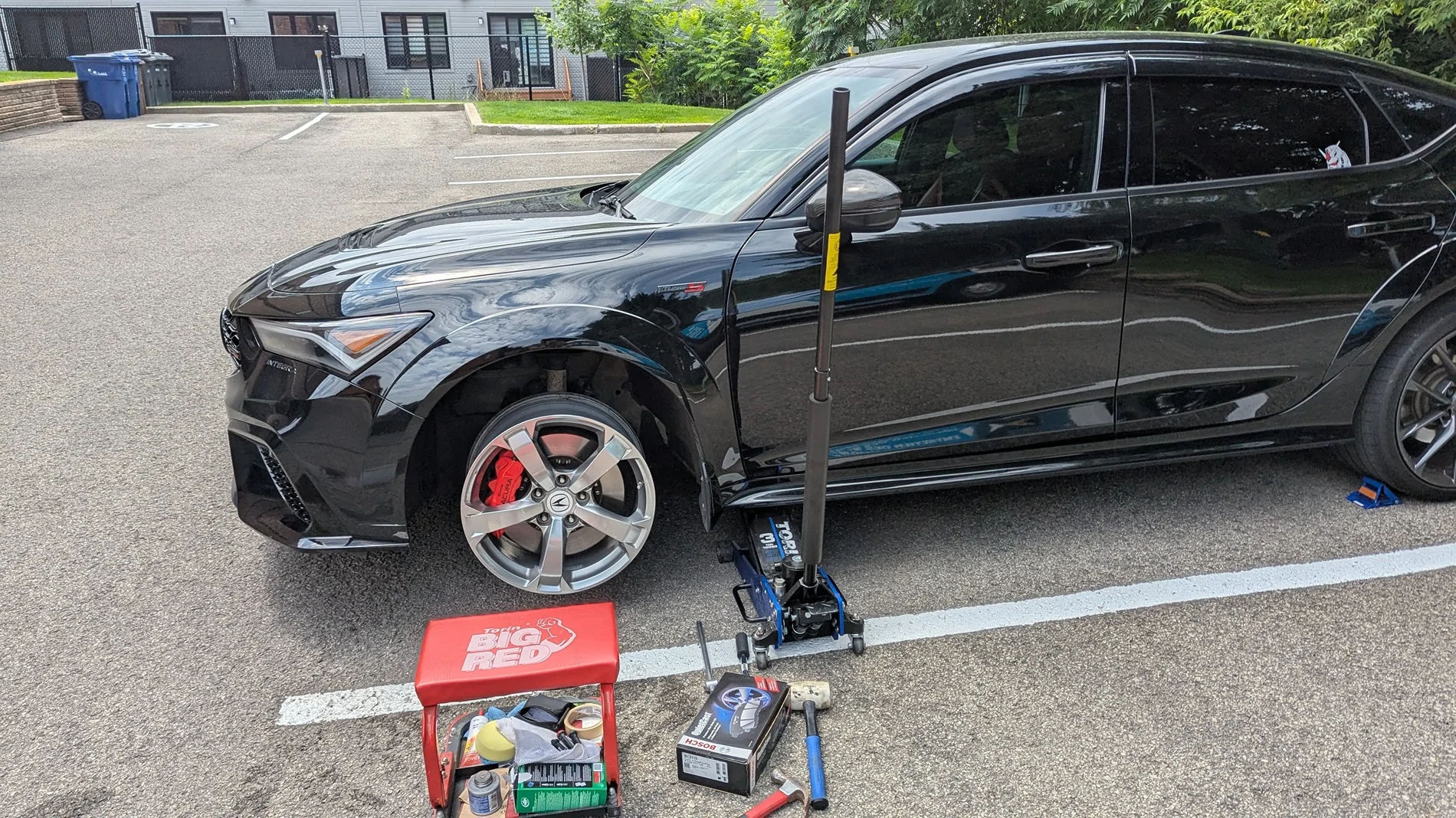

I think folks are taking this thread out of context. He stated it fits, and it fits. He stated for additional clearance he will add a spacer. He stated this is his “I don’t care” winter setup. Not even sure what there is to discuss as there was no question.

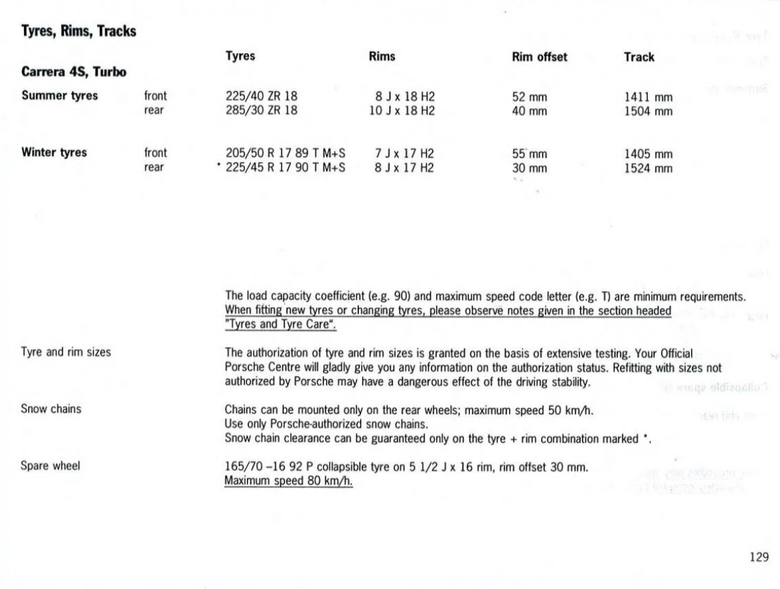

Just to add to the width and diameter discussion.
Porsche is one of the few manufacturers to make specific winter tire recommendations in their owner's manuals. Here's an example:
Acura Integra '09 TL Wheels fit! Winter Setup 1754511709588-jg
So they recommended going from a 18x8 wrapped in 225/40R18 to a 17x7 wrapped in 205/50R17 in the front, and in the back (even more drastically) they recommended going from a 18x10 wrapped in 285/30R18 to a 17x8 wrapped in 225/45R17. Note the difference in offsets also.
I am sure someone will be along arguing that we appeal to a higher authority than Porsche about driving performance cars in the snow (perhaps we should ask the Pope?) but for the rest of us, I hope that's illuminating enough.
I've also seen the same from audi somewhere in the owner's manual. I followed their rec to go from 285/45/20 to 255/50/20 for winters.
Porsche, audi, vw, and Lamborghini I've also seen specifically note you should set the winter speed warning to 99mph or the max of the tire manufacturers recommendation. 100mph on true winters is skeeeetchy.

I think this is a great find. There is nothing wrong with trying things out and reporting them back on here. Does it need a spacer? Yes, lol. That was a gnat's ass for clearance. But they do clear. I would think even a 5mm spacer would do the trick.
Stock wheels for winter are always best, but if you can't find stock wheels or don't want to spend the money on them then look for different options. I bought $250 wheels for my 2019 RS5. I just want wheels that work and aren't ugly.

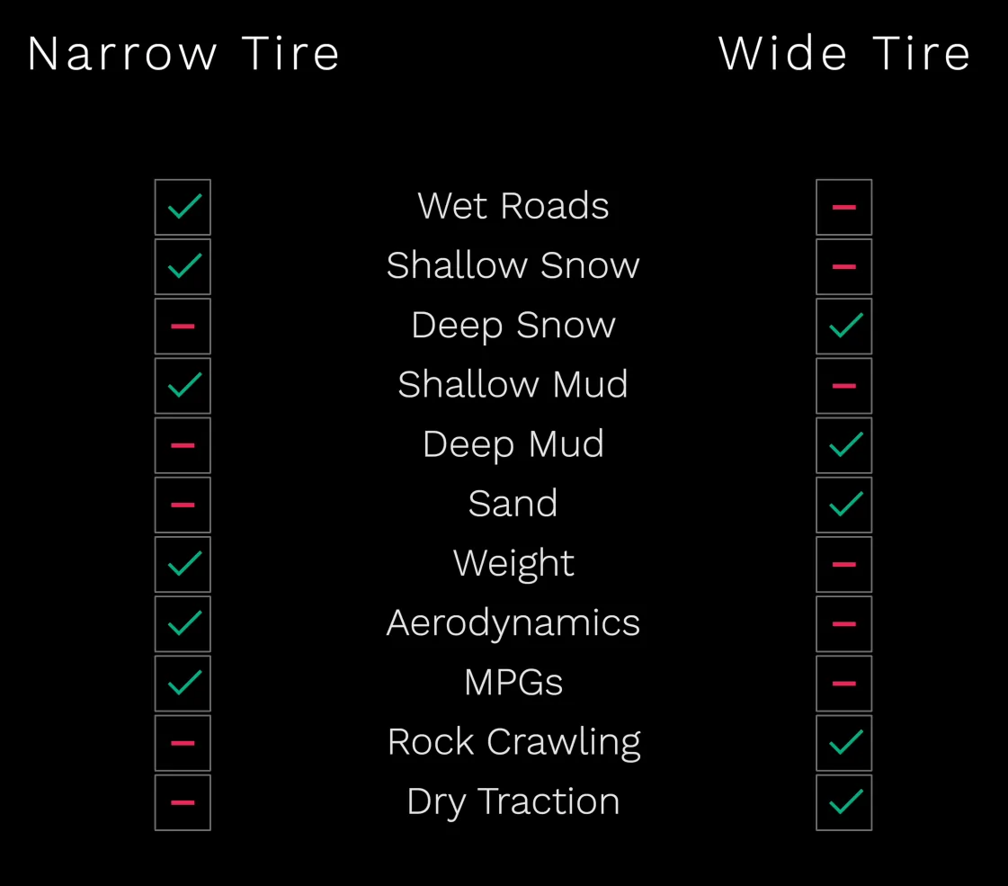

Not sure why this was deleted, so adding it back.
One of the misconceptions people sometimes have is that if you reduce the width of your tires, you reduce the contact patch. Generally speaking, that isn't true at all since your total contact patch is a function of:
  • How many pounds does the car weigh?
  • What is the PSI (pounds per square inch) in the tires?
  • How many square inches of tire tread touch the ground before each square inch is supporting the PSI of the tires? That is your contact patch.
Notice how width of the tire doesn't factor in. If you car weighs 3200 pounds and you have 32 psi of air in your tires, you would expect to have 3200/32=100 square inches of contact patch regardless of width or diameter.
This video illustrates the principle very nicely:
Notice that there is some variability away from the formula - tread design and sidewall construction can throw a bit of a wrench in things. But generally speaking, the formula holds true.
So that being said, what changes with different tire widths is the shape of the contact patch.
Depending on the situation, different shapes of contact patch may have advantages or disadvantages.
This still from the video above covers some of those:
Acura Integra '09 TL Wheels fit! Winter Setup 1758134555553-mk
"Wet roads" are on there, but again one of the things I specifically call out thanks to no small amount of personal experience is hydroplaning and slush.
Narrow contact patches have superior hydroplane resistance, and this for me is the single biggest reason to go narrower on winter tires.
