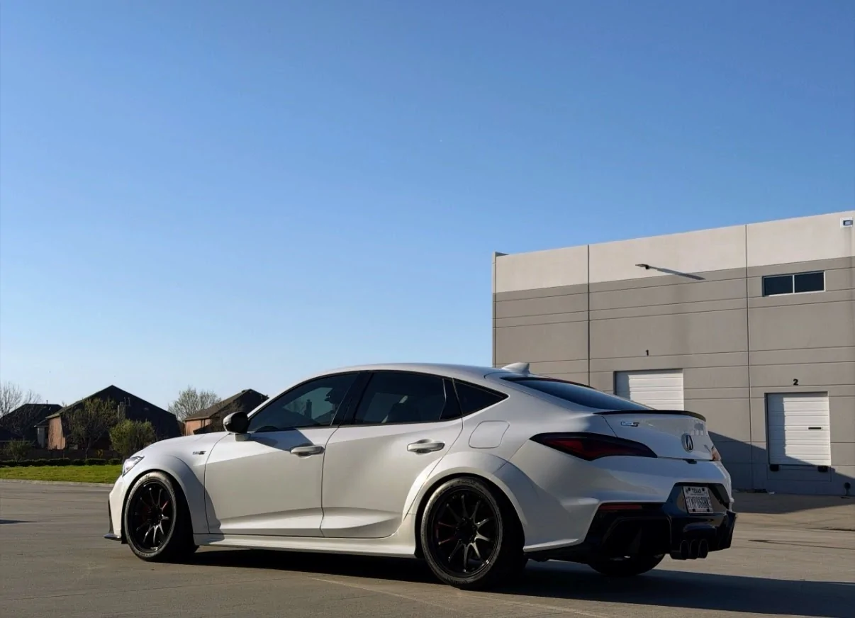

i fit 275/35 tires on a 18x9.5 wheel (pretty popular sizing from reading the forums). im sure you could go wider but i think it really comes down to how low you go. im on swift springs which is a pretty aggressive drop but the car sits right above the tire by maybe a finger width.

Thanks, I don't think I'll go as wide as you have but nice to know I can.

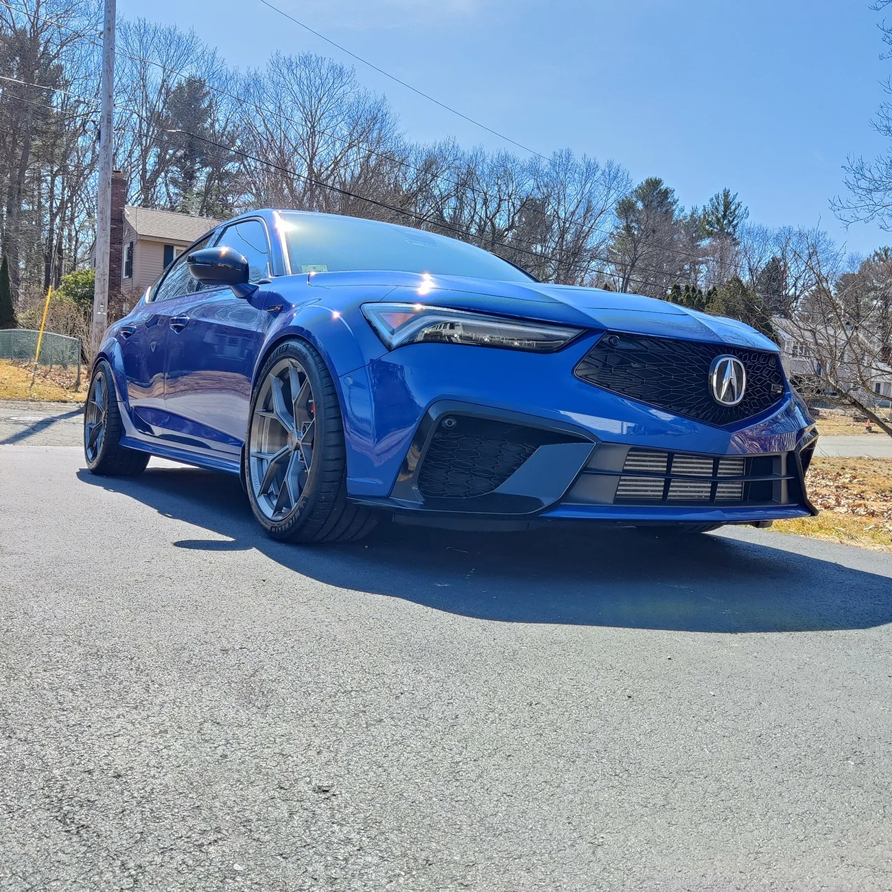

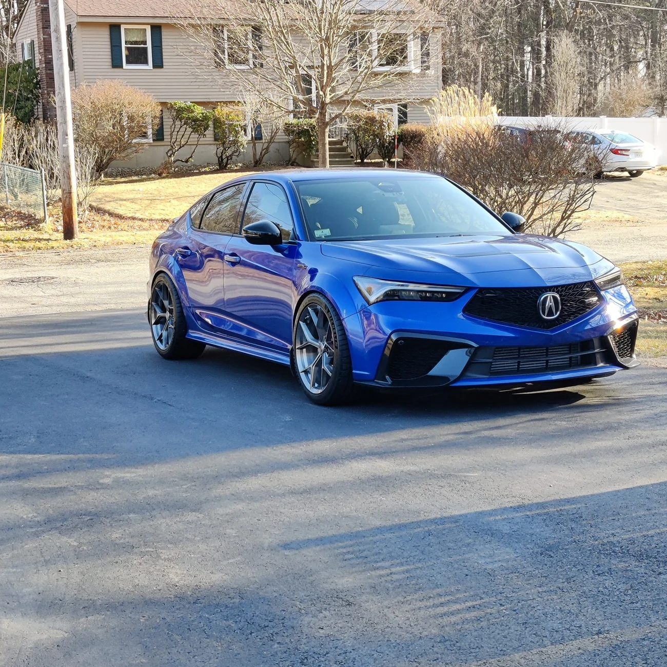

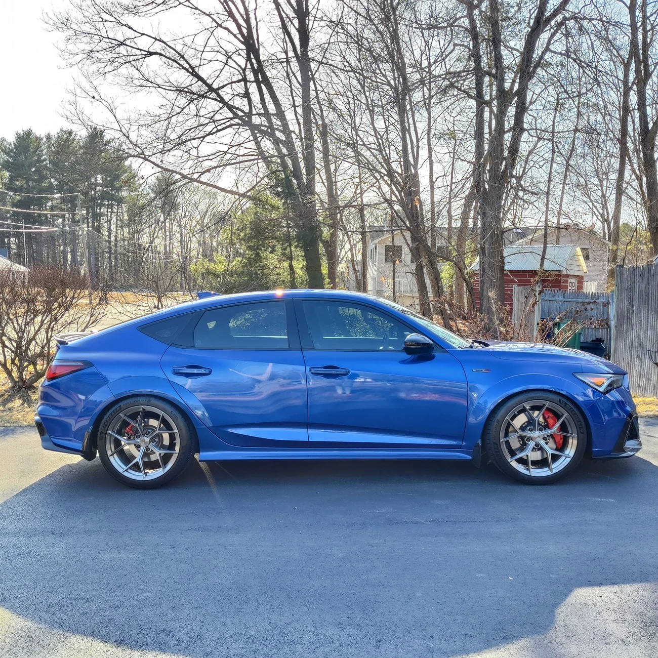

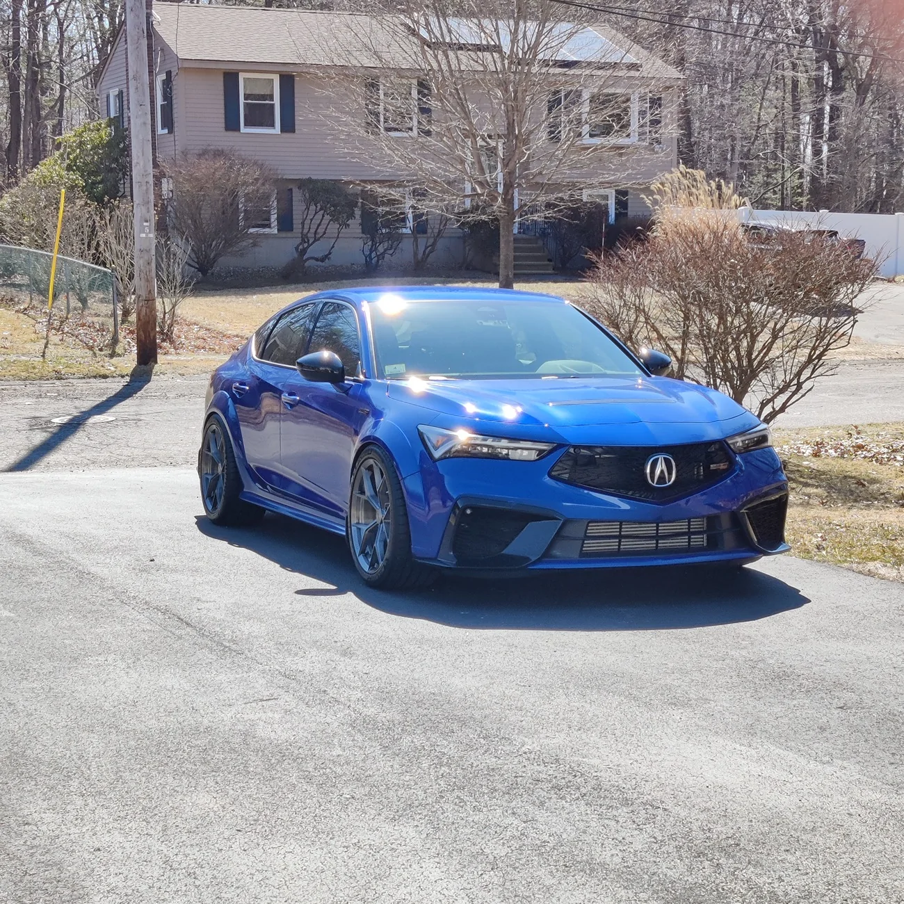

285 would be the limit on 9.5" wide wheels and even then I feel you'll be losing a bit of cornering stability. 275 is personally as wide I would go.
Here is a 275/35 for reference, lowered on H&R springs on 19x9.5 +35 wheels.

Thank you! Sounds like I'll be sticking to 275 and either 35 or 40. Your current config looks awesome! Love the flush sidewalls... they look super straight, about as perfect as you can get. The stock PS4S tires have a sidewall that looks like they've been stretched just a little to fit the wheel, though no where near as bad as the stance crowd.
Good to know 275/35 works well even when lowered a bit AND on spacers. I assume no rub at all?

Just a word of caution, there is some numbness at the 35 profile that I'm not a fan of. It's definitely an improvement over bumps but turning and cornering feels a bit bland, if that makes any sense. It's minor but just enough to dampen my experience. I now run a 275/30 on those wheels (but they're currently not mounted) and I found it perfect.
