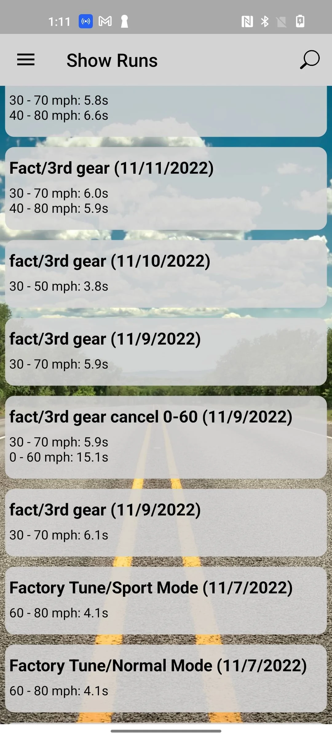

By the way I did two runs so far.rolls from about 25mph 30-70 in 5.9 to 6.1 secs.
40-80 in 5.8 -6.0 secs.

Using a GPS app called GPS race timer. Works very well actually and comparing to the video time frames it's damn near exact.

Data from the app seems pretty consistent. I've done plenty of runs

Samsung galaxy s22 and a one plus. Both give the same numbers.

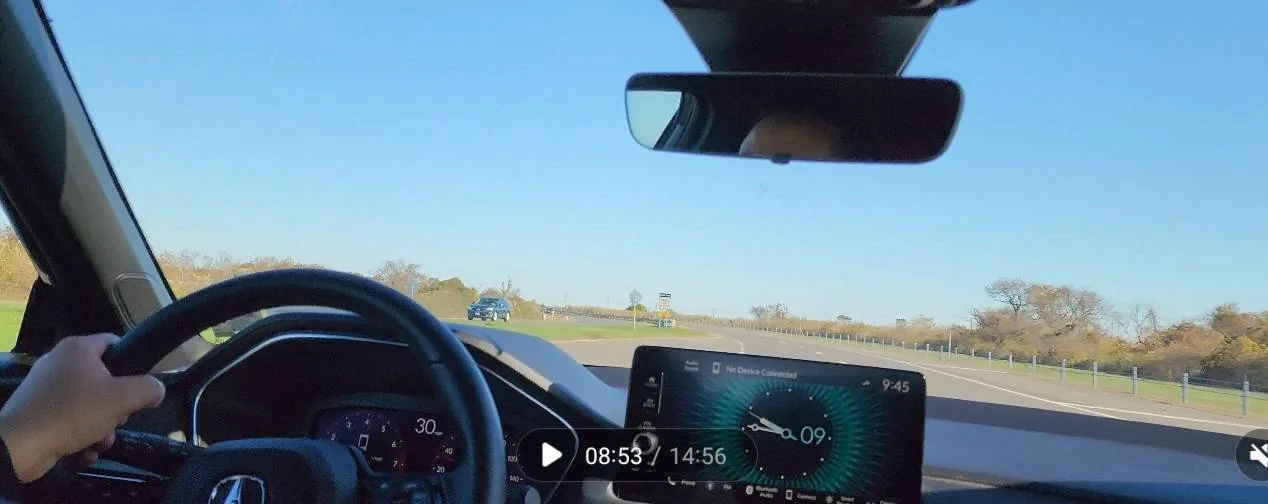

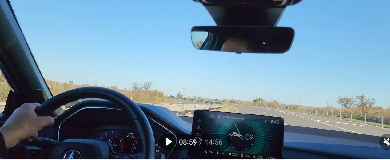

To be fair 1/4miles times on apps are usually off due to the way they determine distance but gps speeds are usually on point. Here is a run where I hit 30-70 in 5.9
