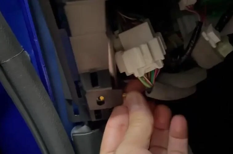

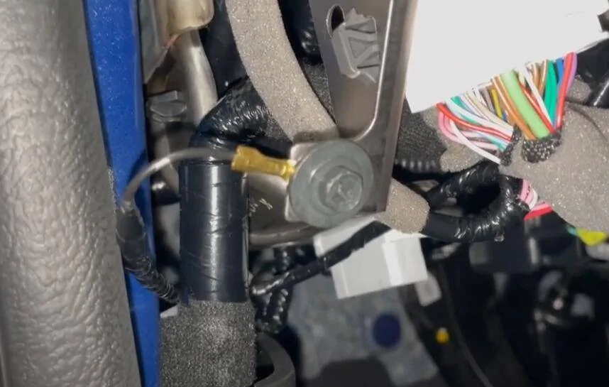

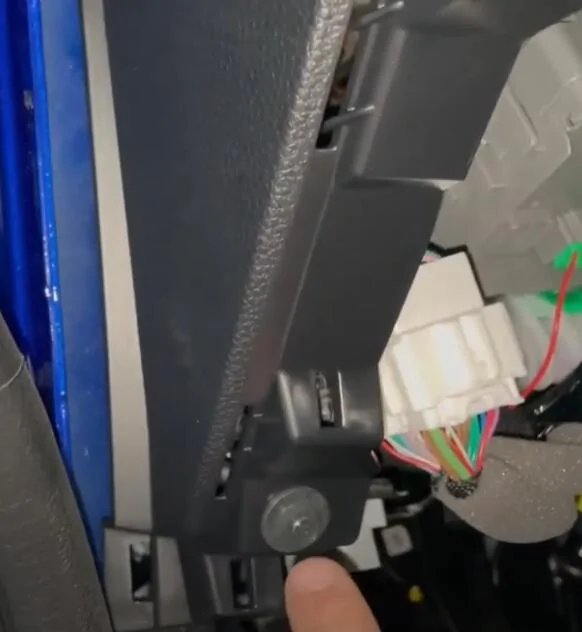

You can use any bolt that directly seats up against unpainted metal. For my HomeLink mirror install, I popped off the panel that holds the VSA button and used the bolt that holds in the panel behind it (at the bottom left). The wire eyelet goes behind the panel and you thread the bolt through the panel and the eyelet. Just need to remember to reconnect it any time you remove that bolt in the future.

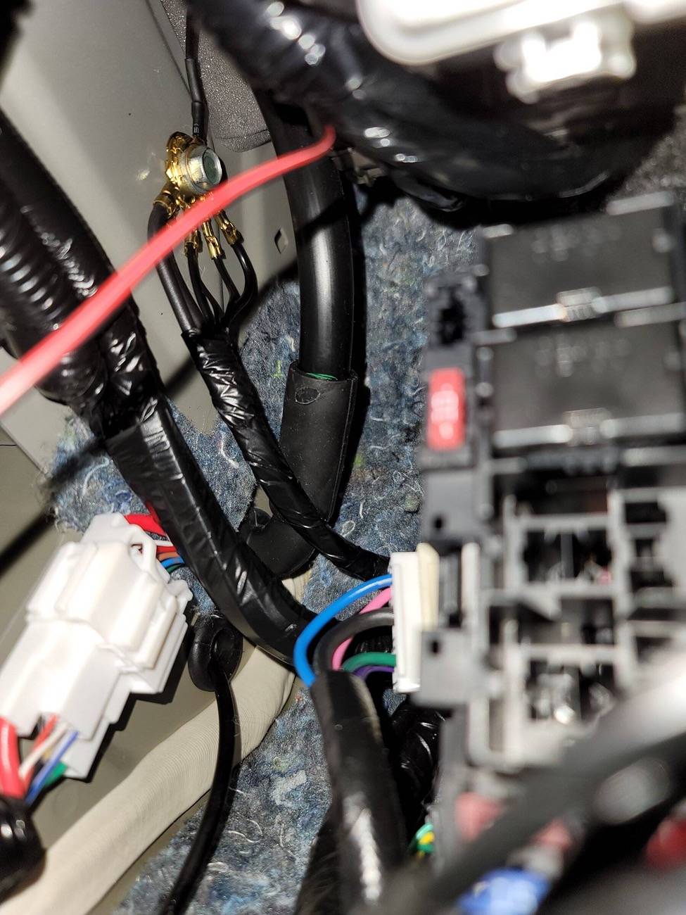

This is what I used to hardwire my dashcam. You can clearly see other wires tuning to it for ground

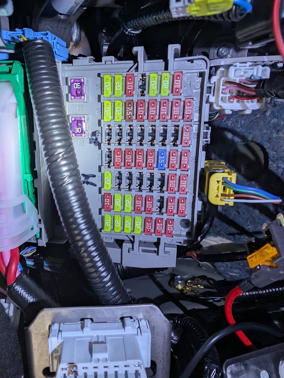

FYI in the under dash fuse panel fuse # 13 is the only open slot one that goes hot with ignition on. The rest of the open slots are hot all the time ('25 type S). You can see the numbers on the right side of the fuses if you zoom in on this pic.
The hard wire kit might have come with a fuse tap lead (mine did but it was flawed and didnt seat firmly and kept falling out) I bought these on AMAZON and they stayed in securely...
https://www.amazon.com/dp/B07T8LRSH7?ref_=ppx_hzsearch_conn_dt_b_fed_asin_title_1&th=1
