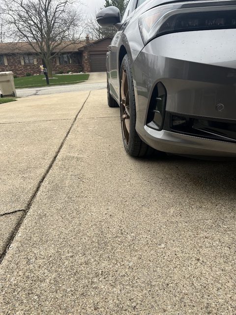

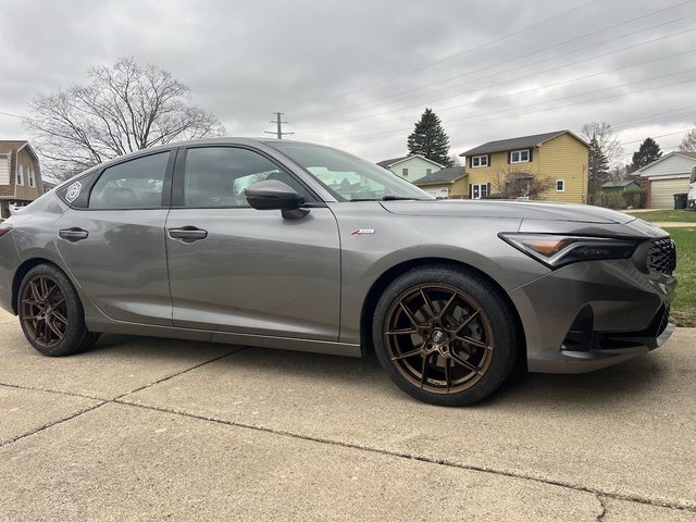

I just got these yesterday, 18x8.5 +45mm OZ Estremas, with 245 tires, and I didn't think they'd sit flush enough in the front (I know the rears are more tucked regardless) but to me, they sit exactly where I wanted, and I may do a simple 10mm spacer in the rear (I definitely won't do spacers on the front on a FWD car, just personal preference):
Acura Integra Using offset to make the wheels more flush with the body? MXRGyyAl
Acura Integra Using offset to make the wheels more flush with the body? 7HT3Oqil
I do plan to lower about 1" with H&R springs, but that'll be it.

SUPER nice! Thanks for sharing!
