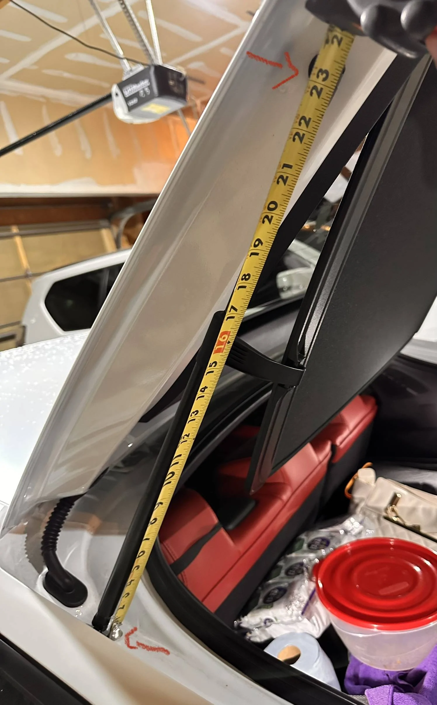

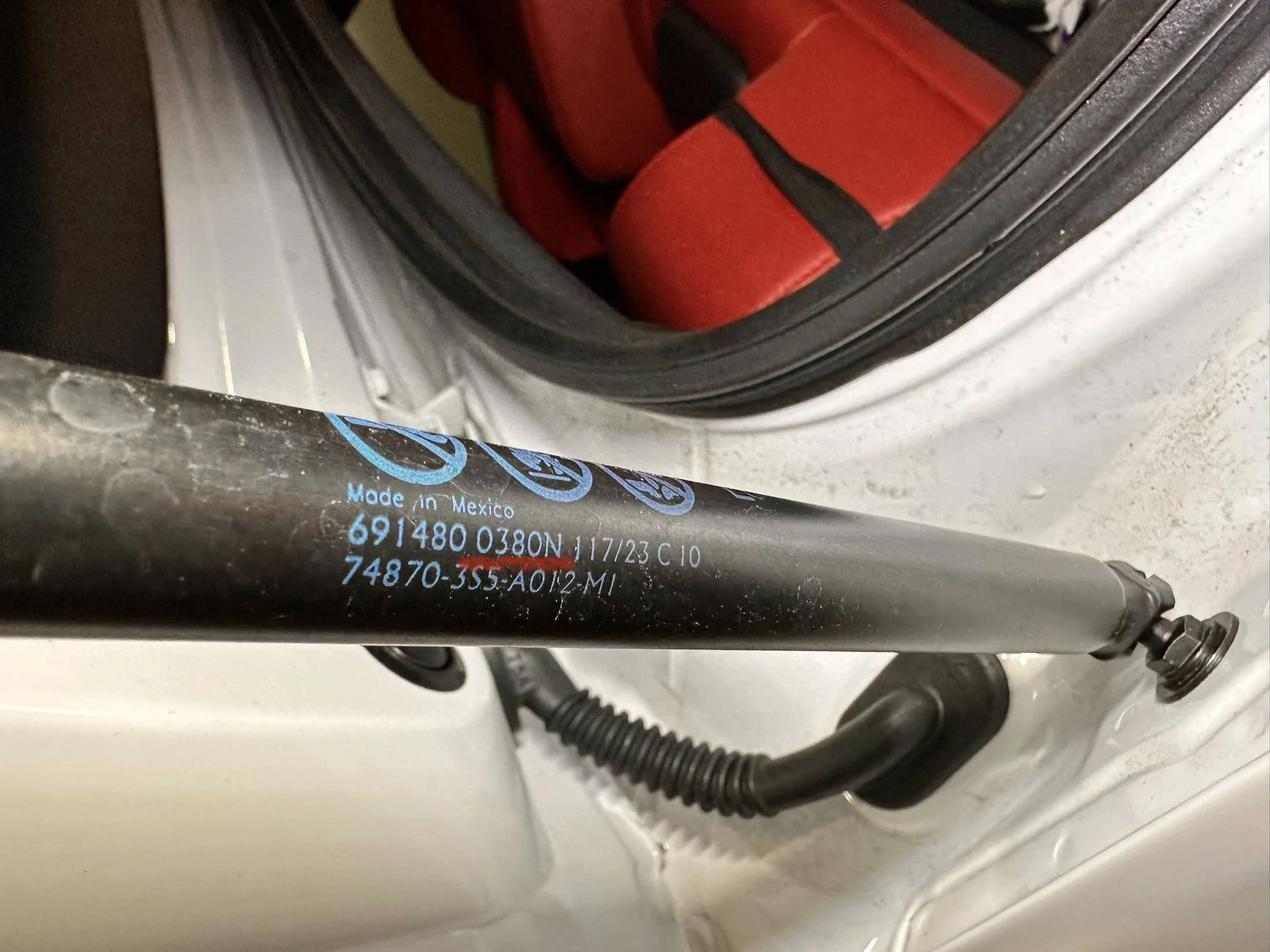

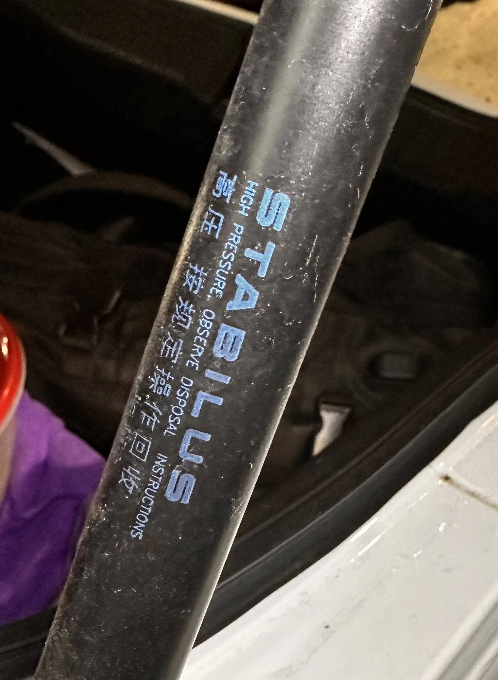

Yes, certainly. So our DE5 hatch support lifts are 380Newtons or 85 lbs of lifting force.
Acura Integra Unpopular Opinions: Missing "features" you're happy about 15A8AE69-6A95-433F-B46B-234A702E7C2C
Acura Integra Unpopular Opinions: Missing "features" you're happy about 07C57C61-DEC9-4612-9F8B-69D4919AC8E0
Acura Integra Unpopular Opinions: Missing "features" you're happy about 9F979B4F-F0FC-47A3-A60B-5BE9741A2B88
Acura Integra Unpopular Opinions: Missing "features" you're happy about 812F119D-C813-45E1-817B-997283986C57

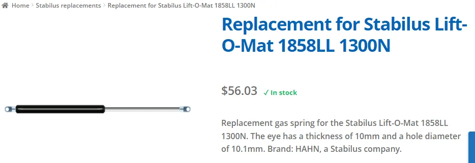

I’ve come to find out today that the FL5’s are rated 700 Newtons:
https://www.civicxi.com/forum/threads/weak-hatch-struts.52861/page-2#post-878544

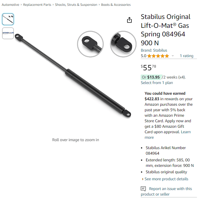

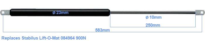

They also have complaints about their supports being too weak. But our hatches are lighter without a large wing. Alternatively you can go with Stabilus and up to 1300N or lifting force.
Acura Integra Unpopular Opinions: Missing "features" you're happy about 1BF98751-85CC-4422-BBBD-C9C278D481D1
Acura Integra Unpopular Opinions: Missing "features" you're happy about 392DDD2B-F3DE-4829-800D-A4DD706FF1D3
Acura Integra Unpopular Opinions: Missing "features" you're happy about 51C491A1-A5B4-4C75-884C-4FDF24856BEF
these are 23” full extended length. So picking up the FL5 700 newtons supports or 900N would be huge upgrades. That would be 202lbs of lifting on each side of the hatches; 170lbs increased to 404lbs

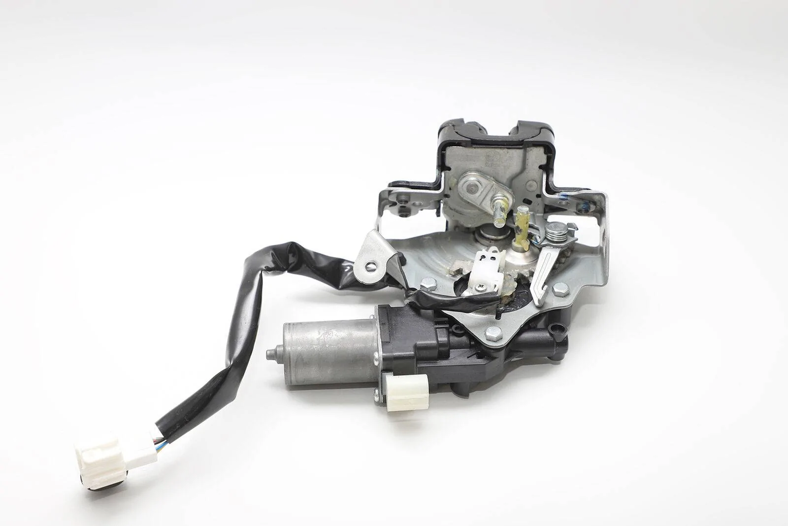

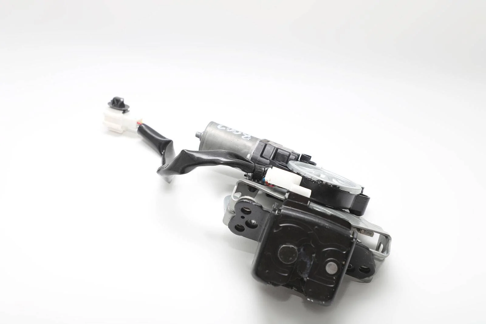

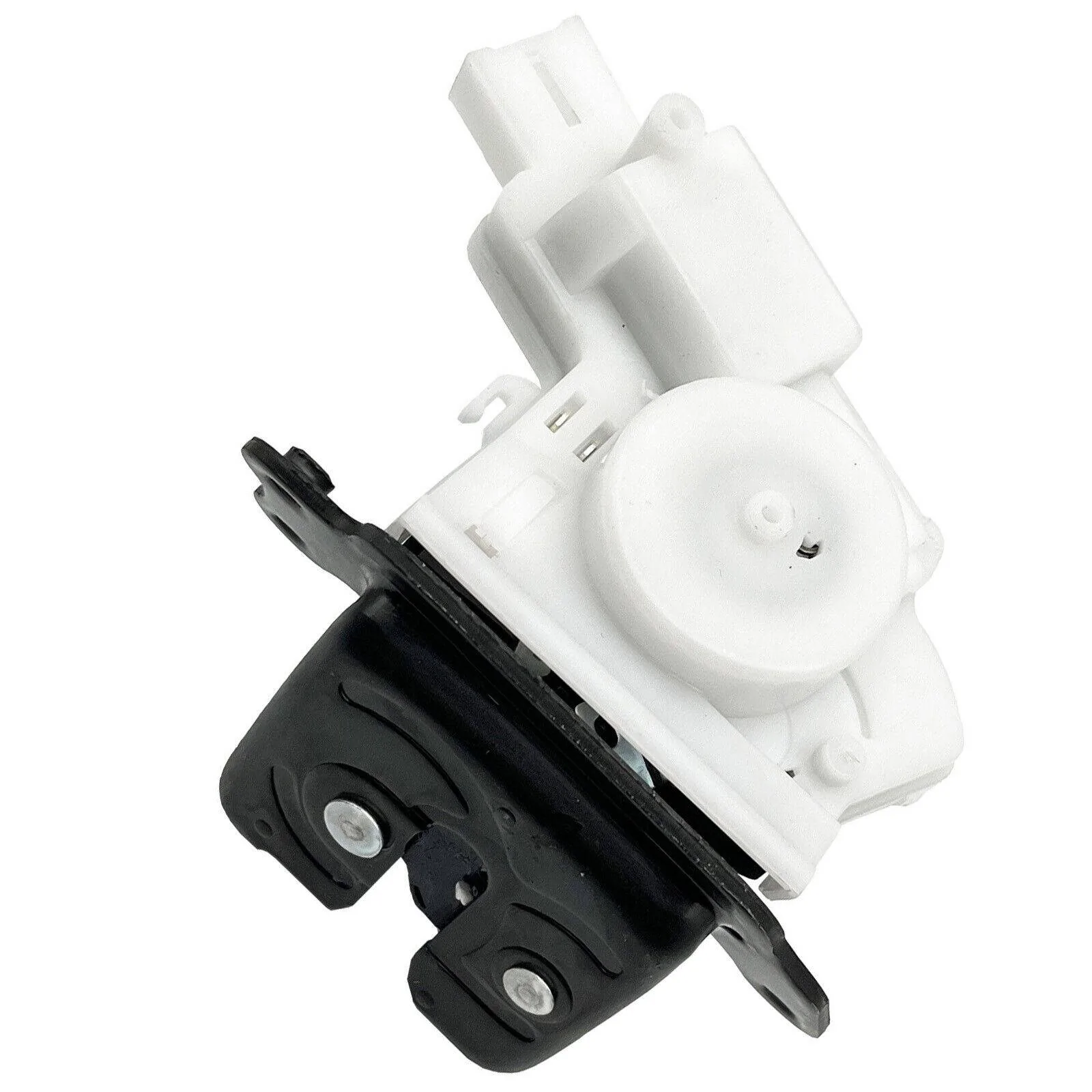

So our ITS OEM tailgate lock is 74800-TRN-H01. These have a very tiny motor and the way it works is with two control wires:
1. Motor operate to move to unlock position via Key Fob.
2. The button wired to your trunk hatch to release from the striker (hook).
There is no actuator that provides us with the 'popping' action. The tailgate is likely too heavy with support lift struts that are too weak anyway.

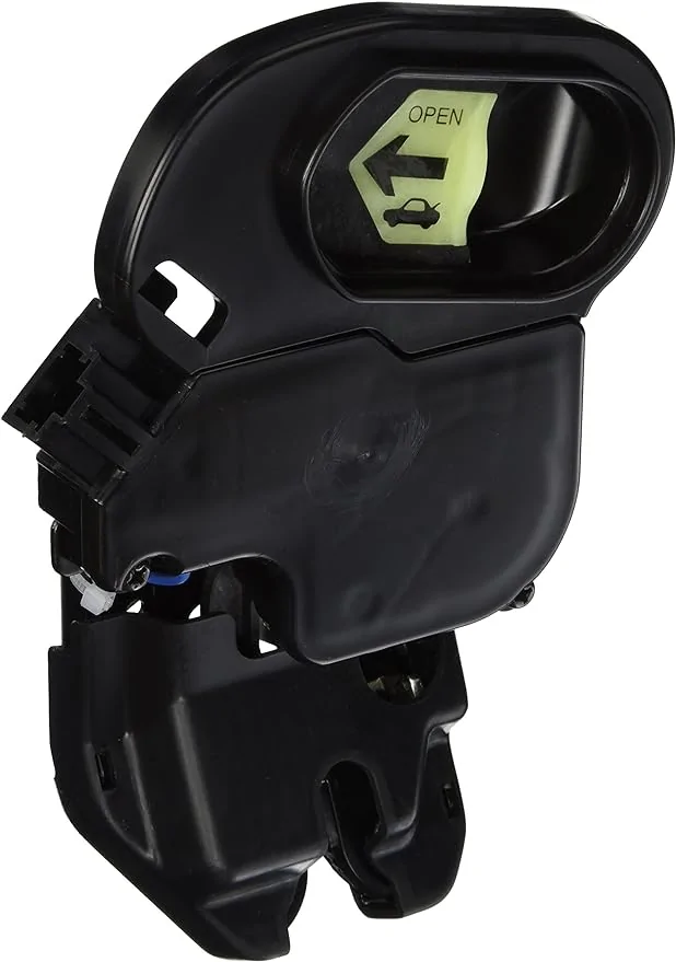

I started looking around and the Honda CRV/Odyssey(74800-THA-H01) & Acura TL(74851-SDA-A22) do have popping linear actuators:
Acura Integra Unpopular Opinions: Missing "features" you're happy about 748-THA-H01
Acura Integra Unpopular Opinions: Missing "features" you're happy about 748-THA-H01-2
Acura Integra Unpopular Opinions: Missing "features" you're happy about 74851-SDA-A22-TL
I have no idea what the motor ratings are on these but the CRV/Odyssey actuators can be used with the automatic trunk lifts.

Back to our original OEM tailgate lock, since the key FOB only unlocks we would need to swap the signal wire so that when we push the button the tailgate lock lets go of the striker(hook). Alternatively, wire them both to the keyfob.

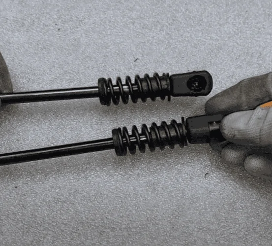

The first method that should be tried is to build DIY tension release springs onto the support lift struts:
Acura Integra Unpopular Opinions: Missing "features" you're happy about DIYSprings
Once the tailgate lock releases, the tension on these springs should be enough to 'pop' the hatch and with some stronger support lift struts with higher Newtons should be able to completely lift the hatch on its own. This would be the simplest method before buying a new tailgate actuator.
