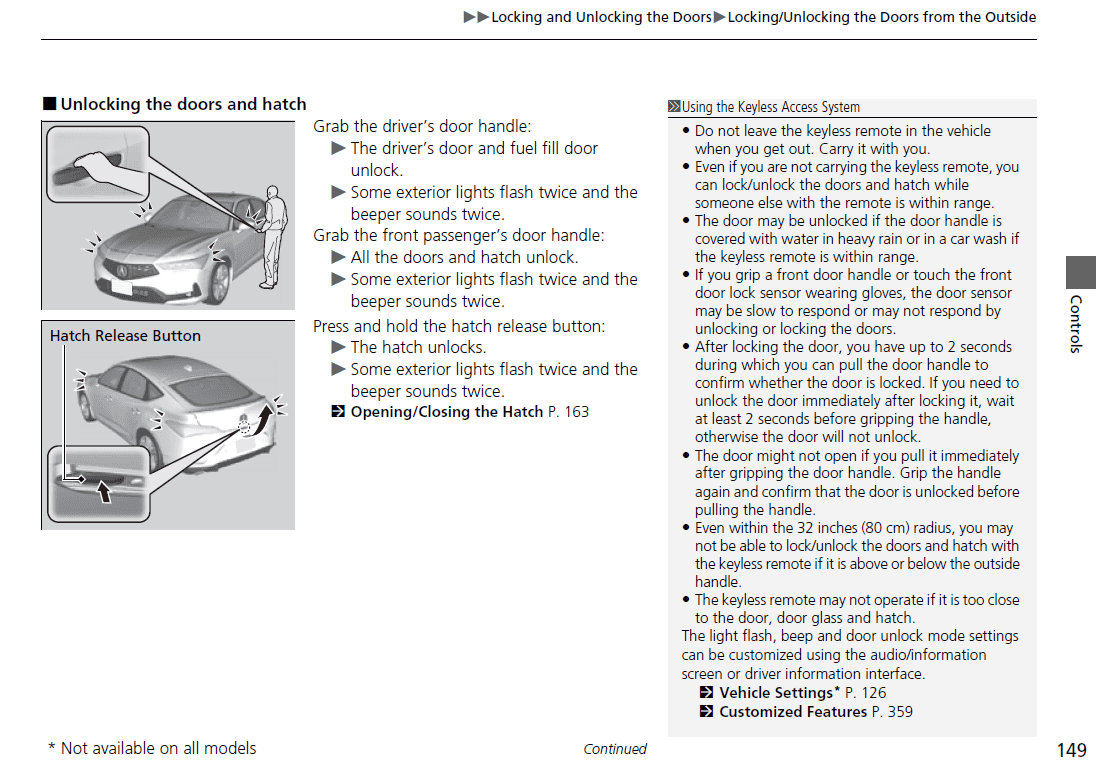

I think I remember when I first got the car I could just grab the driver's door handle and all doors would unlock, and now it doesn't seem to do that. Maybe it's my memory, but I swear it used to behave this way. Does anyone know if this is possible?
Here's the page from the manual that only refers to grabbing the front passenger's door handle to do that.

Your settings are slightly different than mine. Mine's a manual and doesn't have the option to unlock when switched into park. I have mine set on Driver's Door Only, and it works as it's supposed to from the outside, I think.
Key in pocket on driver's side; driver's door only unlocks.
Key in pocket on passenger side; passenger door handle unlocks all doors. Is that supposed to happen? :dunno:
Key left on driver's side; passenger door handle does not unlock anything.
