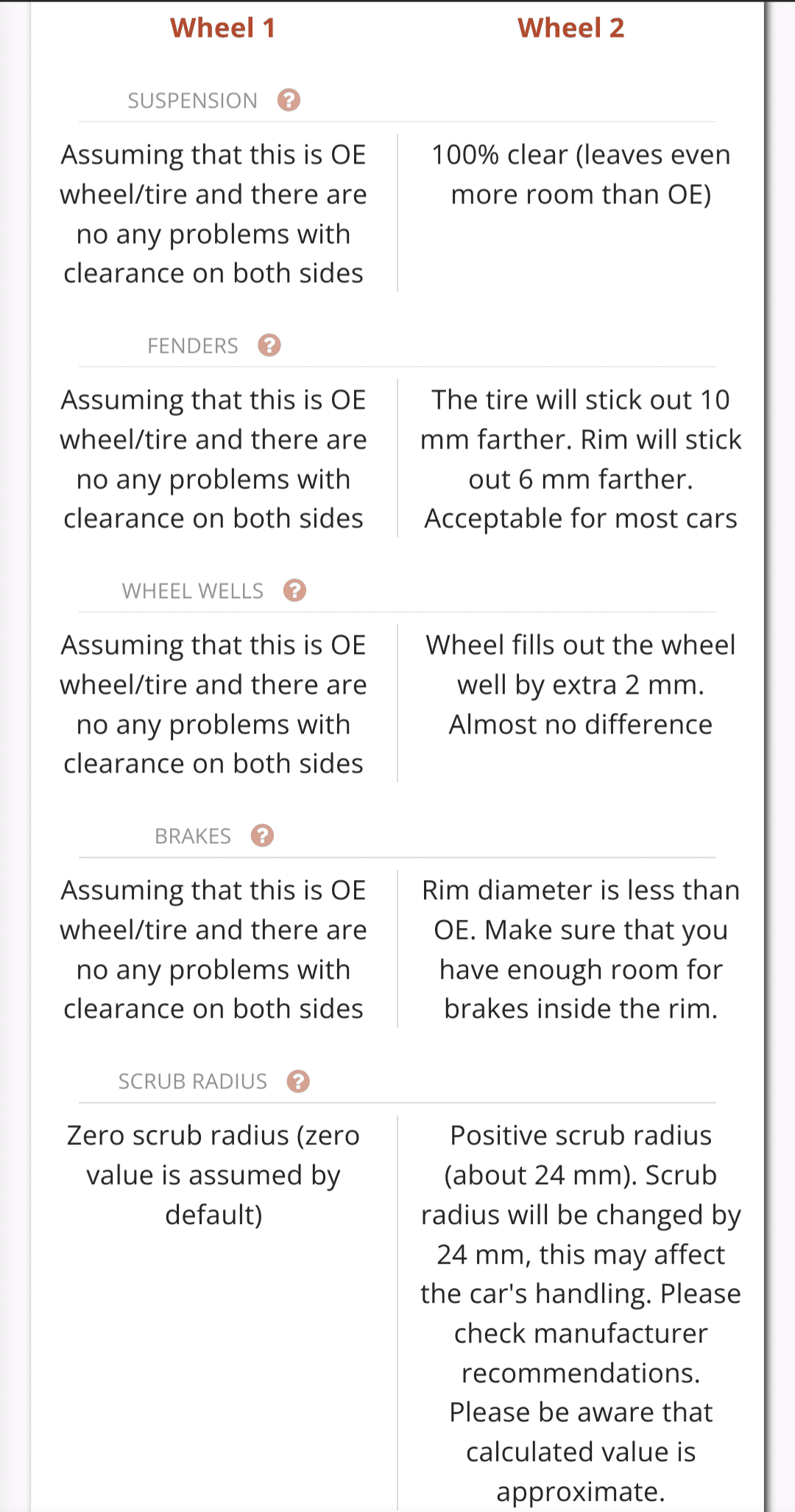

Finally looking at 18x8.5 wheels with a +35 offset and 235/40-18 winter tires.
From what i understand, these wheels would be a little more tucked in than the OE wheels. Am I right?

Which site did you use? This is really cool... As I understand, I should look for a offset higher than +35 if I want the winter wheel to be a little more inside the fenders.

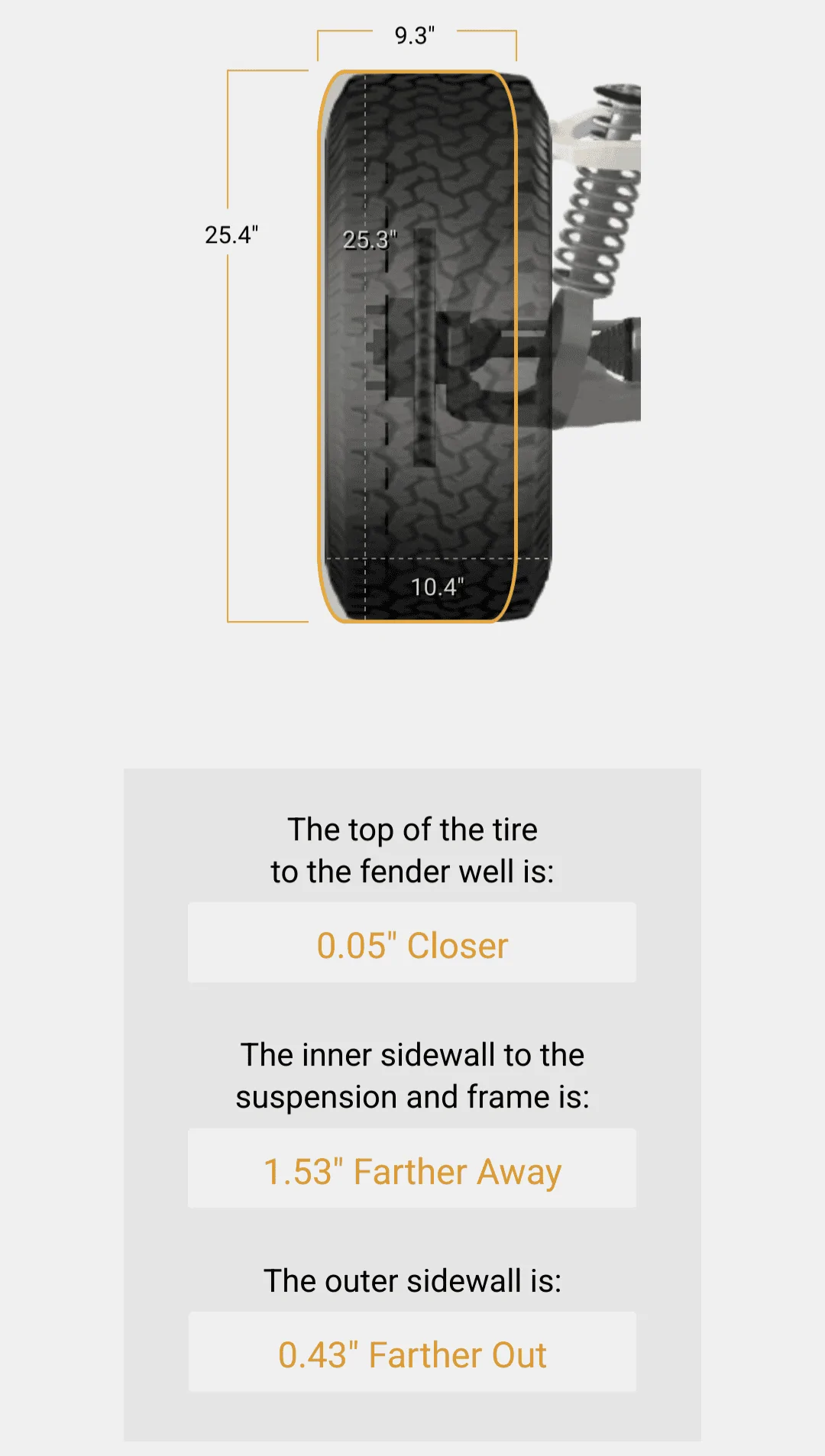

Tire size recommendations for an 18x10.5" wheel? I will be putting performance all seasons on these at first in Sept/Oct to get through the winter. Michelin or Conti's I think. Then I'll tear up the OEM tires next year before putting summer rated ones on the 18's. I won't drive it in the SNOW - just wet & dry winter temps. We don't see that much snow in the St Louis area & when we do, we'll just take the Durango or stay home - wife doesn't work & I work from home anyway, so that makes it a bit easier to decide & probably helps with options. I just figured Michelin Sport all seasons of some kind, but open to others from you who know more about these types of tires than myself. ? I know Jeep & truck tires well - gotta relearn this stuff.
295 Ratio 30,35,40
Normally it would be 295/35/18
1,480
1,201
295 Ratio 30,35,40
Aw shoot - Alexandre in the FB chat suggested around 275-35-18 @ ET 47, which these wheels are. I should've provided more specs.
So maybe 295, 30 thru 40 be a better fit.
