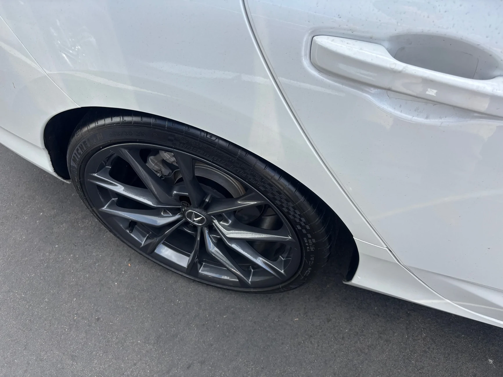

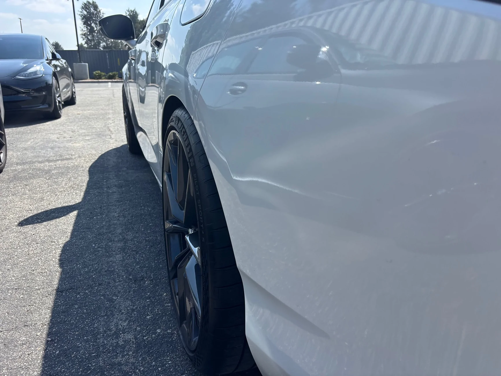

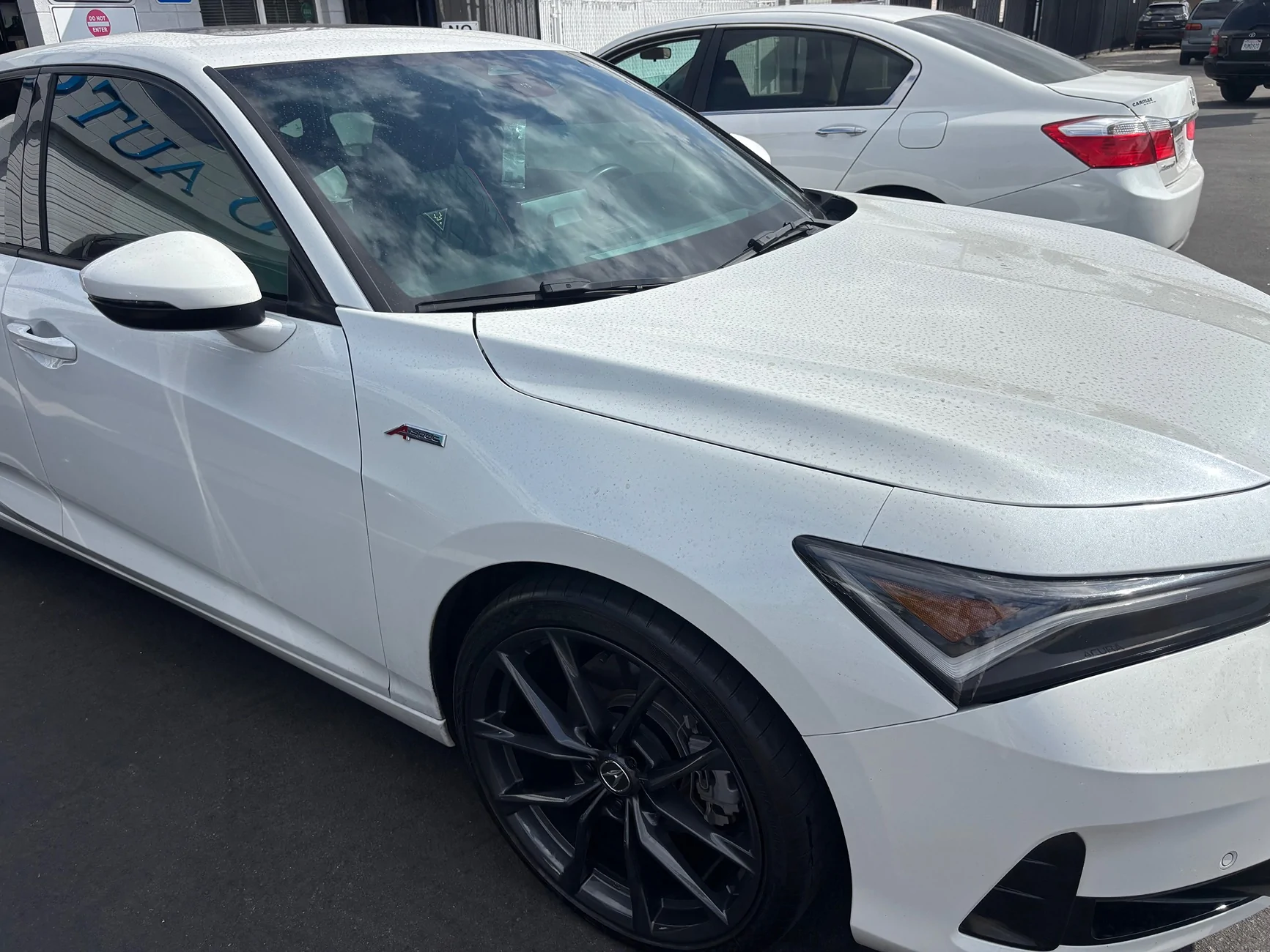

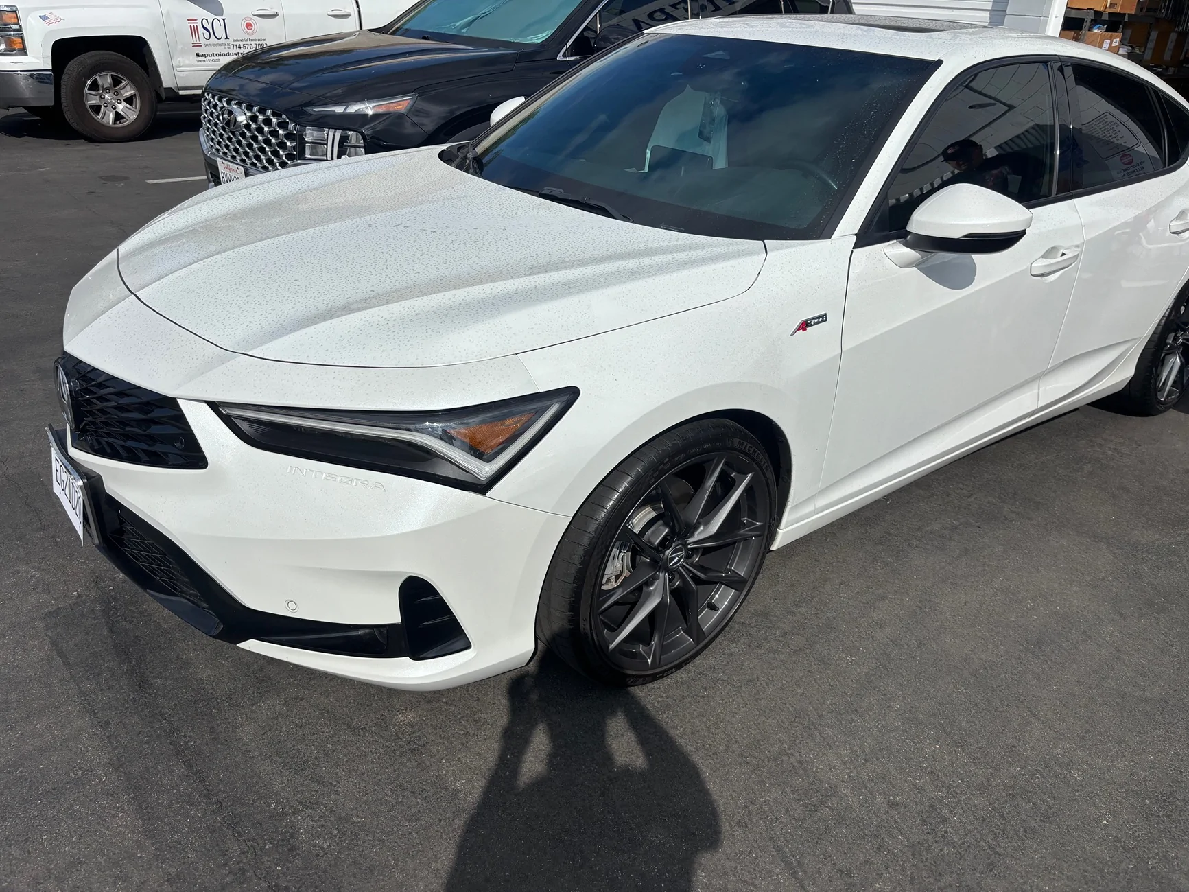

Finished installing integra type S wheels
No rub no problems
- Perrin 20mm adapter 5x114 to 5x120
- lugs 14 x 1.5 oem
