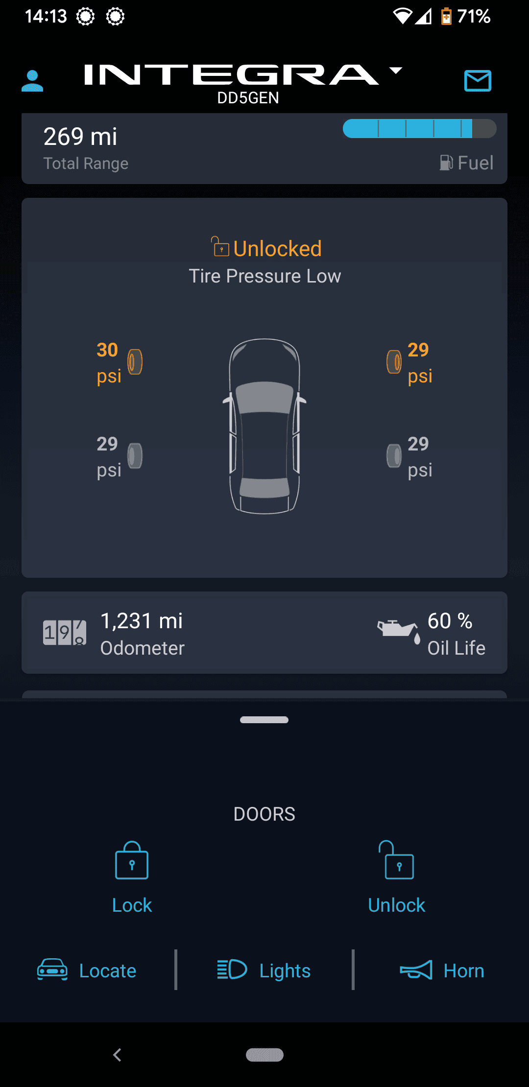

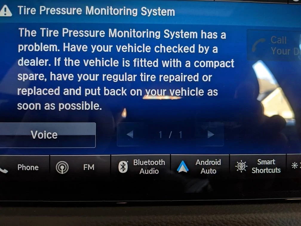

I could have sworn this came up in another thread here, but I can't find it. I'll link to it if I end up finding another thread, but we had a very cold night recently in central NC, down in the 20's F, and this baby showed up. On the AcuraLink app it is telling me front and rear are all at 29psi, but the fronts are erroring. Anyone else see this?

IIRC at least for A-Spec, spec is 35 psi front, 33 psi rear so you’re getting that because the fronts are past whatever tolerance it has and the rears are not

Normal behavior with the colder weather. Fill them up to spec, with the porosity of tires you will be fine by the time temperatures warm back up.
